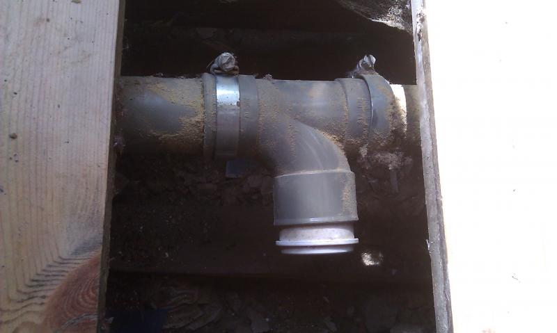

I don't like to make a habit of criticising the work of others, but this one really takes the biscuit:
Only a small drip when the bath was emptied...the irritating thing is that the perpetrator did not consider the fact that the rigidity of the plastic fitting will have prevented the jubilee clips from having any effect in compressing the fitting onto the pipe in a watertight manner.
