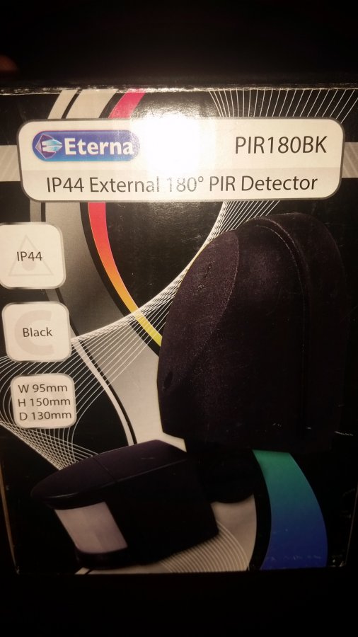

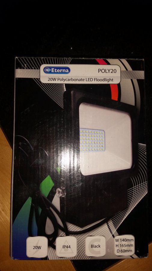

Just had 2 20w LED PIR lights fitted
The Electrician took supply from ring main via a fused spur
Problem is that when ever we use any appliance on the ring ie an iron that draws some current
the lights come on outside
Is there anything we can do

I take it you have a separate PIR then? The Poly20 doesn't have one built in (that's the Poly20PIR). What is the model of PIR?
