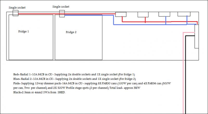

I've looked in too this before but never go round to it. I have a quick Q on the electrics.
The pic i have attached is how i was going to do it.
The max load i have is 20A- So it might just be enough for what i want to run.
Should i have Two small radials as in the pic for should it just be 1 hole radial? the loads on the sockets will be quite small, things like chargers (laptop and ipods etc etc) and an amplifier will be used, along with 2 fridges the plan was two put one on each radial so if the MCB trips on say radial 1 he drinks will still be cold on radial 2.
The other thing is the lighting load will be approx 3KW +20% if we decide to flash them.
EDIT- I plan to use 8X PAR 16 nows and they are only 50W GU10 bulbs per can, i forgot to mention there will also be a 1.3KW Patio heater + 2x 360W tube storage heaters for the winter.
It may be better to run a submain in SWA to a small weatherproof DB at the bar containing RCBOs. The submain can be fed from a non-RCD way in the house, or via Henleys and a switchfuse if that's more appropriate.

I never though of that. It might be an idea. It would have to be Henleys we have run out of ways in our CU. :( .
The question was really two radials or one, suppose that is quite basic. I have good knowledge to do this correctly though.

WRT the radial circuits, you will obviously be better off with two in terms of redundancy. Personally, as you're starting from scratch, I'd install one radial circuit for each fridge, and then another for general use sockets.
I did think that but i thought it might be over kill on the CU. Don't really want to make it OTT.
Jake
Why 10A radials?
What on earth is the point of such small ratings, and what will you do if (as is quite possible) the start-up surges on the compressors are enough to trip 10A breakers?

I suppose I can understand how this arose. Separate circuits for the two fridges obviously means that both are not lost as a result of one MCB operating (which one could argue was called for by 314.1) but, even with 10A circuits, this takes the total load to 36A (10+10+16) - only just within the capabilities of 4mm² SWA, and way beyond 2.5mm² SWA (the pic says "2.5mm² or 4mm² SWA"). I doubt whether the intention was to wire the radials with anything smaller than 2.5mm², so I doubt that is the limiting factor.
If one wanted to stick with two radials (for 'division into circuits'), then I guess the better approach would be to use larger SWA (probably 10mm² - maybe squeeze through with 6mm²) and have 16A or 20A radials. I certainly would not think that 10A radials would be a good idea. I somehow doubt that the theoretical possibility (mentioned by BAS) of the start-up current of a fridge compressor operating a 10A MCB would be a significant risk in practice, but I would say that it's probably bad design to ever have only 10A protection for a circuit which has several 13A socket outlets. Using larger SWA would obvioulsy also facilitate a 32A ring, but that would not provide any 'division' (if one felt the need for it).

I did lower the rating of the lighting so it will no longer be a 16A trip it will be a 6A decided to not bother with the other PAR cans so the 6A will only be supplying the PAR 16s total lighting load now 400W. (Sorry if this is a bit confusing)
The problem is i only have 20A to play with, decided not to pull and extra supply from the CU it will just cost more and will mean a lot of concrete to be dug up. Don't really want big, thick SWA to be seen.
Yes the radials were going to be done with 2.5mm2 T&E in conduct.
Would a fridge eat 13A in surges? If it does i might have to go the bigger thicker cable route. 10mm i guess if i do. The more power would help.
Could i get away with the two on a 20A circuit? these are the small under counter ones.
OK, so as I understand it, you now want a 6A lighting circuit, plus the power; is that right?
The problem is i only have 20A to play with, decided not to pull and extra supply from the CU it will just cost more and will mean a lot of concrete to be dug up. Don't really want big, thick SWA to be seen...Yes the radials were going to be done with 2.5mm2 T&E in conduct....
I'm not totally clear as to what is this 20A that you 'have to play with', or what concrete digging you want to avoid. Are you now saying that you don't intend to bury the SWA?
2.5mm² SWA would take 29A buried and about the same not buried. That would allow you your 6A of lighting plus two 10A radials or one 20A radial, but the total would obviously then be 26A (more than your '20A'). The lighting plus one 16A radial would only, at 22A, be only just over your 20A (per MCB ratings) - but it sounds as if your lighting will now actually be well below 6A demand in practice, so the total actual demand would undoubtedly be well under 20A.
As I said before, I frankly very much doubt that a fridge compressor start-up would trip a 10A MCB, and I honestly doubt that even two would (if they happened to start simultaneously), either. I would therefore personally think that to have both fridges on one 16A or 20A radial (either of which could be wired in 2.5mm² T&E) would be fine - although it obviously would mean that if the MCB did ever trip, you'd lose both of them.
From what you said initially, it doesn't sound as if you want/need much other power, so I would personally think that a single 16A or 20A radial for everything (both fridges, plus the rest) would probably be fine.

They where but i'm now thinking differently, if the fridges eat more than i thought they did.
Would you suggest singles??
I have noticed that is standard.
Even 10mm² is only about 4mm bigger in diameter than 4mm², but do you need that much capacity?
Could you draw enough from the shed CU to justify 10mm²?
Best to let your electrician start with a clean sheet...
I dont really need the capacity of 10mm for this (this is final on what i'm having)
2X fridges
2x tubular storage heaters
8X 50W Light fitting
and a amplifier.
Yes correct.
Sorry, The 20A is from the shed, the concrete digging i was trying to avoid is from the main CU (in the house) the bar will be build on the back of the shed so it's soil and it will have a PLY floor so the SWA can be put buried under that.
The SWA will be buried for about 2-3m long and then brought in between the shed and fence and then under the slats that hold the shed up and then though a hole in the floor the it's CU.
The lighting is 1.66 amps. Arrrr good, under 20A would be very helpful.
I did think that they are only fitted with 1mm flex if i remember rightly.
Suppose it would only be quite rare for one to trip, unless there a fault of course.
I should have prefaced all this by pointing out that I'm not a professional electrician, so I add that as a 'postface' instead
A single radial would be easier, but then that's for the sparky to decide. he will probably thing the same.
