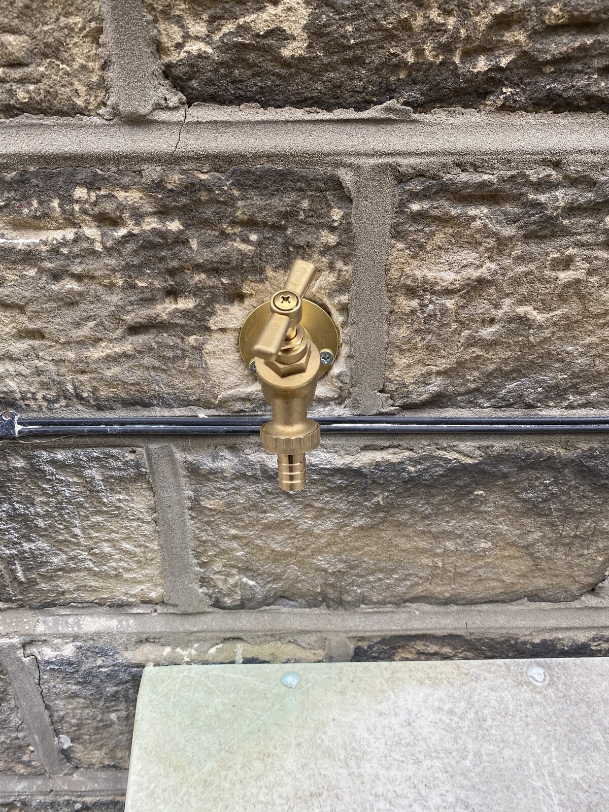

Hello everyone.
I have just had an outside tap fitted by a plumber.
I have a conservatory in from off the kitchen so he couldn’t put one there. as I have a boiler that leads to an outside wall he said he could put it there. Several other also said the same.

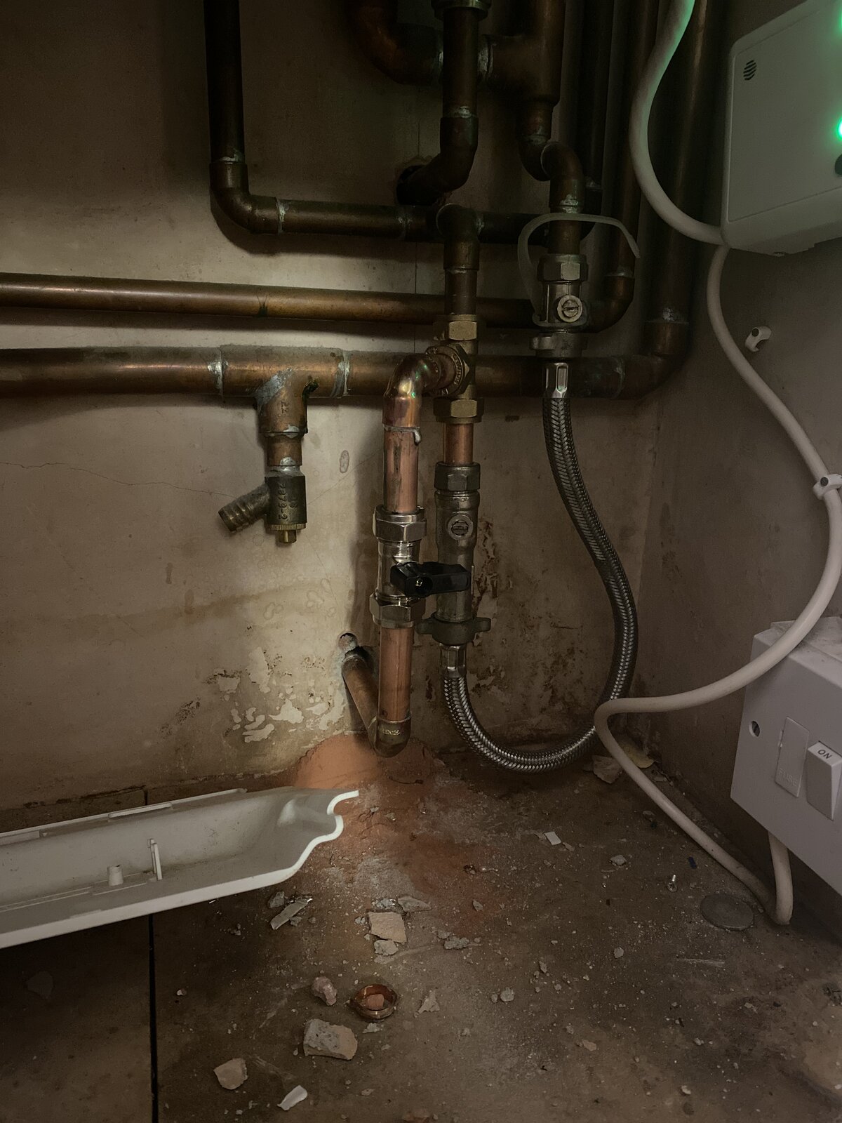

anyway he’s don’t the job and I said a good few times I want a double check valve he seems to have done a good job but has not fitted a double check valve inside the house. he said the valve is in the tap outside side. Also I read that it should be inside. I can’t find anything by the water regulations so don’t want to call him back if it’s not true. He’s gone straight out from the boiler mains pipe to outside.
Also there is no insulation on the pipe inside the wall bit. Does it need it?
Also I paid £80 other quotes were cheaper but I wanted to pay more to have a better job done. This was a New install of a tap. I wanted a proper job done that complies with water regs
Please help.

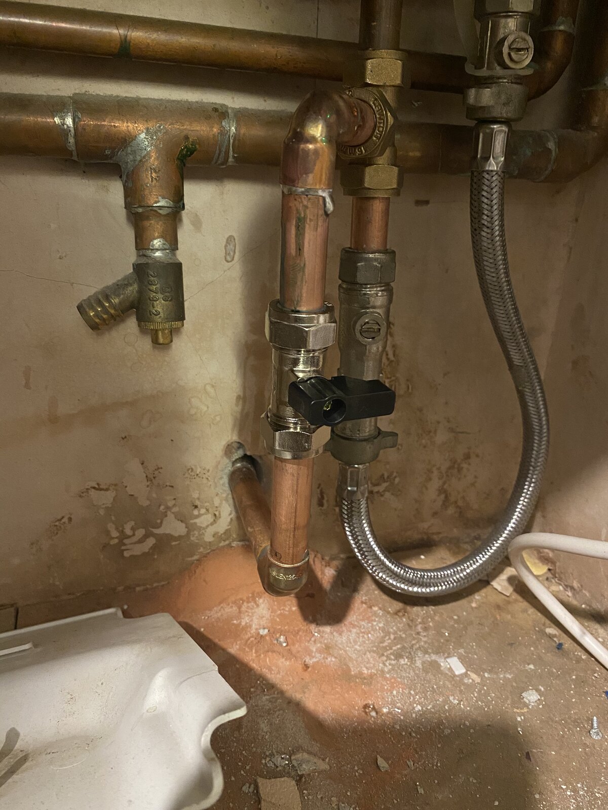

I have already has this tap fitted but the check valve is not inside the house. That’s the tap he seems to have fitted outside. My understanding was that new instal taps must have a check Valve inside the house
As far as I am aware, the tap with check valves obeys current legislation.....do wait until the ‘proper’ plumbers come along though!
Do protect the new tap against frost, of course.
John :)

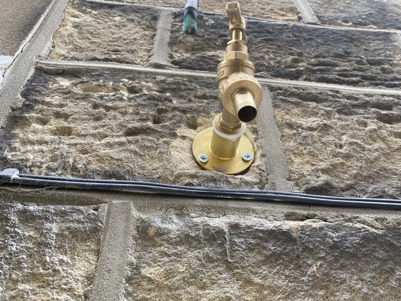

Post a picture of the tap looking from underneath. Was the hole that was drill 'sleeved' with a bigger pipe?
I think £80 was a cheap price.
Andy
Andy

There was no sleeve i just saw him put a long copper pipe in
The photo below with the black isolation valve is what he’s put. That’s new connection

That looks like a standard bibcock to me....I thought the check valved taps had a screw in the bottom to hold the valve in place?
John :)
That is correct. Replacement taps can have a check valve in the tap, for new installations the check valve must be inside.
So this is incorrectly installed ? Does it require anything extra on the copper pipe running through the wall?
see image here
https://www.screwfix.com/p/outside-...QQ91n4bBoND52RvoDEhoCz3cQAvD_BwE&gclsrc=aw.ds
notice on bottom the screwfix one is different to yours
and at toolstation
https://www.toolstation.com/search?q=outside tap double check
