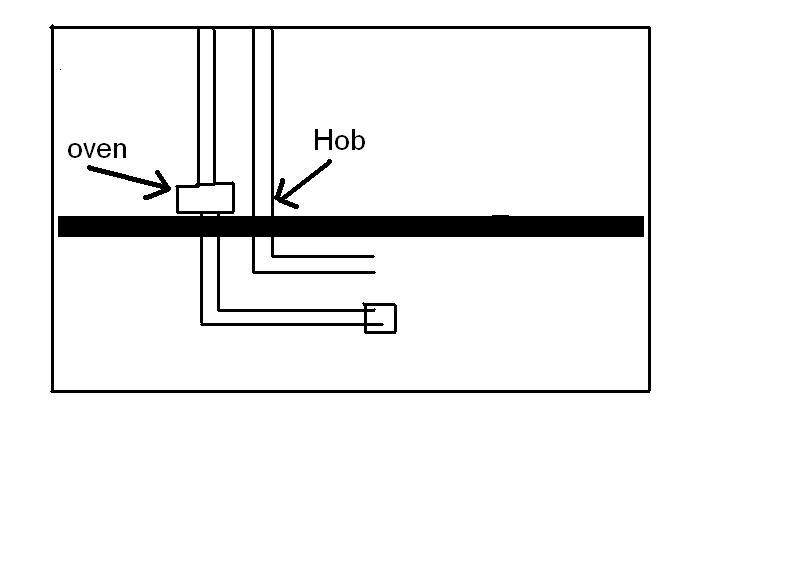

Hello – My electrician has run two 6mm wires for where my oven and Hob will be. One goes to cooker switch and then to Oven. The other is just coming straight down wall and then over to where Hob will be. Does this not need a switch?
could be wrong, but isnt the hob cable outside of a safe zone?
it has a bend in it which doesnt align with any other accessory.
