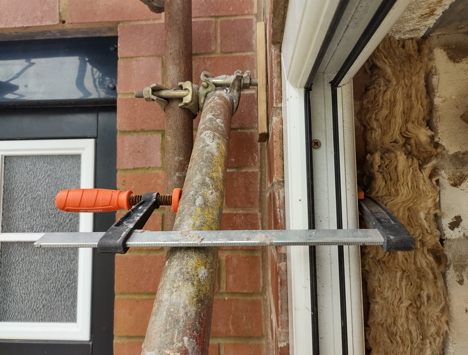

I got some Aldi ones for £2 from the clearance bucket which have been ok. If you need something a bit better I would recommend these:
I'm not sure what they're called but it's stopped my scaffolding wobbling quite well.
I've got 4 of those, calling them one-handed is a bit naughty cos they can be a pain to set one-handed but they do clamp very very well.
