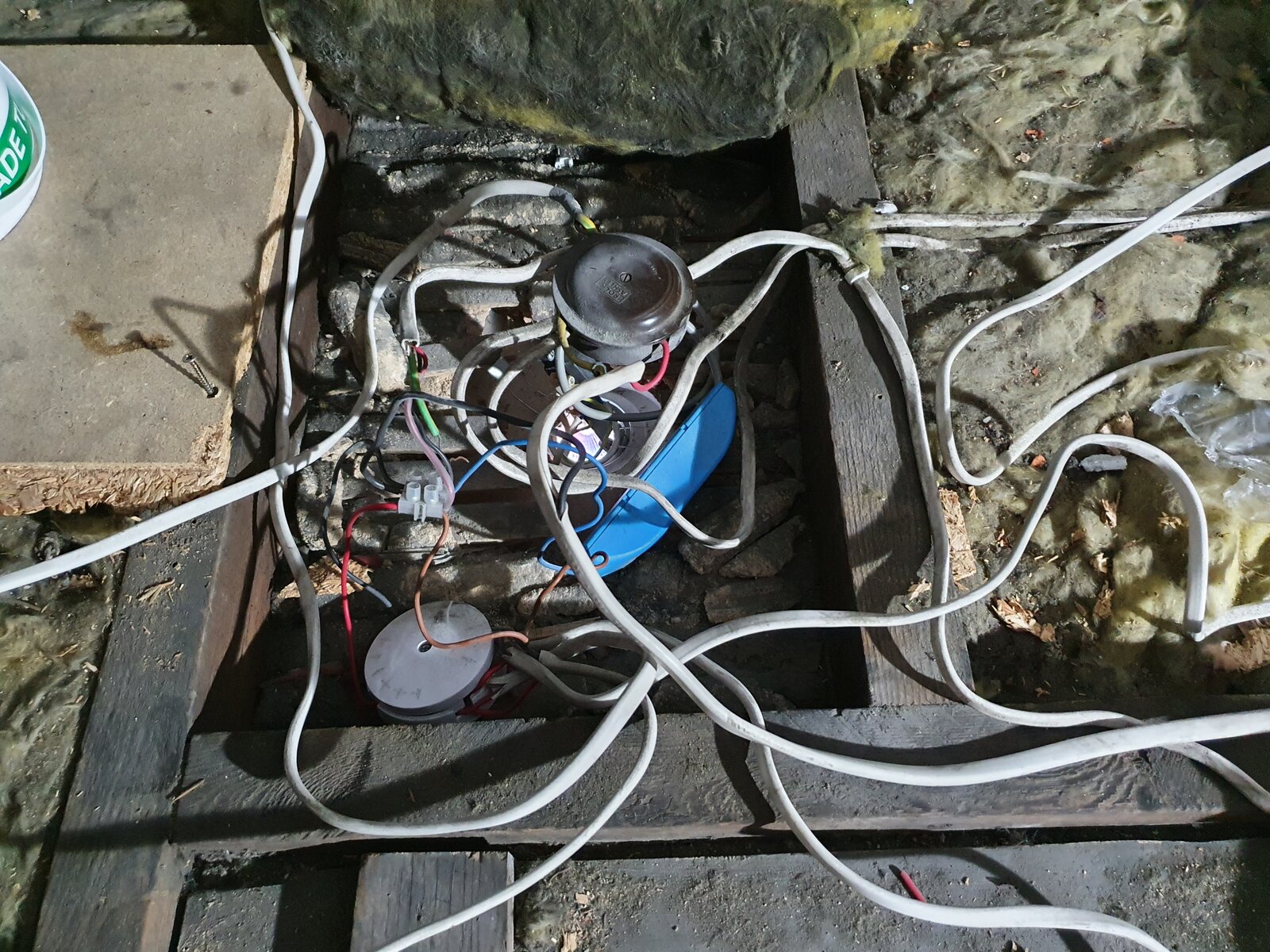

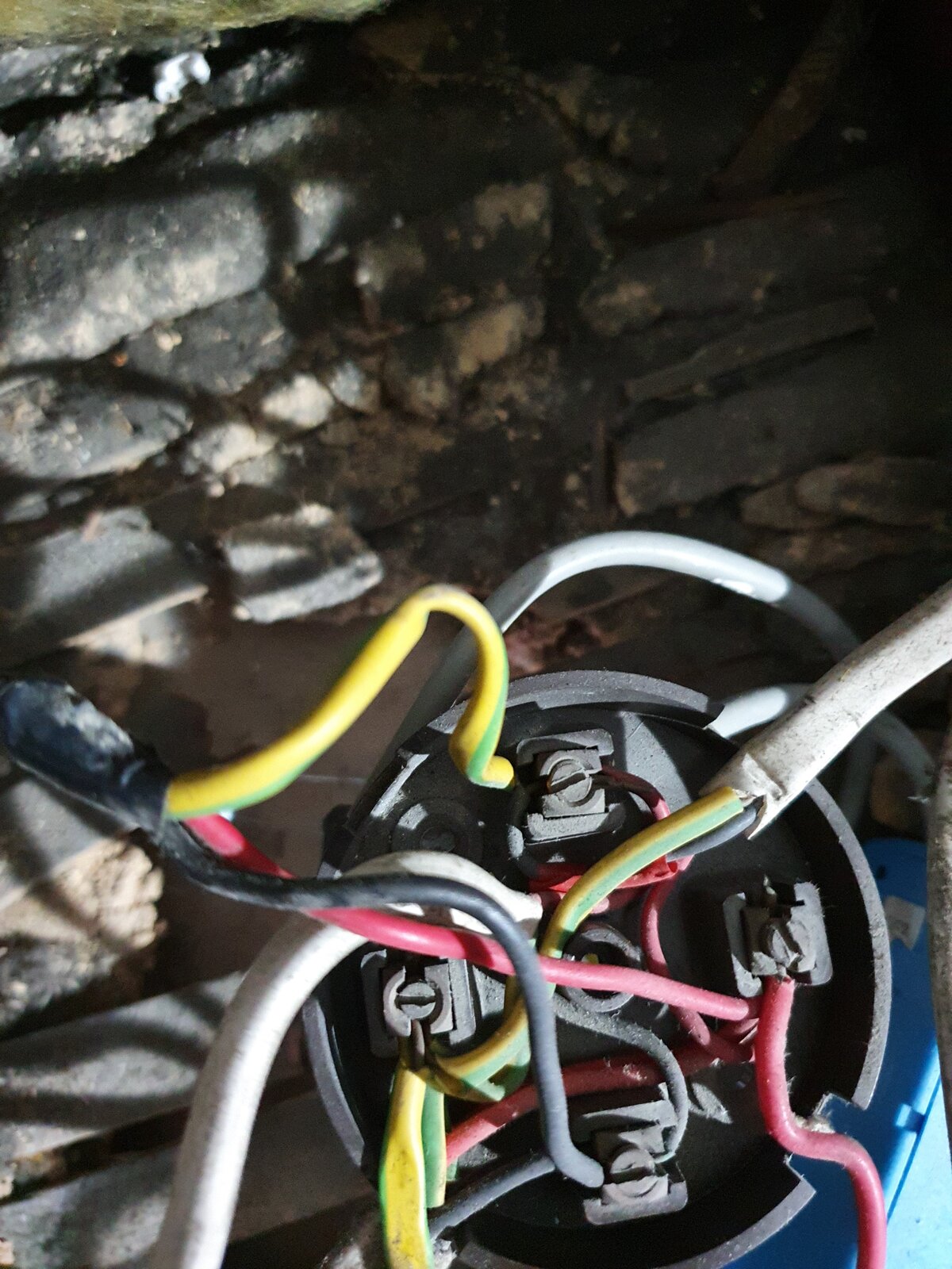

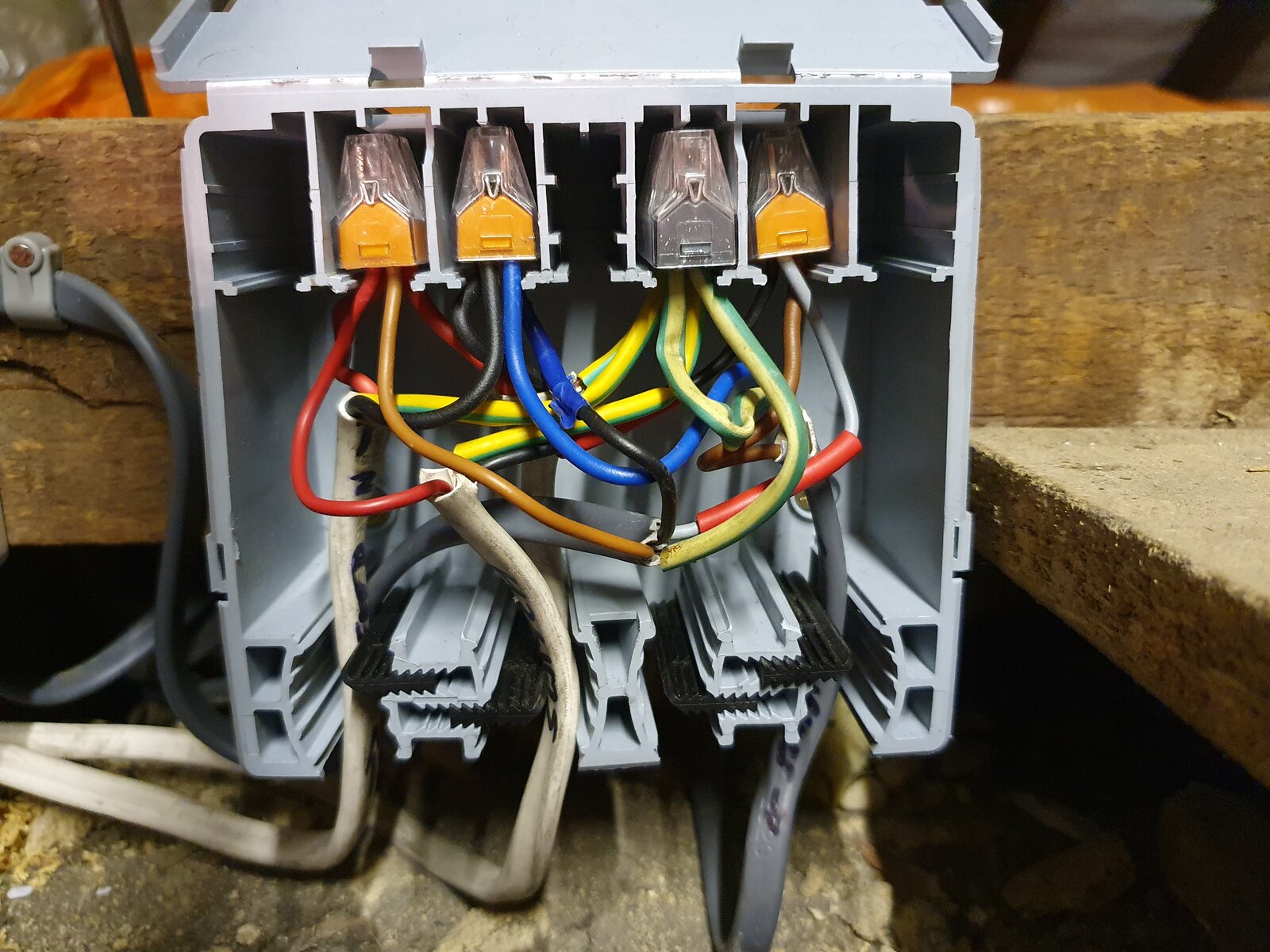

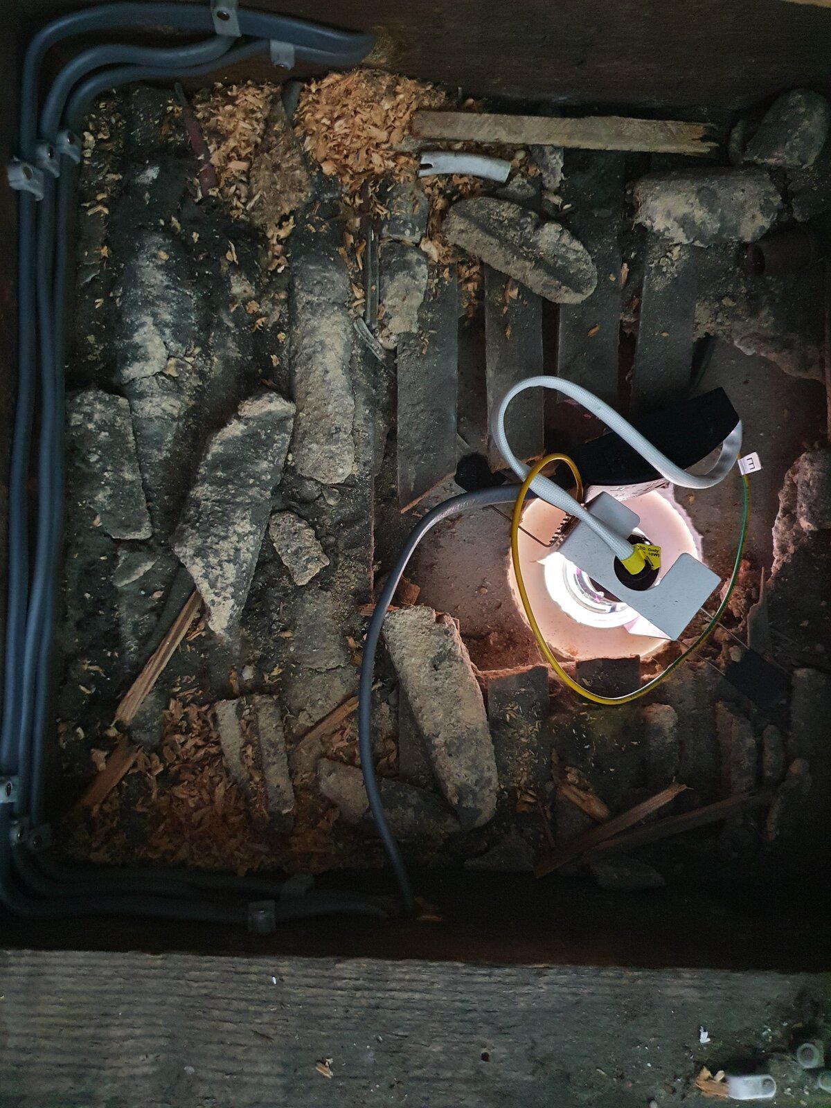

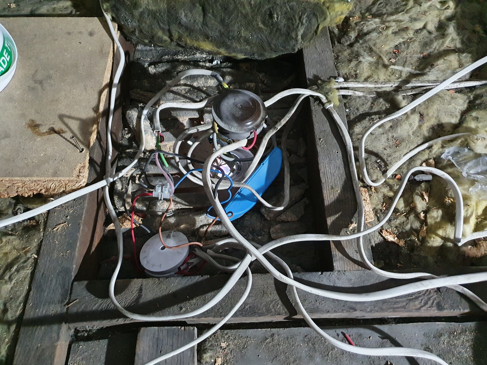

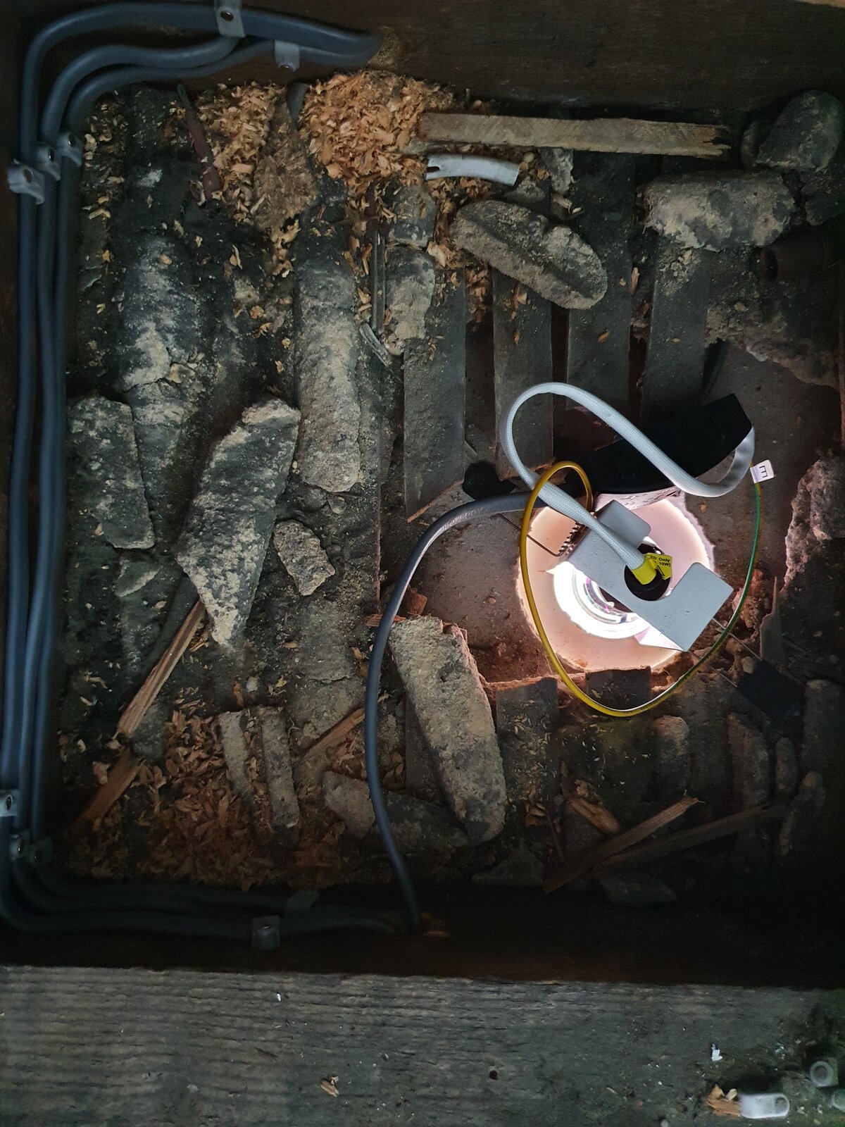

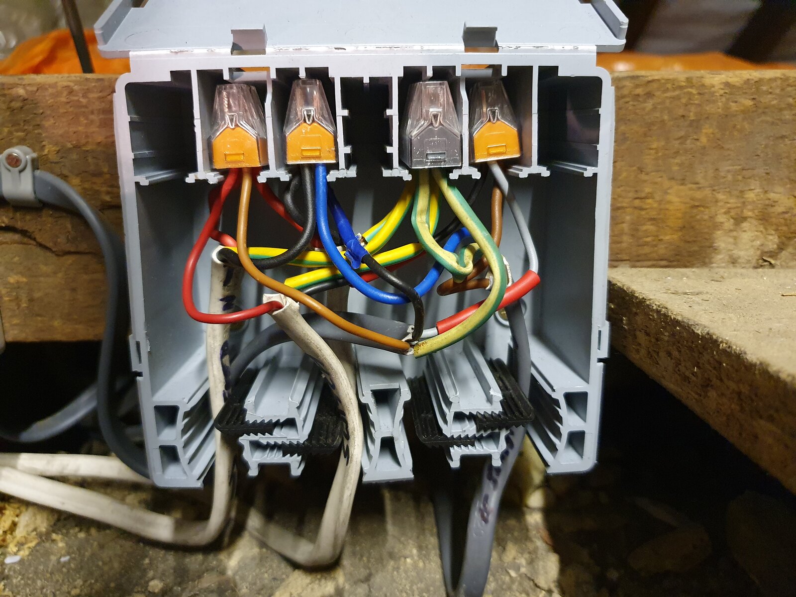

Eg, last week my parents said their bathroom lights kept blowing. I took a look, lifted loft boards up and (ok, I'm no electrician) it looked AWFUL . For a 6yr old install, they certainly weren't ip*4 rated lights, boards were screwed down compressing cables, and one screw at an angle had pierced a t&e (which turns out supplied a shaving point that they noticed was faulty a couple of years ago, called an engineer and he couldn't find issue and suggested a re-wire)
An example of a bathroom fitter who had dropped the ceiling and hashed the wiring. I'll try and work.out how to post a picture. An earth was used as a switch live for extractor (perhaps this is norm?), Connector blocks everywhere, and about 3 jbs interlinking all over the shop. The 'switched earth' wasn't even connected in the fan.
Anyway, my point being I want to be knowledgeable so I can take on these tasks. I did tidy it all up for them and install new downlights, but of course, in the back of my mind, I wanted the peace of mind of being taught all the ins and outs. I know it's not a case of copying wiring diagrams.
Attached a few photos, 2 before, 2 after.
Assuming I am correctly thinking which are the after ones :) then that certainly is an improvement and shows you must understand how it works.
Bare CPCs should not be used as live conductors.
Why thank you ☺️. When I extended and rebuilt 75% of my bungalow (completely gutted and all new joists / roof/ electrics/plumbing/drainage), I took 2 yrs out of work as a project. I was lucky to have some great trade recommendations that allowed me to buddy up with them and be hands on. Including a fantastic spark with whom we completed the entire rewire and cu together. I got a good understanding of switching, rings and radials. Of course just one install isn't enough to prepare me for the world of domestic electrics which is why I want to further my knowledge. IE. I haven't any experience on testing circuits.
