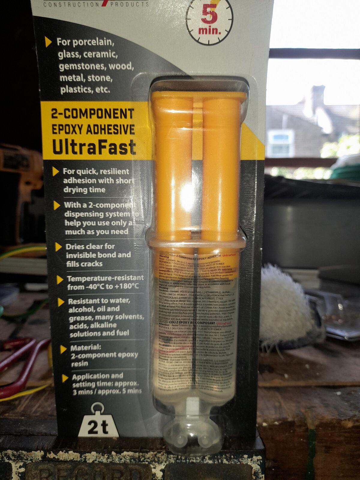

Ive got this stuff in the shed. Says OK up to 180 degrees, warerproof and good for plastics.

Mmm, l like your lateral thinking Nozzle.
Trouble is I don't want to obscure the water/air/fat pathway. If I could get some threaded plugs with a thread 5mm wide and no more than 2 or 3 mm deep that may work

Yes that's the fella, pretty easy to use. It's 100% waterproof and should bond well with plastic. Just cut out a bit of the sheet just bigger than the holes and paint over it with the resin, repeat until there's a few layers.
