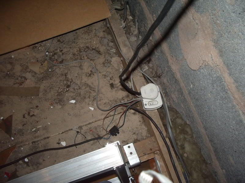

How not to wire your loft light

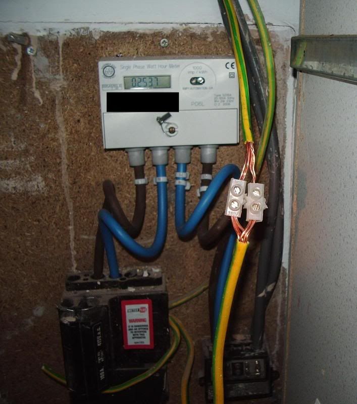

How not to joint main bonding
:shock: :shock:
Whats going on with the earth under the fuse carrier it dissapears into the backbaord?
YIKES!!! Who ever is responsible for the above pics needs a good clobber on his head!!
Edit: His/Her head!!
Whats the story behind these then? What kind of wire is that in the MK plug top? Love those vintage MK items :lol: When were those sockets last produced? :)
Looks like either old rubber cable or festoon cable.
Those sockets are probably mid-late sixties at the latest?
The socket is fed in a mix of flex innards, and pvc/pvc singles. lead from the plugtop is some sort of old rubber flex
