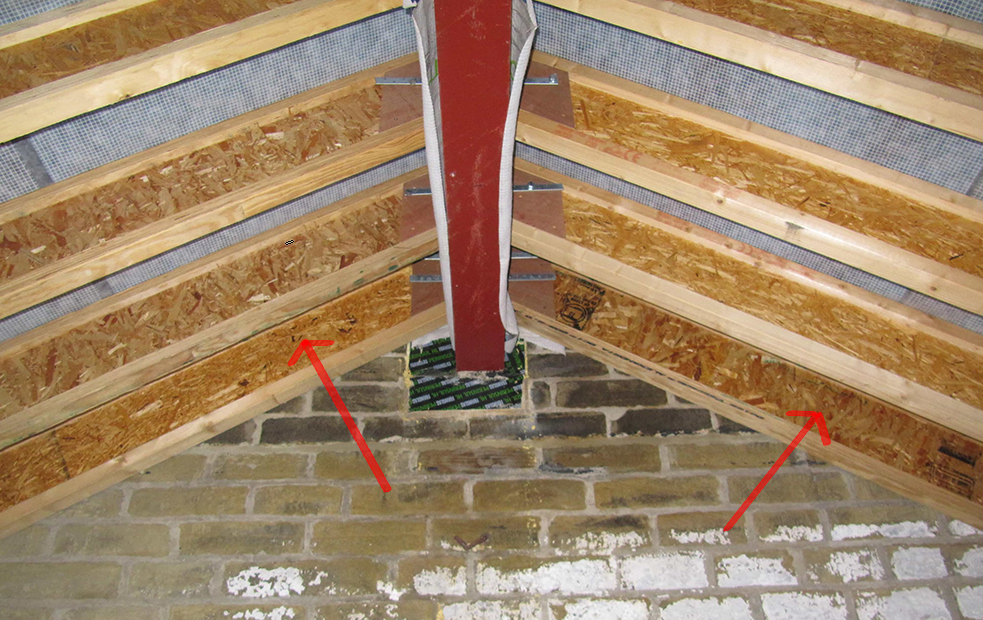

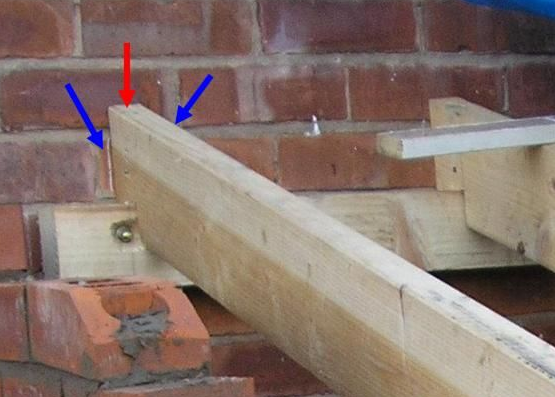

Ah ok let me try and explain. So I understand pitched roofs use horizontal wall plates bolted to the wall as seen below (ignore the colourful arrows)
But for a Gable roof, are the rafters closest to the wall bolted into the wall similar to wall plates?
I was also curious how the Ridge Beam would be fixed into the wall if it was wood and not a steel beam. Im presuming using joist hangers but I wasnt sure?
No the rafters are not fixed to the wall. Ridge Beam built into brickwork

As 23cv says, you'd build the ridge beam into the gable at each end and may or may not need padstones depending on load and density of your wall blocks.
