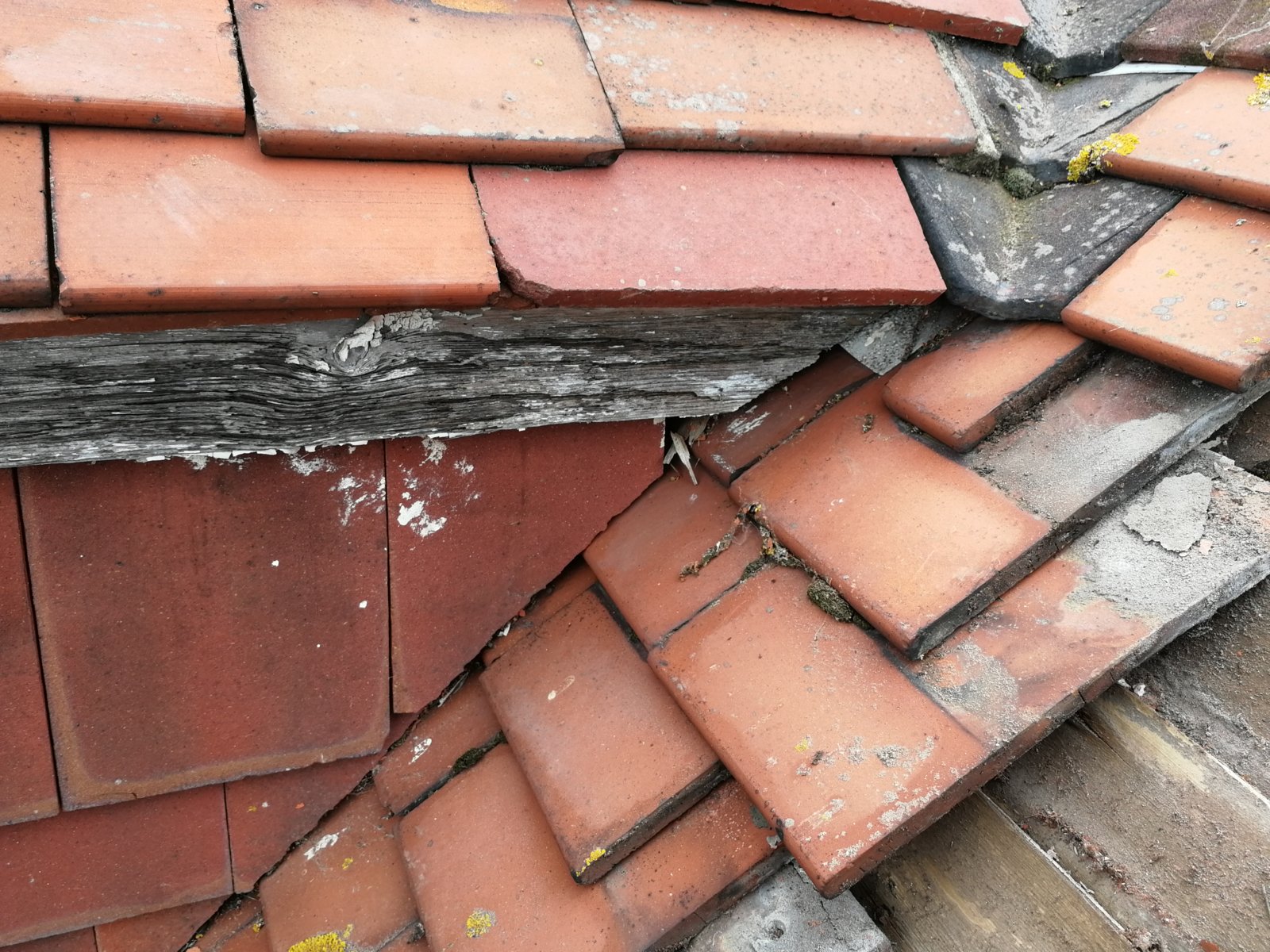

Hi,

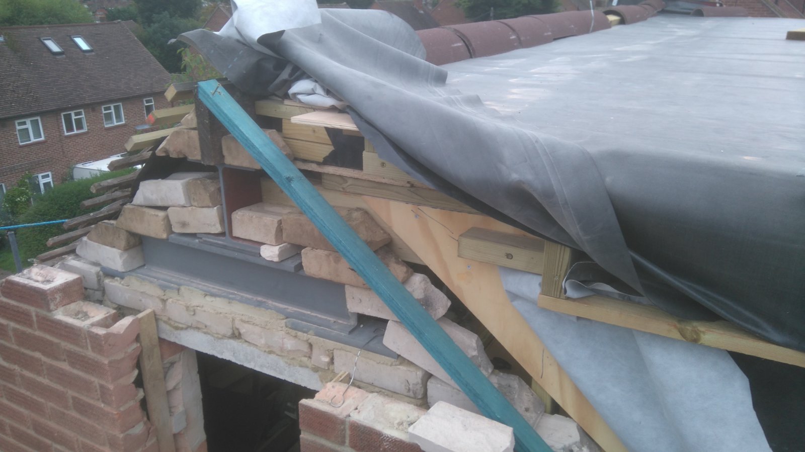

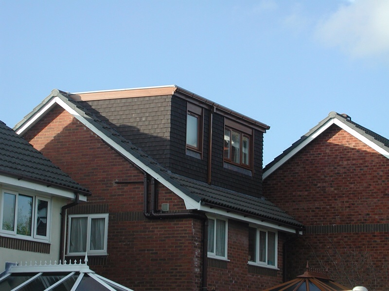

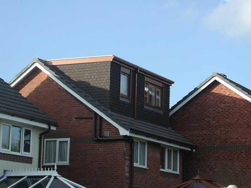

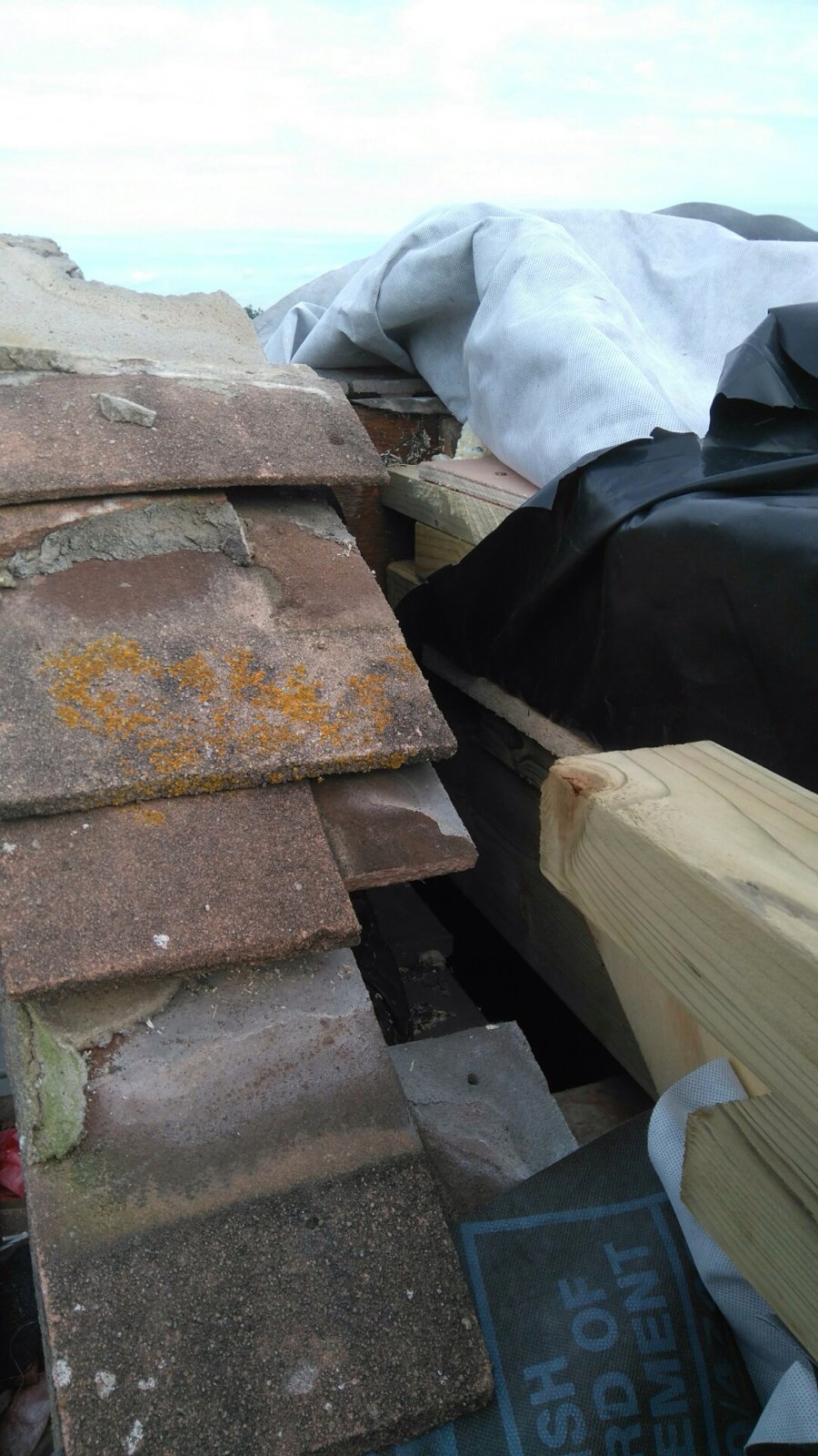

Can anyone show me an image of how the framing of the fascia and soffit should meet the pitched roof.
I've been told by neighbour builder that the fascia and soffit should go all the way into the roof and then lead all over that. Fact is there is an internal gable wall stopping that and it didn't sound convincing to me as he couldn't explain it...
I've also been told that the fascia and soffit finish 1inch short of the tiles of the pitched roof.
This sounds better but as the new roof is epdm it seems I am in a catch 22 as I can't secure the drip kerb without a fascia on but I can't put fascia on until I've tiled or finished the pitched roof.
A saddle was suggested by another posted but it's a 6m wide dormer up to the ridge tile.
Wher can I get this information of does anyone have images onto explain?
Image of house is not my dormer but shows the part I am trying to explain at the ridge/cheek/fascia junction
Other image of gable end tiles and ridge is where I'm at with mine except the fascia will come further in. Currently the soffit will be aprox 6 inches before counter battens and plain tiles
Thanks again.

The fascia on the dormer would be cut just short of a lead saddle which would have been fitted before or just after the fascia depending on when the roofer arrived. the fascia doesn't go into the roof.
The neighbour is a wonker
The fascia and soffit goes all the way into the roof in Scotland, a concealed lead gutter runs up the side of the dormer cheek before the cheek is clad... soffit and facing fitted and a lead saddle over the top.
I think we are talking about different detailing here! i keep forgetting sarking boards are rarely used south of the border making a concealed gutter as opposed to soakers impracticle.
Rarely, yes but not unheard of. Secret gutters are fairly common , Soakers are common which if fitted correctly work on a boarded roof just as they do on a battened roof.
The problem arises when soakers are located incorrectly.
We will be sticking with cutting fascia short with lead saddles and or soakers underneath .
Bowizi simply needs to finish his tiling up to the top of the flat roof dress a 450 x 450 lead saddle on each internal corner
fit fascia cut short of the saddle then drip batten then fit the epdm. The pictures don't show quite enough detail to mark up and repost

Today I removed the bedded verge tiles and hope that I can re do this with soakers when I get to that bit.

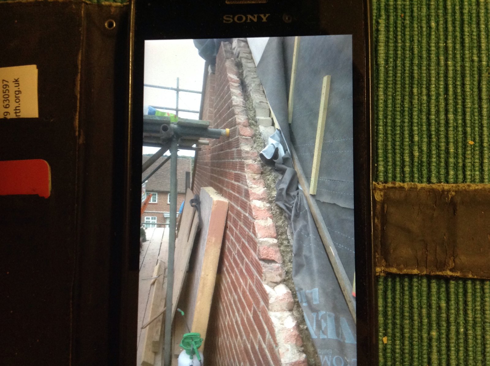

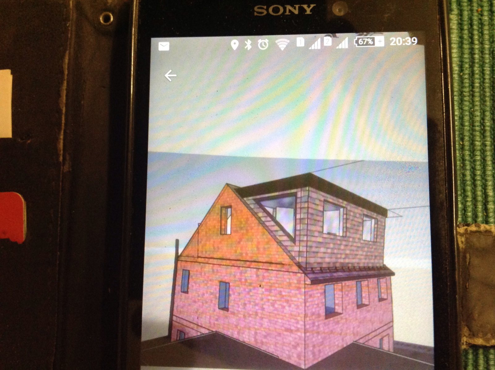

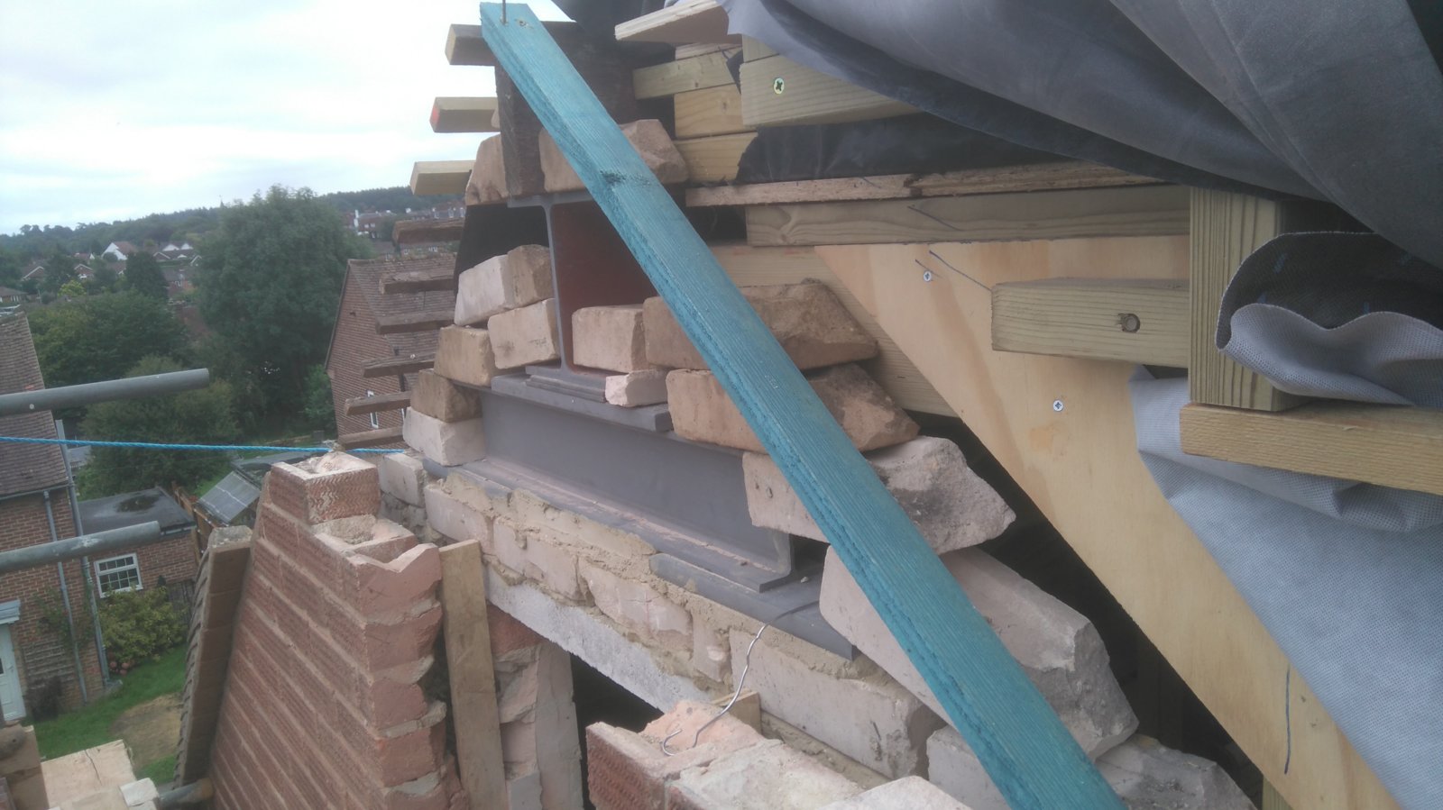

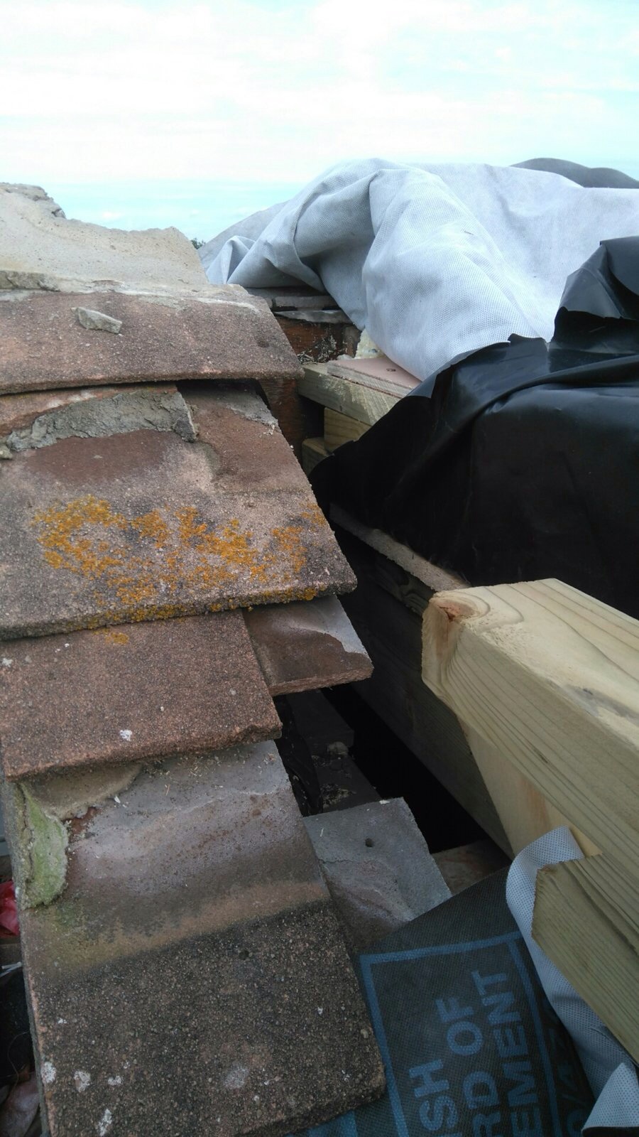

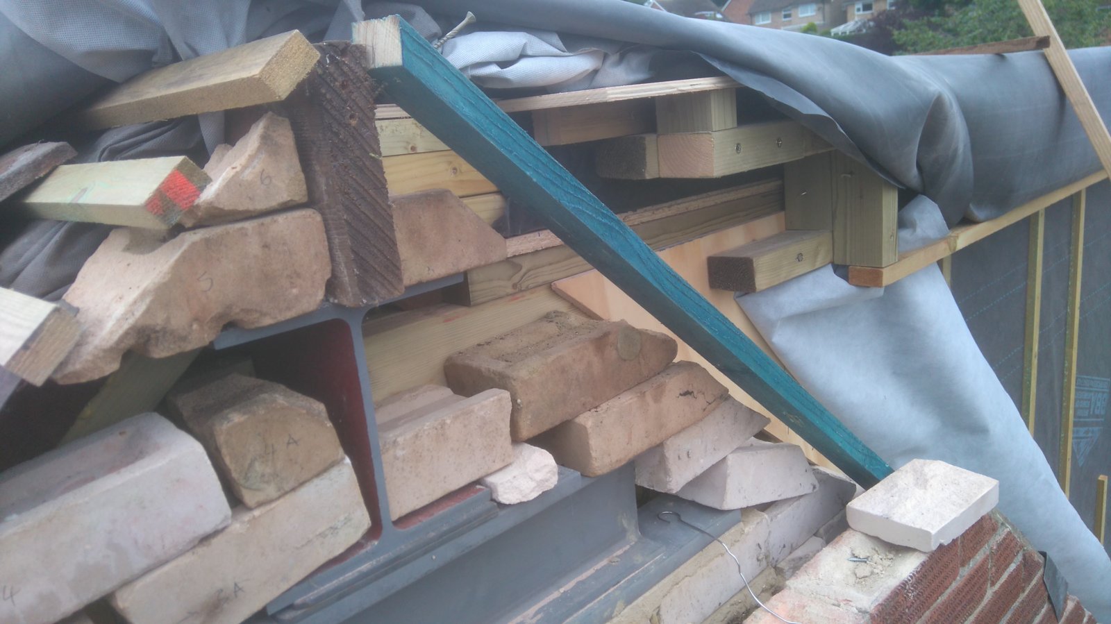

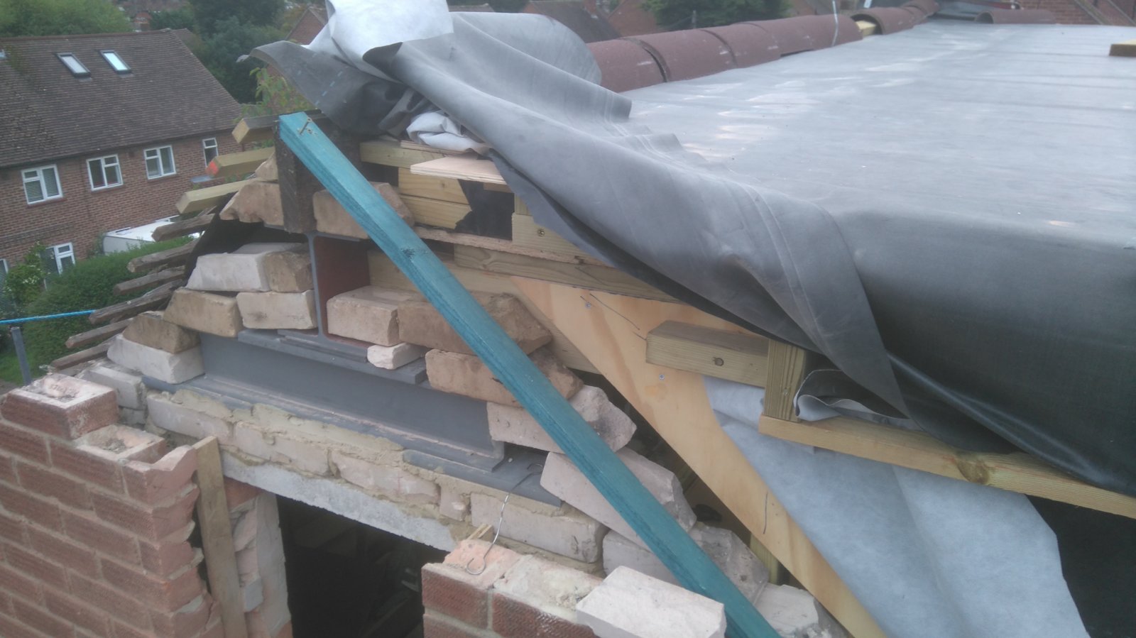

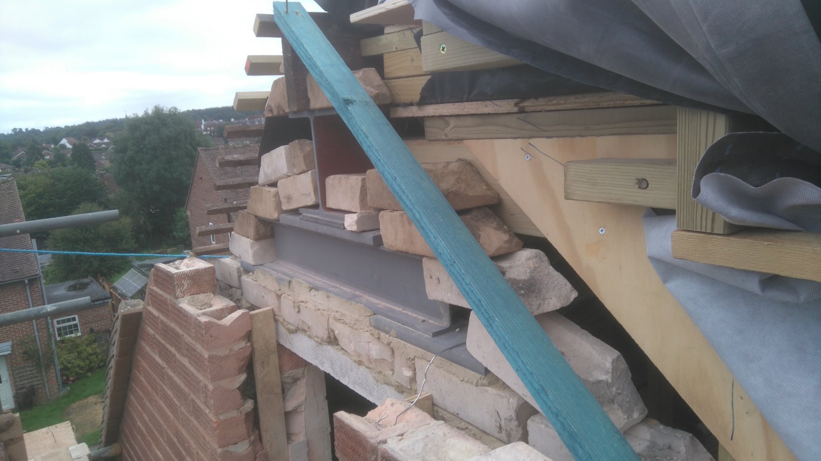

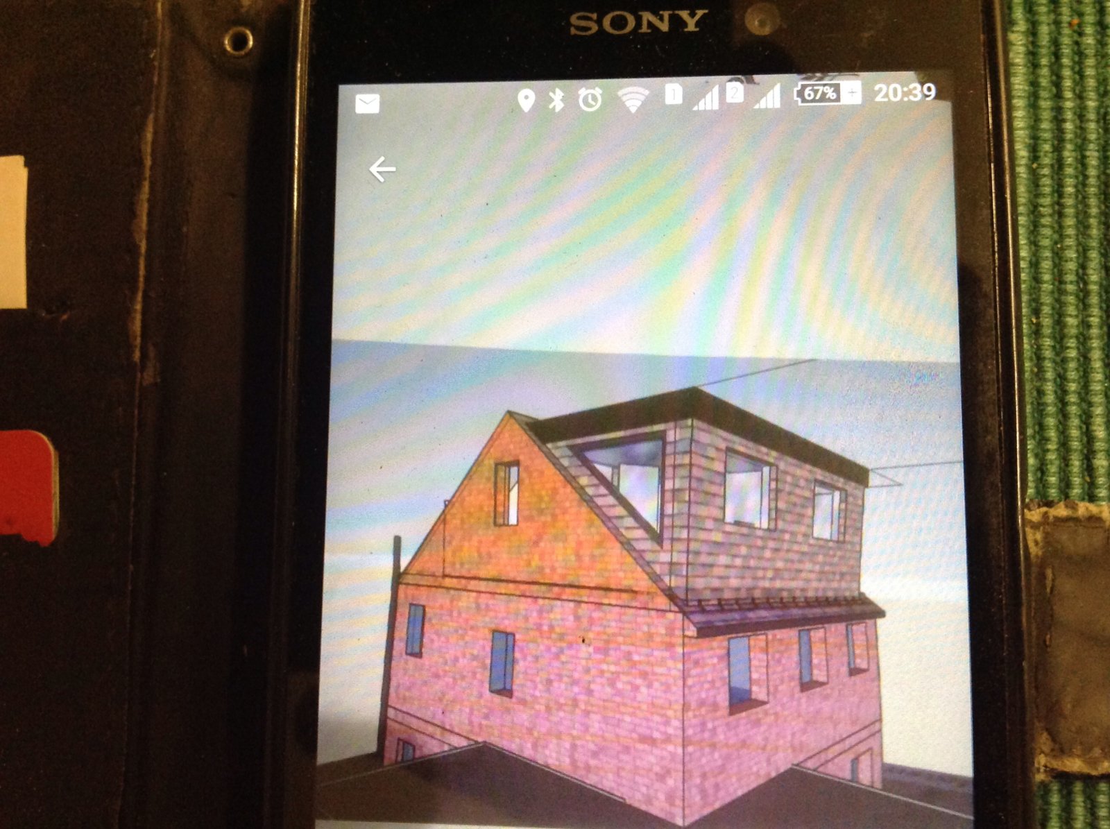

Because the new dormer cheek took out the gable side furthest rafter from the old pitched roof - (instead of doubling up the rafter I built up from new floor joist) - it gave me a problem of not being able to fix any battens on the cavity wall. Here is a picture of what am trying to build, ignore triangle window as not happening and was just a flight of fancy :-/
Also picture taken today of gable end but not up to the ridge I'm afraid.
If you can sketch anything roughly then I might get the picture as it were. :-)

screw some timber board to the brickwork.
think about how you are finishing your verges..

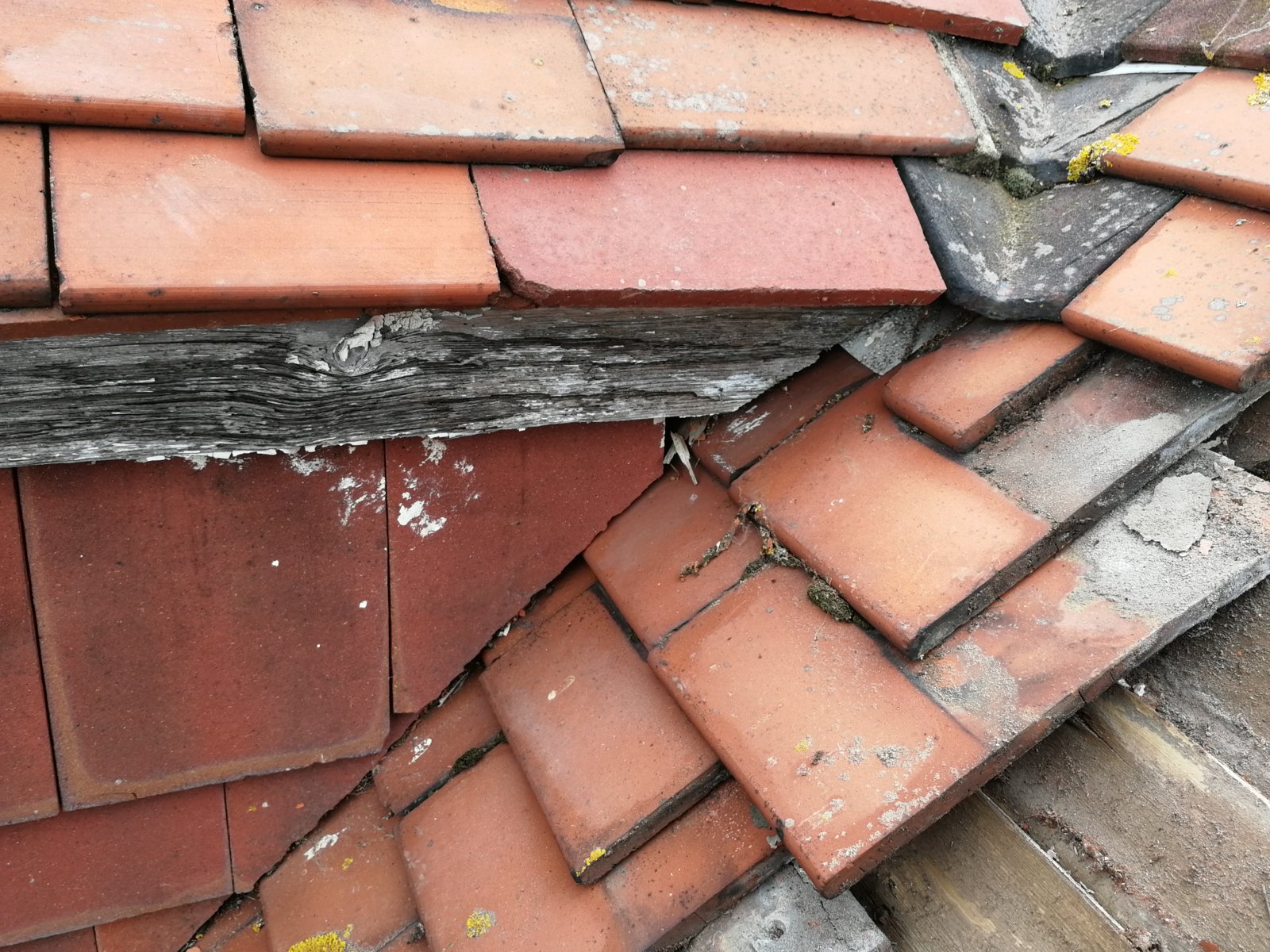

dorm123.jpg Here is one on a current roof strip . Ignore the fact that there is a valley to the dormer pitched roof.on This one there is n saddle just a corroded zinc soaker.
In your case I suggest a saddle over the fascia..
Thanks. Mine is a flat roof dormer but maybe that makes no difference.

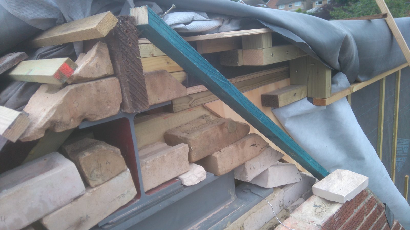

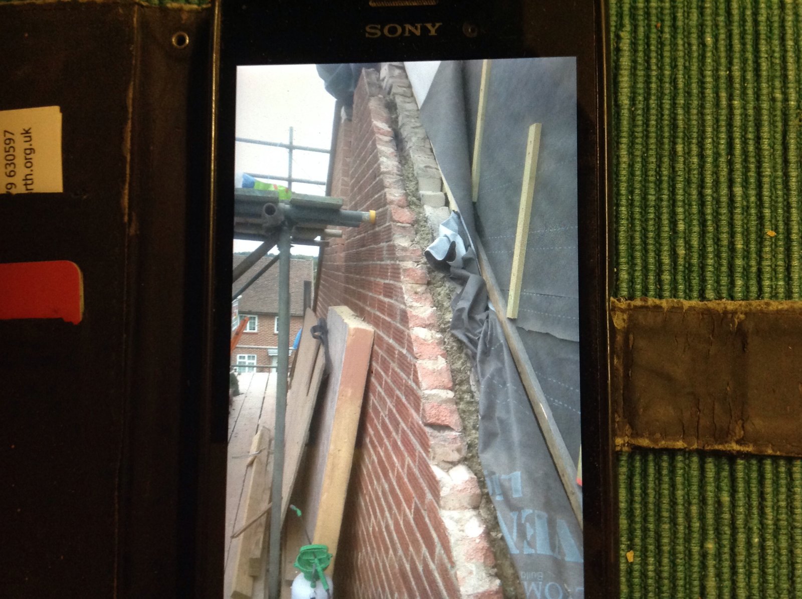

I may be struggling because I'm dumb but i think also as i have no tiles above dormer and a large sofit depth of 6 inches. I took some pictures and will attach so its a better view of what it looks like currently.
The blue batten is what i plan connecting the short length tile battes to as there is now no rafter. Thanks

yes it makes no difference that the picture is a pitched roof dormer. just pretend you can not see the tiles above the fascia.
yours is nearly there, the batten on the brickwork i feel is a bit flimsy. go for some 18mm ply with underlay, counter batten and then the tile batten.
Thanks.
The replacment of gable cavity wall will hopefully be done today and the batten will go in the top, flush with the cavity wall top, but i may also fix ply to that like you said . The batten will be strapped underneath and on to the bricks in a few places also.
