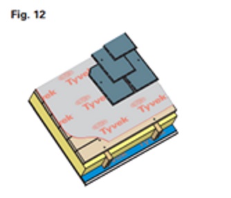

Does anybody here have a good working knowledge of sarking boards in roof applications? :)
I'm thinking to go with the following construction on the pitched part of my warm roof (top down):
1. Cupa Heavy 3 slate
2. Counter battens / battens
3. Breathable membrane
4. OSB3 or sarking boards
5. PIR insulation between rafters
6. Ceiling plasterboard
Sort of similar to attached image, except I am adding battens / counter battens to attach the slate to.
My questions are:
1. What size gap should I leave between the insulation board and the sarking board, if any?
2. Should the sarking / OSB boards be butted together or should there be a small gap between each?
Normally you leave a minimum of 25mm gap between the insulation and boarding. You can leave a small gap if you wish but I am not sure it is essential.
Usually we fix the counter battens through the boarding into the rafters and fix the membrane on top.
