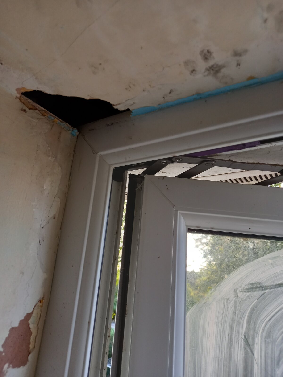

Hello
I have a plasterboard to repair above a window on the 1st floor
Please see photo
The plasterboard just ends on the windows. It is not screwed into anything where it touches the window. The plasterboard moves when you on push it by the window
About 8 inches before the window and above the plasterboard, there is a beam . I assume the plasterboard when it was installed was screwed into this beam.
I could cut the plasterboard back to that beam, cut a replacement piece of plasterboard and insert it in the hole. I would screw it on the beam, but what about the side closest to the window.
Any ideas. Thanks

On the outside of the window the top of the window frame is up againt the soffit, so no lintel
Expanding foam would be the quick way.
Cutting back, affixing a proper support and then adding fresh board/ scrim/ skim the arguably proper way.
Thanks megaross
I was thinking of using expanding foam ... cutting back a section of plastrboard out up to the beam, cutting a new section of plasterboard, screwing it into the beam at one end and then using expanding foam at the other end, on the plasterboard edge. Problem is on a few mm of uPVC window frame above existing plasterboard
Could cut back the plasterboard in the window reveal and try fitting a wooden batton on the brickwork above the uPVC window frame. Batton fixed to brickwork either side of uPVC frame. The only problem with that is what to stick batton to brickwork with, limited space available to insert a drill
