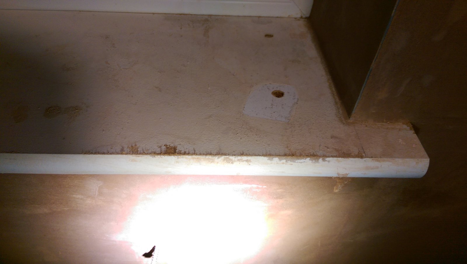

Hello,
Short version -
Plaster damaged my window sill and made some mess, see pictures - what should i do?
Long version -
I have had a Plasterer working on a bedroom for me. He has done the ceiling and walls and I am happy with the quality of the work. He is due to return on Saturday (3 days from now) to fit some coving.

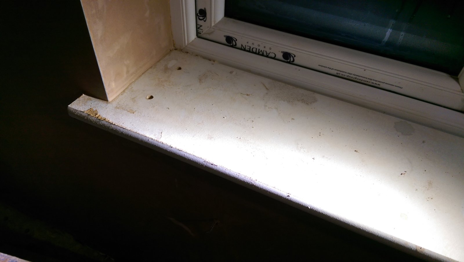

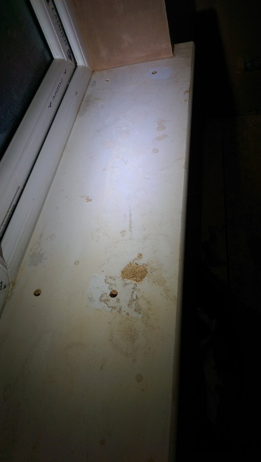

Unfortunately he has damaged a newly fitted MDF internal window board. It looks like he got water and muck on parts of it witch are swollen, and had somehow managed to take the surface off other parts. The whole thing just feels slimy at the moment.
I had put tape over the screw holes in the sill to stop them getting filled with crud. All the tape had gone when I returned. In the pictures you can see some clean patches where the tape was.

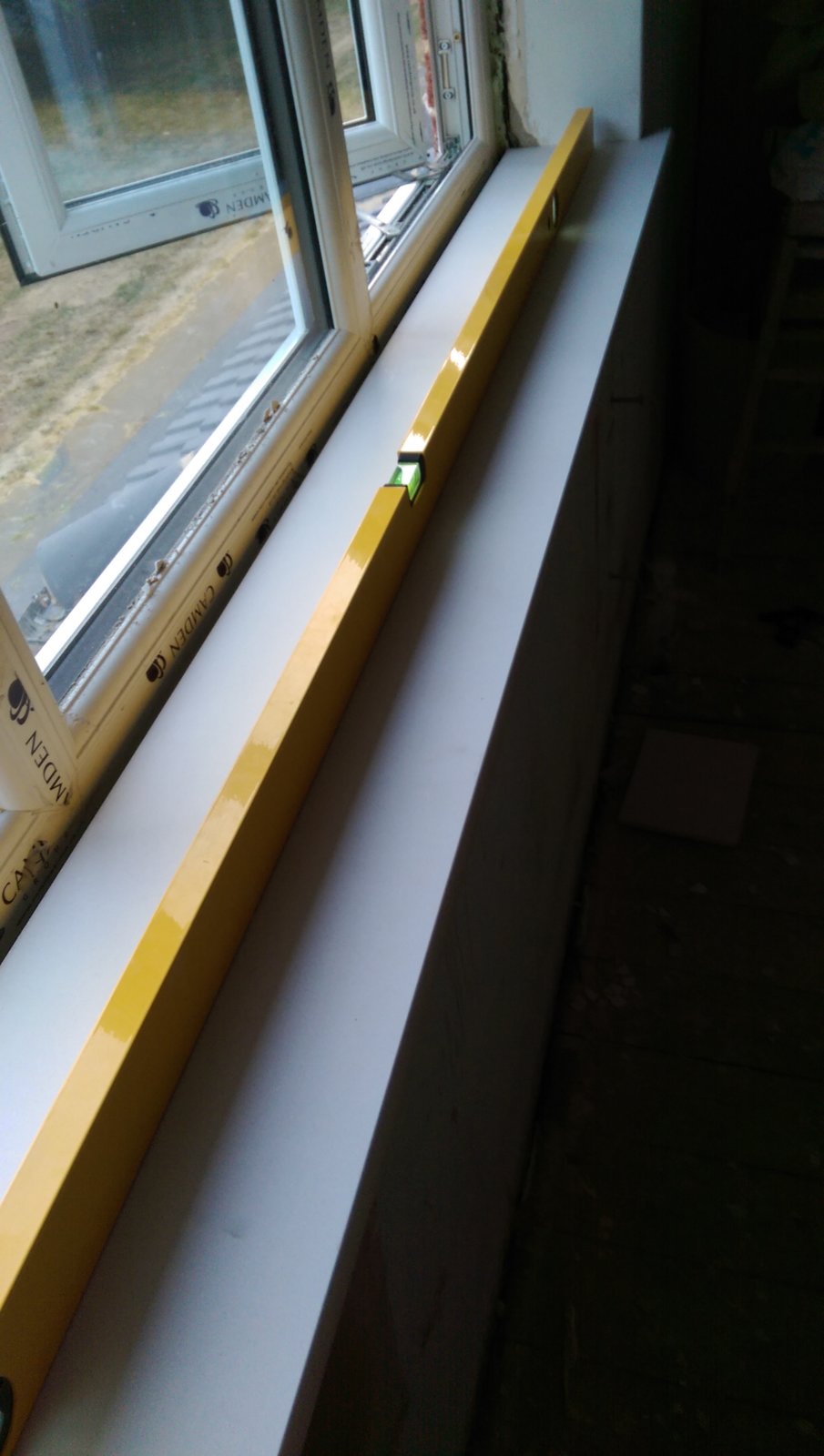

I have included a picture of the sill in the final stages of fitting for comparison.

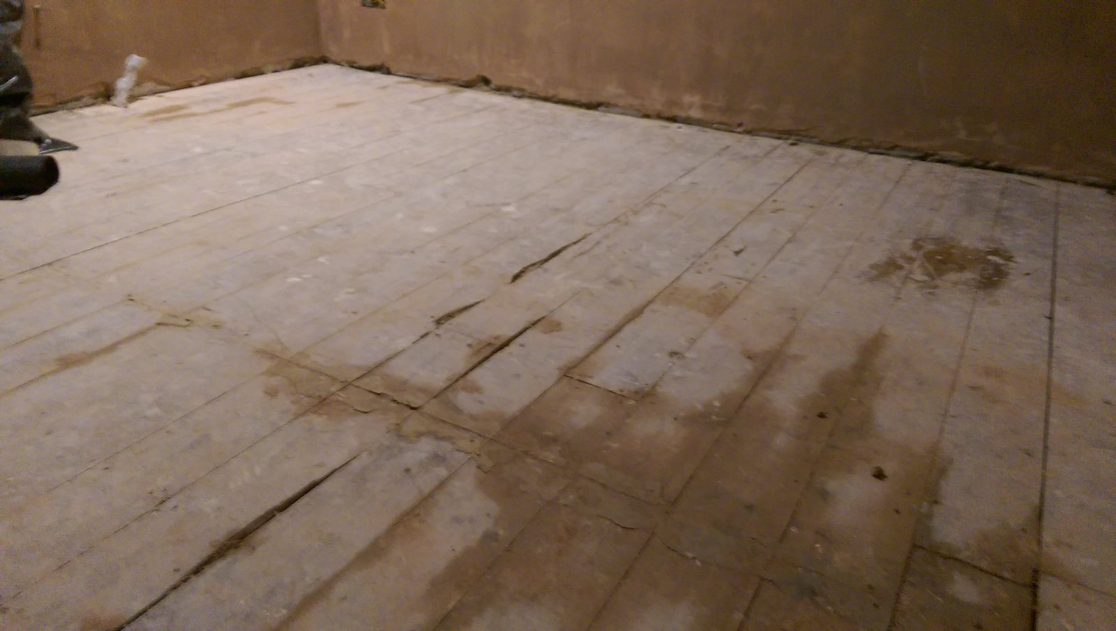

It also looks like no floor coverings were used and every part of the floor boards is now covered in dusty muck.
I mentioned in a text message to him that I was concerned about the state of the window sill, and he replied saying he will give it a rub down for me.
TBH I can live with the messy floor but am worried the damage to the sill will show through after its painted. I plan to use dulax water gloss (because thats what i have).
Any advise is welcome, should I just try to fix it with a bit of sand and fill or would I be wasting my time and should just fit a new one?
Should I request a discount from the plasterer?

Certainly looks battered. It may be redeemable with some careful filling. It looks as though that window board has been exposed to damp conditions for a long time and the wearing surface has become soft. It is difficult to protect a window board (other than actually painting them) because the plasterer needs to skim them in place. It looks to me like yours has been exposed to water and wear for an unreasonably long time.
We always dab a nice flat level plasterboard to the sill masonry then glue the WB to the plasterboard. We also round the return corners back to the wall. Replacing yours now will certainly result in damage to the plaster, but you may also end up ripping the bead off the corner.
It needs 2 pack filler and thorough sanding. I eouldnt say its too bad it looks like it got caught by the trowel.
Its best sanded with course grit wrapped or ideally glued to a hard block like a bit of plywood. -a hard block will sand level, a soft one will just follow the contours.
Its not easy to plaster around a window reveal without getting blobs on the W/B.
I'm yet to come across a plasterer who doesn't leave a mess, but the damage to the window board is unacceptable.
I've got a mate who is a plasterer. He's a messy bastard. When he's done my ceilings in the past, he's got plaster on the windows, walls, floor, kitchen worktops and cabinets. You name it, he's got plaster on it. When I pull him up and point out the blobs of plaster everywhere, he always says "You're a good mate so no charge for that!" :rolleyes:
The MDF is salvageable.
As Notch7 says, glue some paper to a large flat block of wood. I'd go for 80 grit aluminium oxide paper and drop down to 150 grit paper (without the need for a block).
I would advise against using a waterbased primer, the MDF will swell more where it was previously swollen as compared with the rest of the board.
Years ago, my bread and butter was hand painting MDF wardrobes and bookcases. I used to use waterbased (Leyland) primer even though I knew it would raise the grain but I didn't mind given that I used to sand it pretty much back to the MDF so that I could see and then eliminate the horizontal lines that all sheets of MDF have. I had the advantage of having a Festool Rotex with a soft interface pad and dust extractor AND the two topcoats were oil based Dulux Trade eggshell.
Any waterbased paint used on virgin MDF will raise the fibres. Additionally you will have suction issues if you then decide to continue with waterbased top coats.
If you do decide to use oil based primer or undercoat, you will need to leave it for a couple of days before using the waterbased gloss otherwise you risk getting "fisheyes" in the finish

Regarding the floor, it appears no coverings were used. As I said before although annoying I can live with that.
