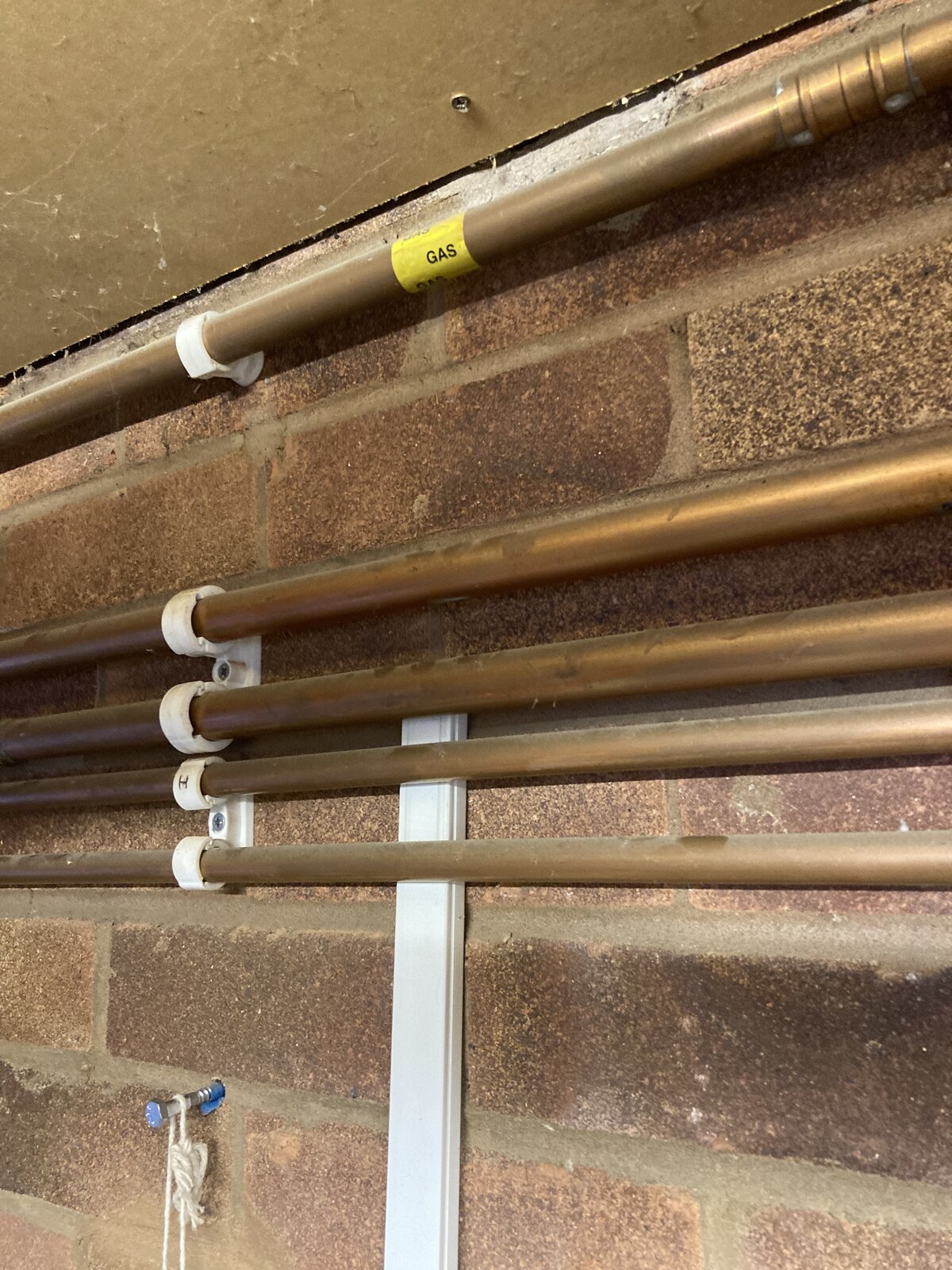

So for a little more context, here is a photo of the piping I want to trunk behind :
that trunking piece is 25x16mm and as mentioned, it’s a really tight fit….too tight, just like my suit trousers from too much WFH and eating rubbish :D
I’m sure I could force it though or perhaps loosen off the pipe clip screws even
From top to bottom, the top 2 pipes are the central heating so both get warm, and the 3rd one down is the hot water so is warm only whilst there is demand
so I guess what I’m after is some trunking like 30x10mm if it exists
Looks like the 16mm will slide under the gas pipe.
Not a perfect way, but you could loosen the screws in the double pipe clips along the run of the four lower pipes. They’ll probably lift up a mill or two, enough for the trunking to go under. Run your cable and tighten up again.
t he at was my thought/solution also, but will the 3 pipes that can get warm, not affect the cables in anyway where the conduit passes underneath the pipes, or will it be insignificant and of no concern ?
thanks again for your input
Remove the screws and fit a 10mm spacer, such as a strip of 10x12mm wood, fit longer screws.

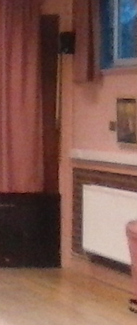

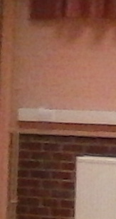

I know it doesn't show in these magnified pics but the horizontal white trunking stops short of the pink wooden vertical (historic sliding partition frame) by about 70mm due to heating pipes (just make out the shadow). I placed 2 pieces of 16 x 25 minitrunking behind the pipes to get some cables from the trunking and through a hole in the wood, I used M6 nuts as spacers behind the pipe clips (painted pink to nearly match). The most difficult part was drilling the holes in the wood.
