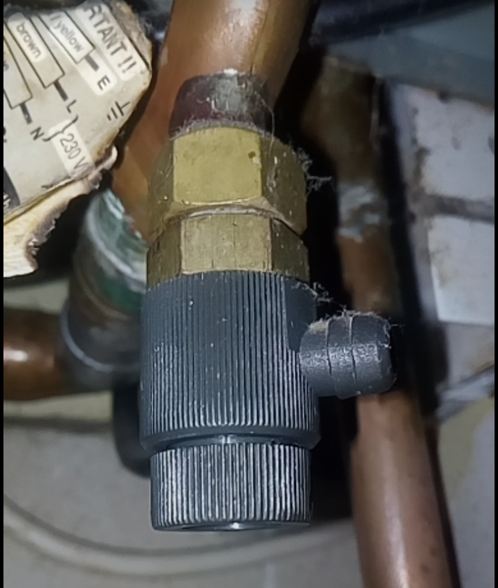

Hello All.
This little fella has decided to start leaking.
Please can anyone tell me the name of it and where I possibly can get a replacement?
Many thanks.

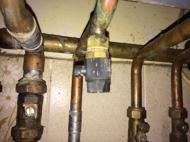

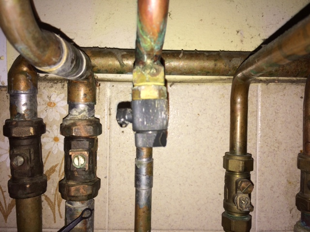

A few more photos of what it's connected to and if it's oriented as you have it in your post.
At the moment it looks like a drain valve, but could be a bleed valve if 180°.

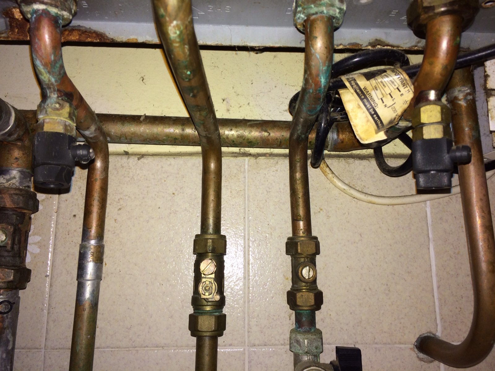

A couple more images for you.
If you need anymore.....

I thought that but it is not. The pipework above is bone dry.
When the hot water is turned on, the water comes out of the side port.

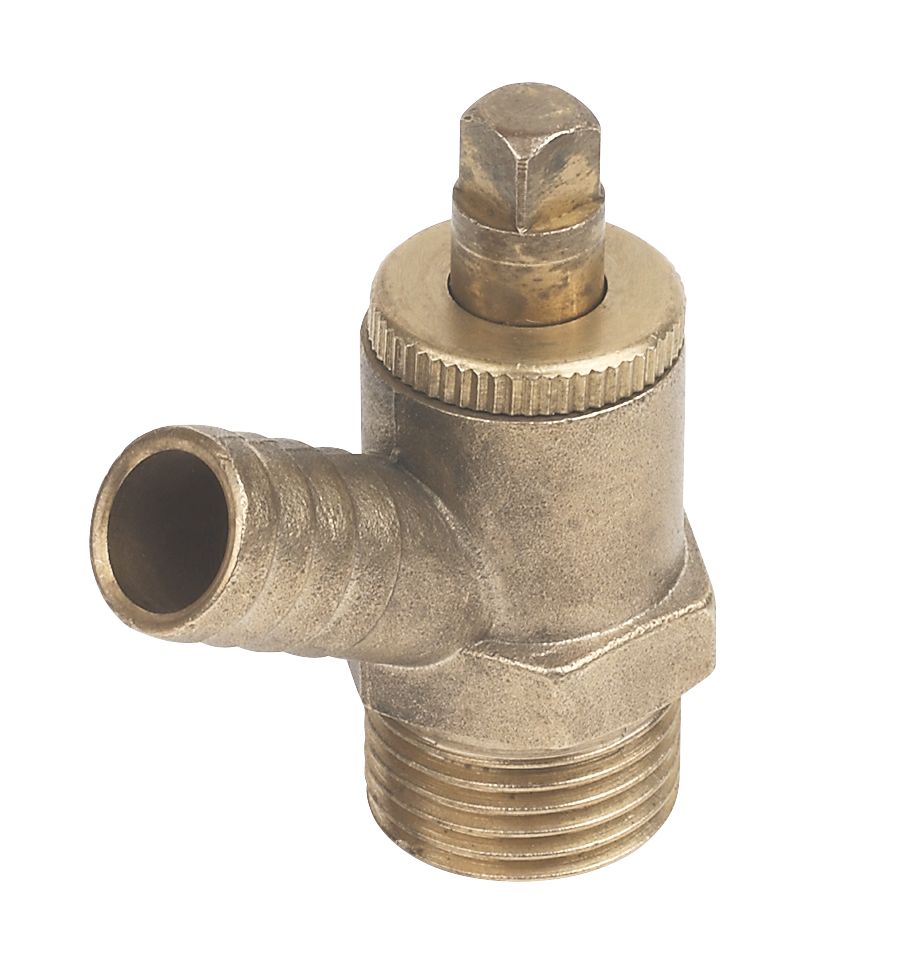

One of these from screwfix - 1/2" Type A Drain off valve
96725_P
Of course that's if the nut is 1/2", once you remove the plastic valve. You'll need some PTFE tape too ( I use gas tape) I would think. Don't forget to turn off the cold water first.
Thank you for your valueable info Madrab. :notworthy:
I will look into this as I have a Screwfix 10 minutes away.
I do have some PTFE tape already.
Thank you. ;)
1/2” will not fit, think the valve might have to be 3/8”

The attached image shows two valves/taps with the leaky one on the left.
The second one on the right, I have used before to drain away the main water to allow me to replace the diaphram, actuator bush, spring kit for the 3 way flow group.
All it appears to do is act like a tap, turn the black gripped dial and the water comes out of the side port.
I have never used this particular valve/tap on the left. So please what is it for?
