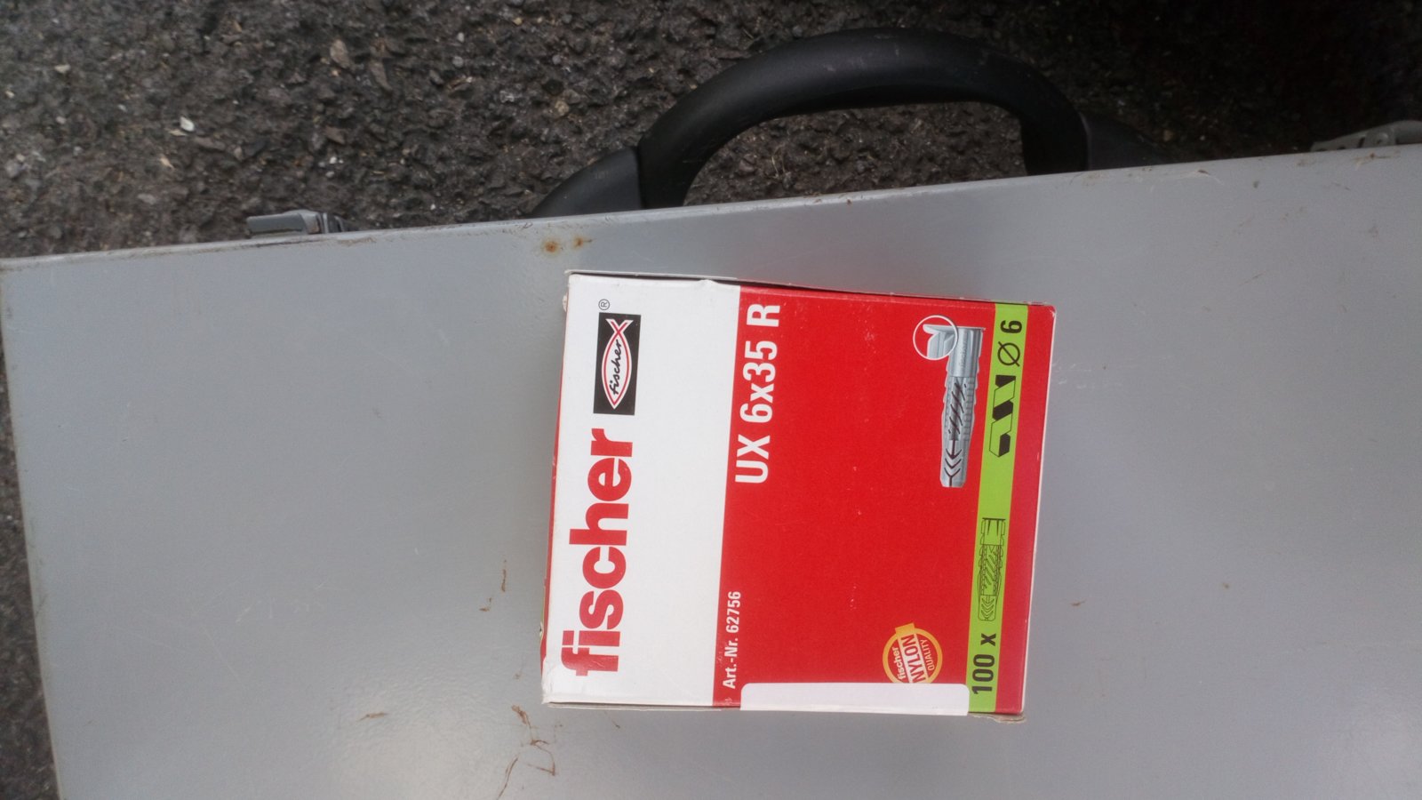

So all a 3 red pkugs were loose so I cut some brown one down and put screw in then hammered in. Used the same screws
Is this the Fisher plugs u were recommending?
