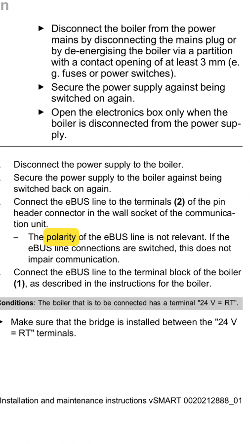

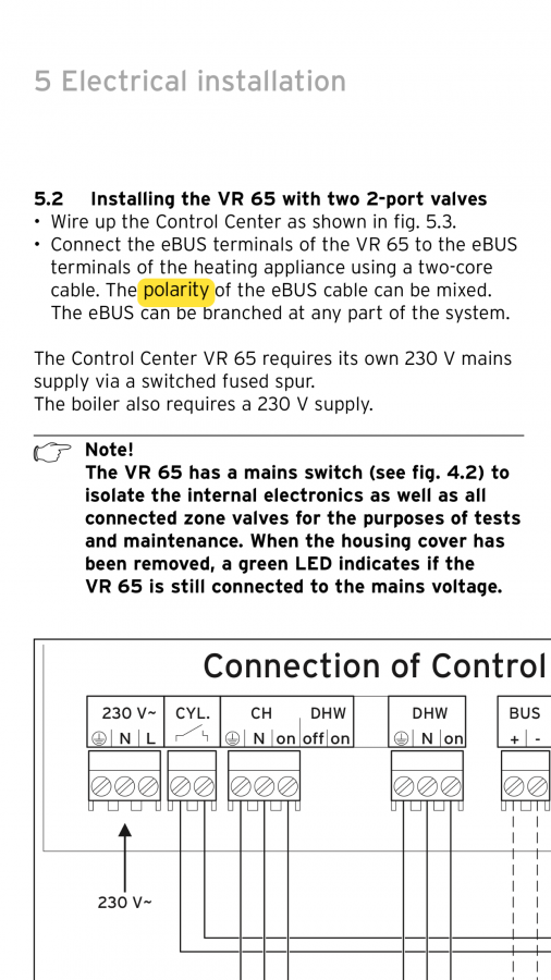

Ok vr65 manual extract

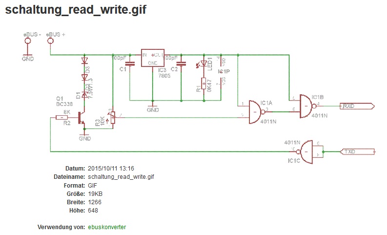

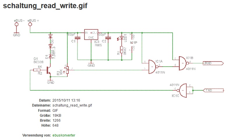

Could you get that cofirmation in writing ?. If Vaillant are using standard ebus physical layer then polarity does matter and there should a fault code for cross polarity on the ebus. A typical ebus to micro-processor interface for data ( receive / transmit ) and power for the device ( 5 volt from IC3 )

A integral bridge rectifier between ebus terminals and ebus interfacing ciruits in bus powered slave modules would allow the data to pass error free even when the polarity along the ebus was switched. This is possible as the mark and space voltages on ebus are high enough that the added volt drop across the bridge rectifier would not significantly affect the data.
logical 0 = 9–12 volt.
logical 1 = 15–24 volt
referenced to the 0 volt of the supply ( master ) on the ebus.
A reverse polarity connection to a slave with a local power supply and / or connections to other equipment would load the ebus+ with capacity to ground which would affect the shape of the data waveform and may lead to data corruption.
Opto isolation between the ebus interface ( bus powered ) and the slave's micro-processor ( local powered ) is the optimum design to remove resrictions on what modules can be connected to the ebus before data transmission become unreliable.

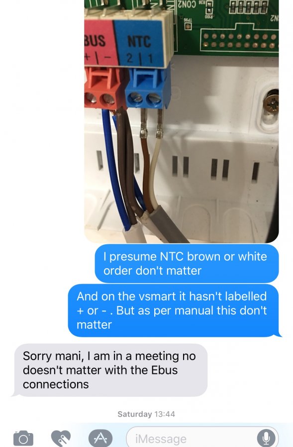

So what your saying is, it's not ideal- because it would be prone to data loss. But will work as it's low volatage?
It will work over a short distance provided all the slave units are designed to work with reversed polarity. The Vaillant list of compatible thermostats, controllers etc etc will have taken that restriction into account
It works because it has a sound communication protocol based on another industry standard communications protocol.( at least it should have )
other than ignore the non qualified google warriors that try to sound clever by bamboozling you with irrelevant crap on the subject.
Having spent several years designing comms systems and protocols I am probably more qualified than you on data communication techniques. The way the various modules communicate in a heating system is hardly irrelevant crap. ( it may be easier to dismiss it as crap than to make the effort to understand it )
The fact is that ebus was "developed" from the industry standard RS484 physical ( +/- 5 volts diffential ) to create a system of power and data over a single pair for low cost domestic heating systems that required power at locations other than the boiler. Thermostats and programmers that required a mains power supply would be difficult to sell due to the cost of installing the mains supply. So power over the data connection was a good idea and by making it work on just two wires in many cases the cable to the old thermostat could be re-used for the ebus wiring.
I switched poles. Mixed poles . It still works
