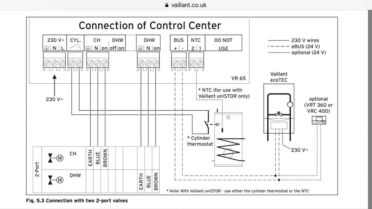

Plumber struggling with vr66 install vaillant
Zone valves don't have a "setting"
So u have heating but no hot water is that correct?
Yes the heating is controlled by the thermostat. It works. The hot water don't.
There is a auto and manual setting on the zone valve. He text me the following
"Check hot water zone valve is manually open if it's closed boiler cannot push water in to tank".
The vr66 should open that valve.
But feel free to open it.

He actuallly appreciates I helped him wire it.

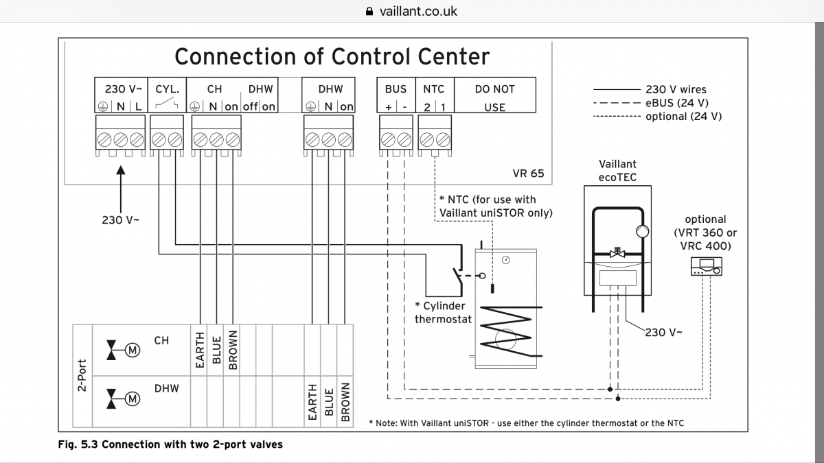

And for the record the vr65 has a better manual than the vr66. Here is a wiring diagram.
Also vaillant advance support confirmed. Polarity doesn't matter in ebus.

The boiler/system setup. Doesn't know it needs to open that valve.
https://www.diynot.com/diy/attachments/img_8618-jpg.116661/
Where is the cylinder stat connected to? The white connection looks like wires are missing.
Can these installers tie their shoelaces correctly? It is a fecking mess - polarity reversed, wires missing, cables all over the place. I haven't looked at the recent manuals for this kit, but really it is wiring by numbers - as I said earlier, my wife could do a better job and get it working first time. The Bunny manuals are a mess, but their connection blocks are crystal clear FFS...
I still don't believe there is a professional involved here - I am not even sure that one of those superfluous valves are the right way round anyway (need to read the 4 pipe manual at some point soon).
HW MV has been installed the wrong way for a start.....wait for thud when it closes...:ROFLMAO::ROFLMAO:
Does it really need an external HW motor valve?
Why is that function not contained within the boiler?
The Unistor is an unvented cylinder so I guess it needs its own motorised valve as part of the safety chain.

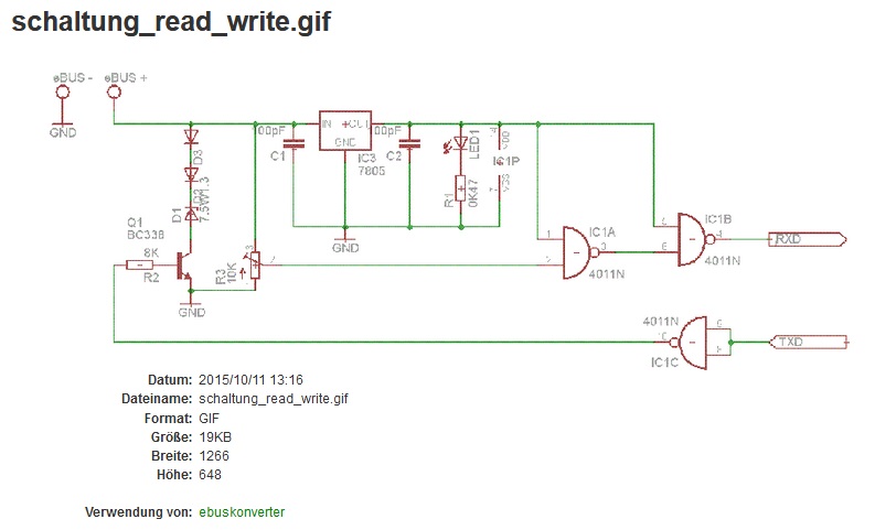

Could you get that cofirmation in writing ?. If Vaillant are using standard ebus physical layer then polarity does matter and there should a fault code for cross polarity on the ebus. A typical ebus to micro-processor interface for data ( receive / transmit ) and power for the device ( 5 volt from IC3 )
