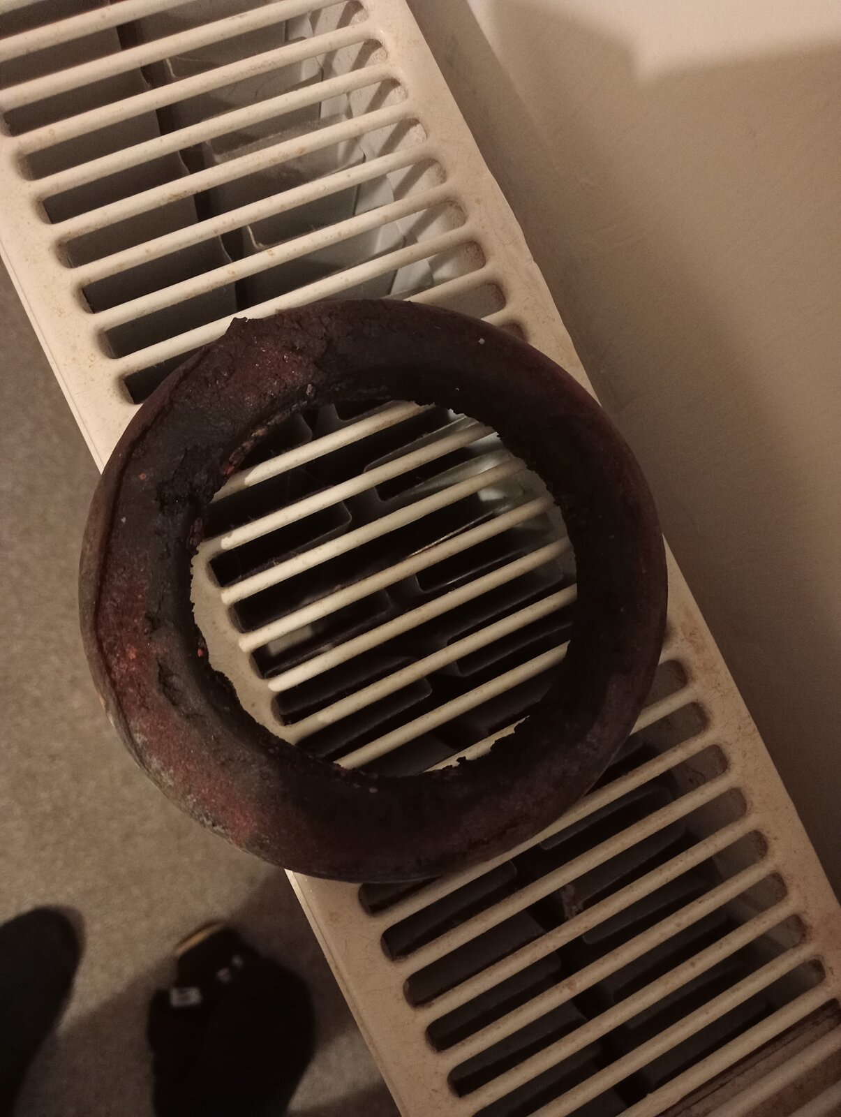

Was a large donut.

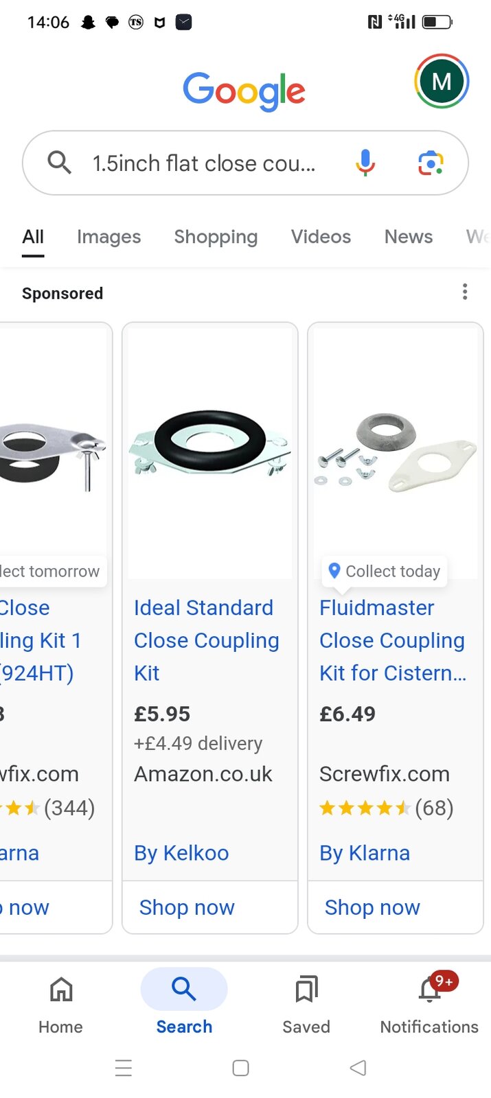

Could it be the fact I fit a close coupled kit that has indentation for the bolts the one I took out was flat. Like this
Its a flat close coupled back plate that was in and large rubber circular washer. Toilet had dimples in to except the bots. Instead of indentations on the close couple kit.
