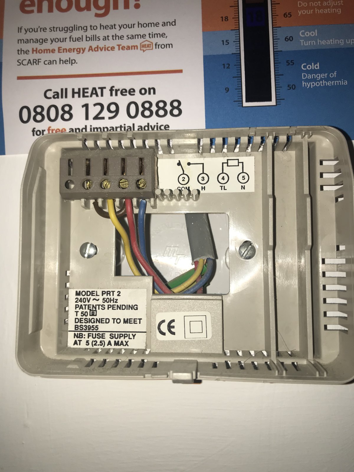

I assume that you took the thermostat photo before you linked the live wires.

Did everything work OK before you installed the Hive? If so, then it will be something you have done wrong when transferring the wires over from the EP to the Hive. If you start altering things that you haven't touched in the process already, you can run the risk of introducing more problems.
The EP contained two internal switches. On/off for hot water and on/off for central heating. The Hive is exactly the same, it contains the same two switches, so electrically speaking nothing should have changed (except for the bypassing of the old room thermostat).

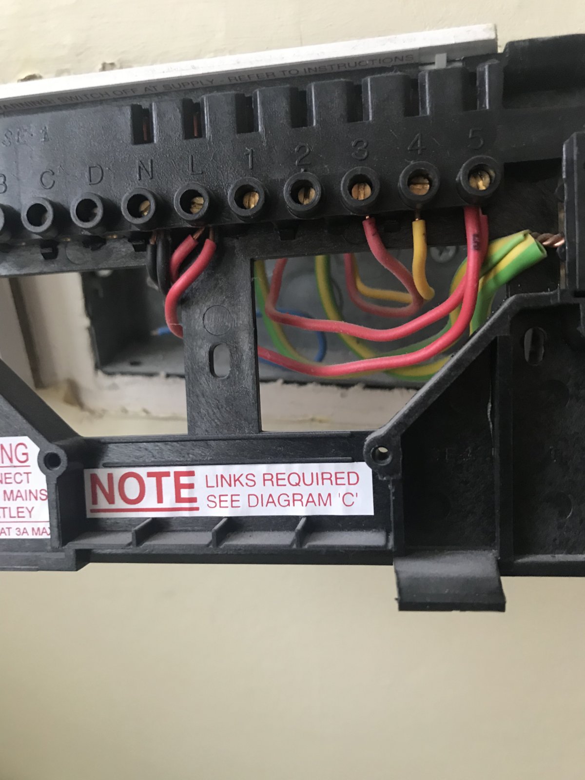

The connections were
N - 2 neutrals
L - 2 Reds (one live bridged from 5)
1 - not used
2 - not used
3 - red
4 - yellow
5 - live and bridge to L
Now... I’m wondering if the red in L and the red in 5 were back to front. ???

They were both connected to the L anyway, so wouldn't have made any difference, and the link to 5 should have gone now. The Hive has this connection made internally.
Once the link between EP L and 5 has been discarded, if there were any other remaining wires in EP 5, they should now go to the Hive L.
Yeah, I'm thinking that's where I went wrong. I left the remaining wire in 5.
That would mean the heating on was in the hot water on connection and the hot water on was in the heating off connection.
When I get home I'll move the red from 5 to L and shuffle the other two up one. Hopefully that'll sort it.
I don't know how you managed that. The Hive doesn't even have a terminal 5!

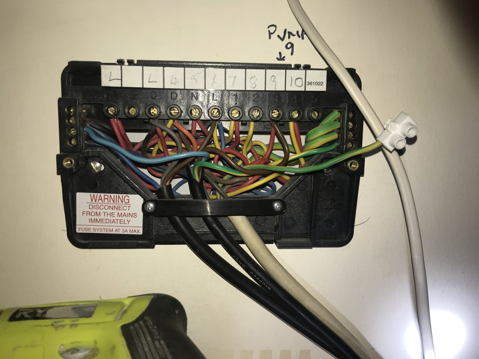

OK after industriously working my way through the various connections I have now established the following:

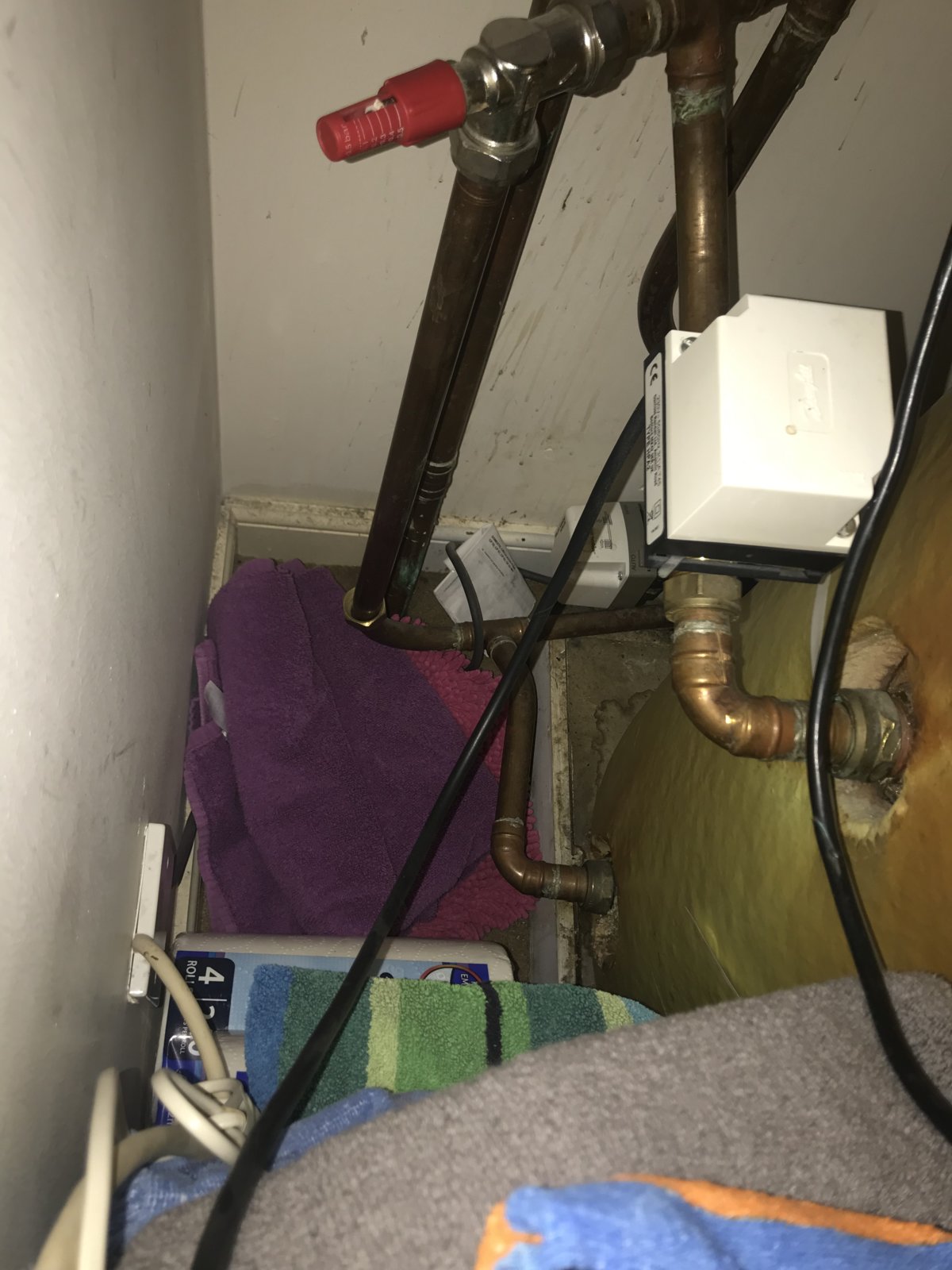

The heating motorised valve powers open but the NC/NO connections remain open circuit whichever position its in.
The hot water motorised valve doesn't power up and is permanently open and the NC?NO connections are permanently closed whichever position its in.
1 - Live 3 x Red
2 - Empty
3 - Live 1 x Red ( Still to identify)
4 - SwL to boiler 1 x Yellow
5 - Hot water Live from Controller 2 x Red
6 - (Think its the cylinder stat still to trace out) 1 x Yellow, 1 x Blue (was connected to HW valve Live)
7 - Heating Live from Controller and output to room stat 1 x Yellow Live, 1 x Red to stat
8 - Return from room stat 1 x Yellow (Live when stat Bridged)
9 - Pump supply from boiler 1 x Red
10 - 1 x Yellow and 1 x Red(live) Still to identify
Whoever has effected a repair previously had put the Heating valve across 8 (from room stat) and neutral, and used the heating pump contacts as a bridge between 5(Hot water live from controller) and 4 (Switched Live to controller)
This means that when the heating demand is on the hot water is automatically on (because the valve is permanently open), and when heating is off, the power to the heating valve is removed so the water passes through the hot water coil.
I have still to identify which are the Frost stat and Water return frost protection which I'm assuming are to be linked to the heating valve and pump control and the return flow stat to the boiler start.
Slowly getting there and in the meantime I have ordered new heating valve and hot water valves. and then I will re-wire the system back to how it should be. That should then mean the hive will be able to select heat without water and vice versa.
All working fine now. Two new valves fitted. Power to HW one from 5. Power to Heating one from 8.
Both Grey switch wires connected to No 3 and Oranges to No 4.
Now it allows HW and Heat to operate independently.
