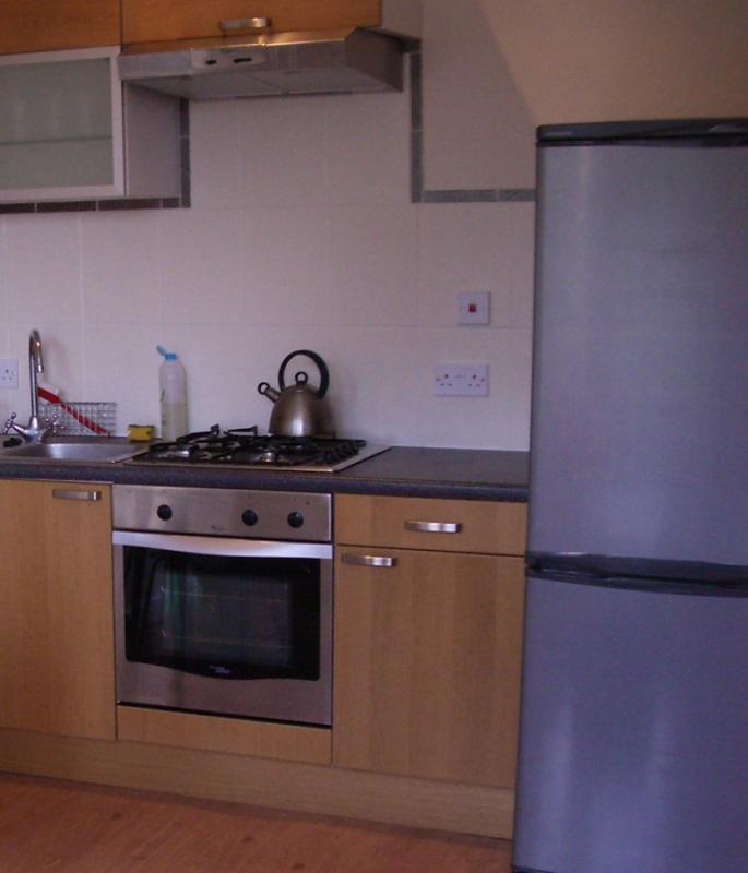

I recently ordered a new dual fuel cooker to replace an existing electric cooker installation...
There is both gas and electrical feed available behind the existing cooker, however the on/off switch for the current electric supply is located about 30cm above the back right of the hob.
The installer refused to fit the cooker because of this, stating it was illegal to have any electrics above a gas hob.
From what i have been able to read online however, this only seems to apply to electrical outlets (ie sockets) and not to a switch.
Also the new cooker has a top, which when folded up to use the cooker would completely cover the switch.
The installer said i would need to get this switch moved, which sounds like a very time consuming and expensive job which would involve ripping holes in the walls, re-plastering and then retiling over the top..
So is this correct? Am i unable to have a new cooker installed without doing anything about this switch, and if so would it be possible to have the switch removed rather than moved? Perhaps if i went for a fully gas cooker i could do without the electric supply?

Quickest and cheapest option - Remove the switch, join the wires, put a metal blanking plate over the top.
Yes, this does result in no isolator in the kitchen, however there is always the consumer unit if some unlikely emergency occurs.
seems sensible to move it to me - off to the right like the one in this picture. Or ask the chap if it could simply be moved straight up? (ie towards the top of the wall out of the way of the heat? Or do you have cupboards there?)
There are no distances given in the wiring regulations, there is a lot of guidance and "good practise", most of it saying the switch should be 30cm from edge of the hob.

You might be able to dicuss it with the installer asking him to quote the regulation that has been breached and perhaps persuade him to take a different view. At the end of the day you can't force the installer to fit it if his risk assesment says it is too dangerous, so find somebody else to install it.
You cannot just move the switch to the right and then
tile over where the switch is
That would leave live cables in the wall that would not be marked by a terminal or accessory.
You would need to re-route the cables to the switch so they run vertically, or horizontally from the new switch position.
That means taking up floorboards/ceiling above, or floor/ kitchen units if below.
You cannot run cables from the new switch, to the old switch and then tile over the old switch
