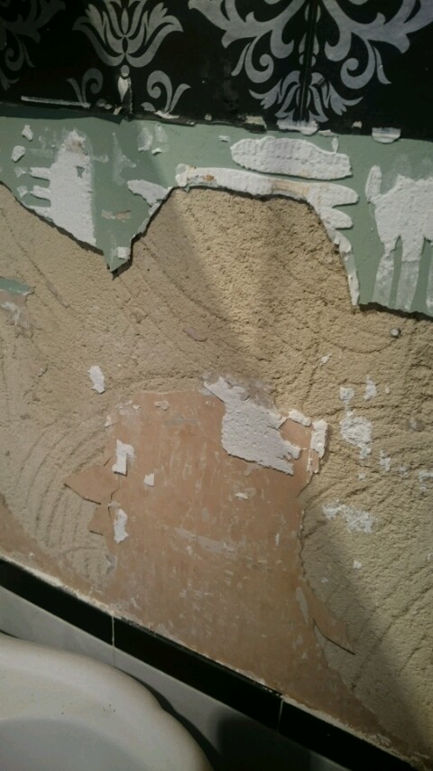

What do I need to do to this bathroom wall before I can start tiling? Thanks.
Remove all tile adhesive, repair skim/finish to plaster wall, the wall need priming first. Leave to totally dry and then prime walls prior to tiling.
Most of the walls are like this - should I just get all the loose plaster off and get it skimmed? Is there a quicker option? Can I use plasterboard?
I would fix tile backer boards to the wall and tile onto that, here are some instructions for fixing to a brick wall ;

It would be easier just repairing the damage to the walls, rather than making a big job out of it. That is unless the basecoat plaster is also shot at?
I like the idea of the hardiebacker boards but don't really have the extra depth to play with. How about a sand & cement skim - I should be able to do it myself and won't have to wait long for it to dry?
Just follow what PPB of Derry told you. It's spot on.
What should I repair the plaster with? I've seen a few people talking about BAL rapidset but isn't this a tile adhesive rather than a filler?
