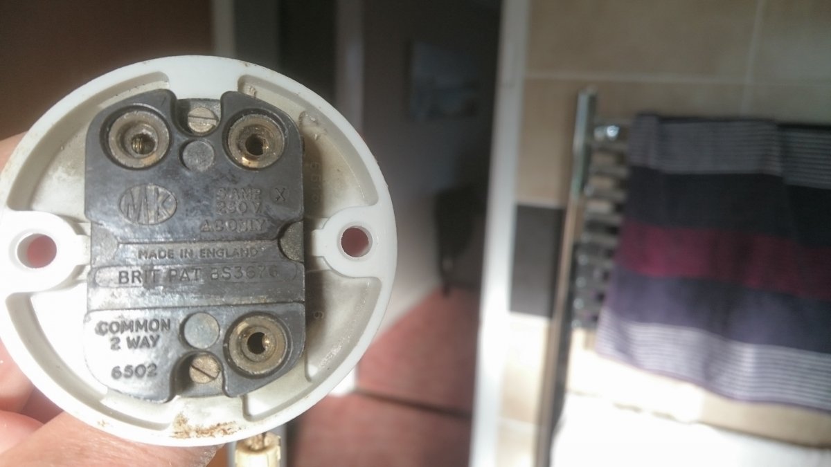

Hello, that's the way I've got the switch wired at the moment. The only terminal marked on the old switch is 'common two way', which was where the white was connected.
...the dirty white wire was connected to is marked "common, 2 way".
That doesn't sound right. On (at least older) MK 2 way switches, the L2 is marked as use for 1 way operation.
But for the same terminal to be both common and 2 way does not sound right.
The common terminal is common to both the L1 and L2 terminals: in one position, the common and L1 terminals are linked together; in the other, common and L2 terminals are linked together. In neither position are L1 & L2 linked together.

Here's a photo of the disconnected pull switch

Hi, I just tried that configuration to see if the 2-way would operate but it is still only possible to control one of the switches: if one is in a certain position, the other can be used to operate the light and vice versa....
Check your connections at the your join, if L1 or L2 is broken ,the switching will operate as you have described.
DS
Thanks, RH. To double check the way the old switch operates, you could use a multimeter set to continuity to check the common terminal links to one other terminal in one position and to the other terminal in the other.
If so, the problem, as ds has said, has to lie with a break in the strappers (the wires connected to the unmarked terminals).
