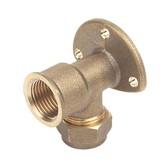

Ideally you would have found something like this behind your tiles:
Fixed firmly, ready for your new arm to screw into!
What came off the old arm was a 15mm compression fitting.
Has the new arm got a chamfer like the old arm? If it has a square edge then you may need a G1/2 female to 15mm compression fitting:
https://www.screwfix.com/p/flomasta-compression-adapting-female-coupler-15mm-x-/93992
Which is a shame, as the thread size of the new arm should match that of the old. It would also project further from the wall, and would be a pain to tighten up.
Alternatively you could get a 15mm push fit to G1/2 fitting:
https://www.toolstation.com/pegler-yorkshire-tectite-sprint-fi-coupling/p35693
But again, it would stand away from the wall and you would have to find a way to stop the arm from rotating!
Personally, I may be tempted to remove the tiles and have a go at installing the proper fitting.
