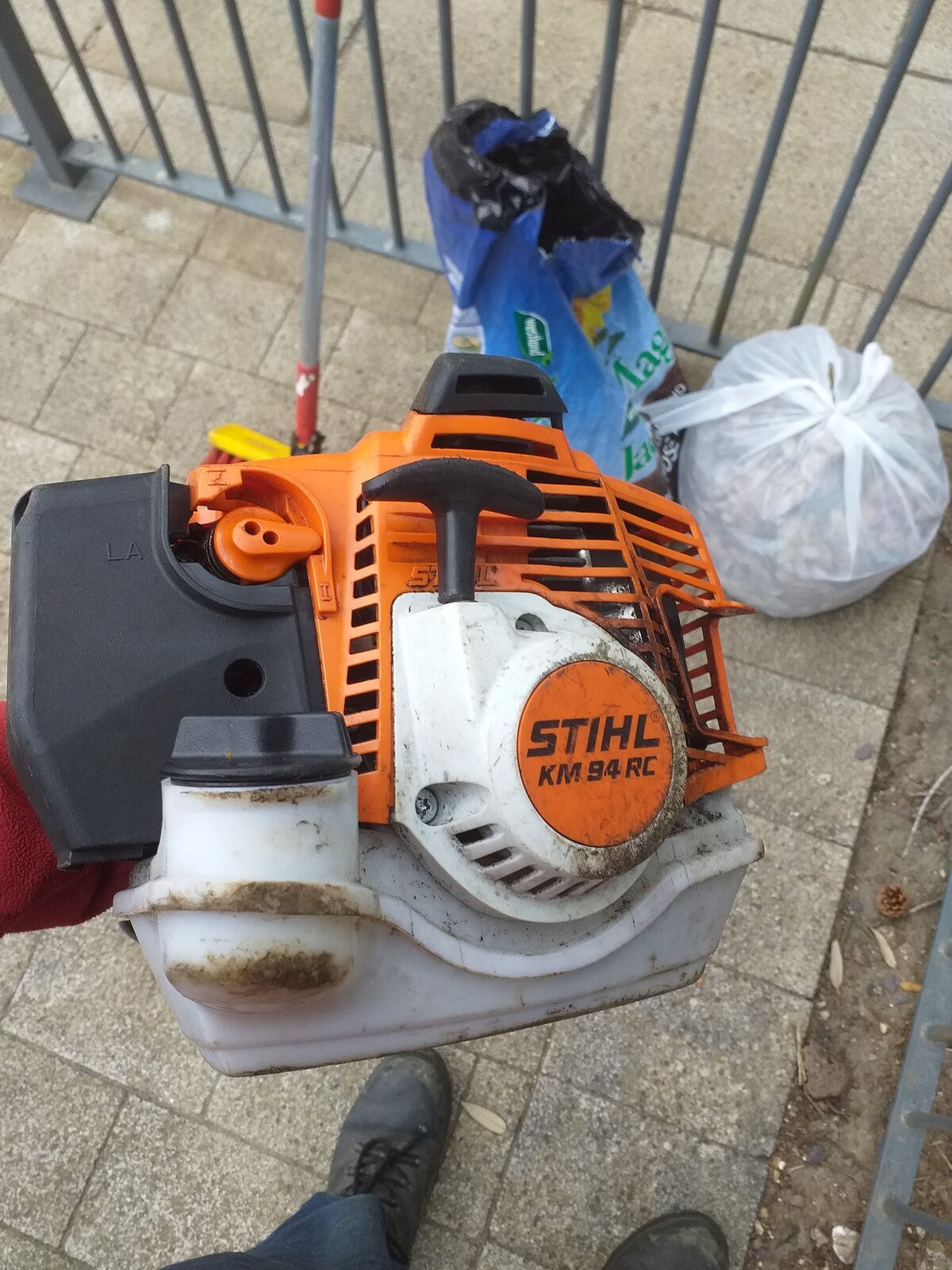

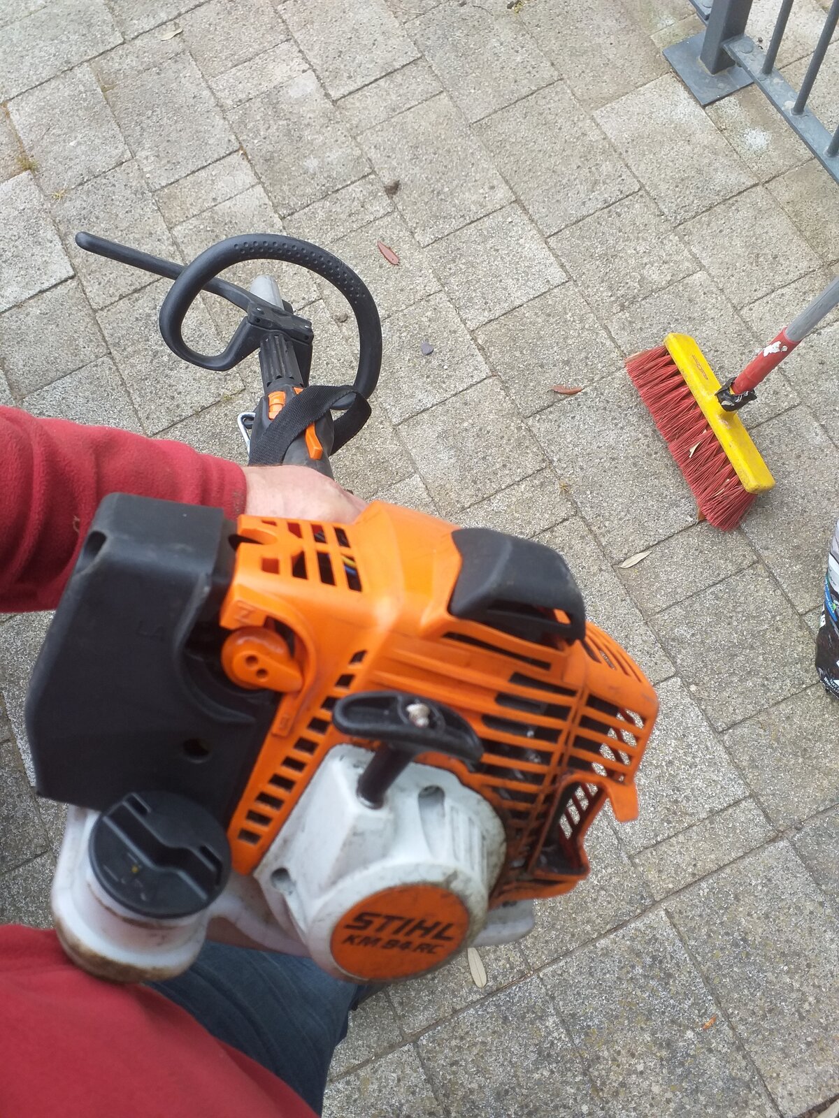

The BG94 stilh tool has been causing me problems since I bought it. Should I upgrade to the bigger model? before it was lack of power and carburetor needed cleaning. Now it won't even start.
The KM94 has easily enough power to drive the tools in the extender range - assuming it is in reasonable condition and hasn’t come from a local authority auction.
Start by giving it a new sparking plug and a new air filter element.
John :)

I've taken it in for repairs. Thinking about buying the bigger four stroke engine. I've got all the stihl multi tool bits so a bit reluctant to switch over to hudqvana right now. Although I know they're better
I'll try what you said when I get it.
