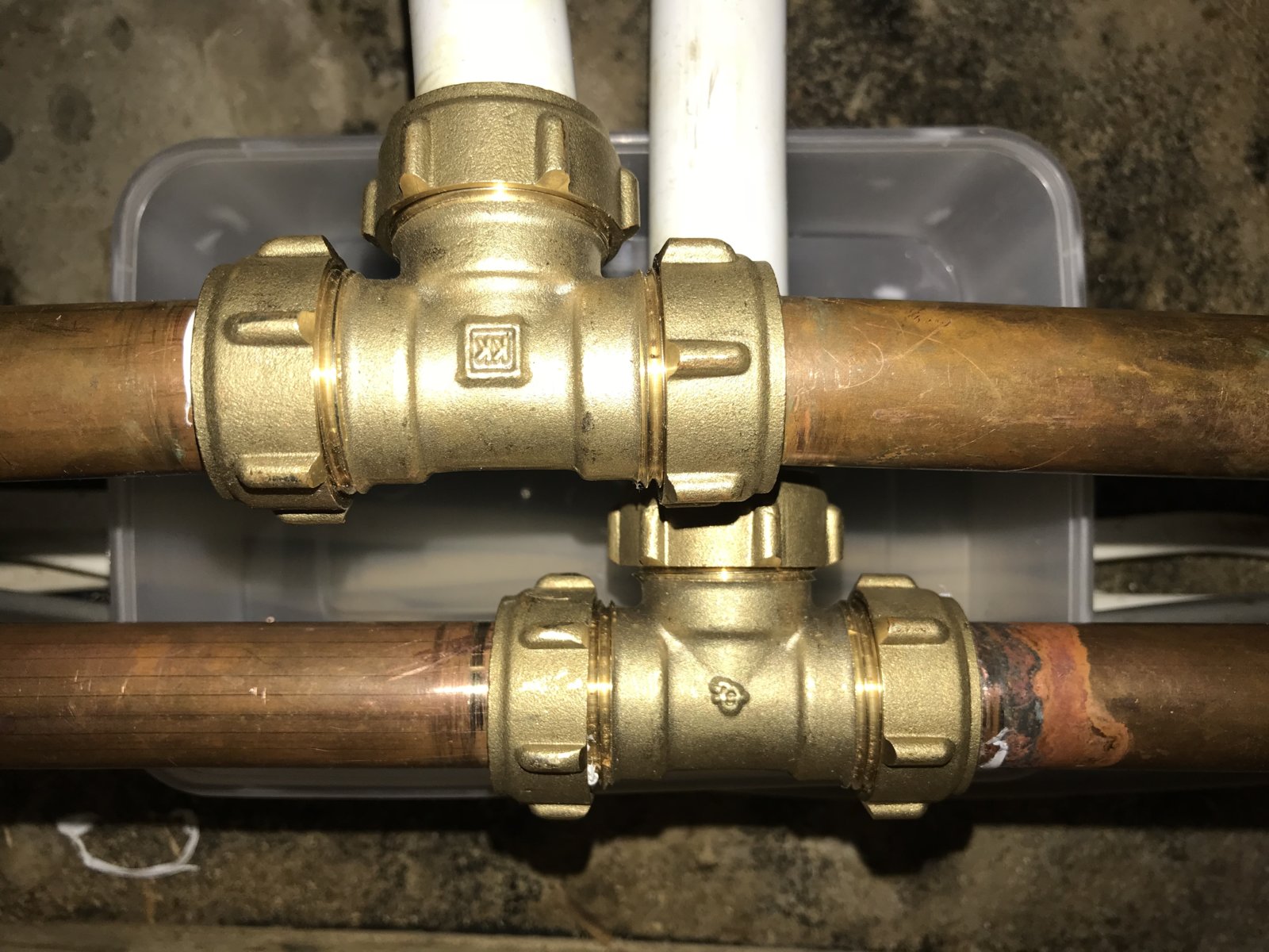

Pushfit and plumber problems
did you recommend the elbows as an alternative solution to me bending the 22mm to get to the shortened poly pipe?
It would also line up better with where that pipe comes through the joist on the right hand pipe. You would then need to shorten the plastic to suit.
The left hand one I would just put back as it is with a conex tee in place of the push fit one. I wouldn't worry about shortening the pipe on that unless you have lots of give on it & can cut an inch off it while leaving it long enough

What brand liners do I need?
I generally use hep2o stainless steel liners for compression & speedfit superseal for pushfit but any will work.

Thanks everyone for the help. was fairly simple in the end.
