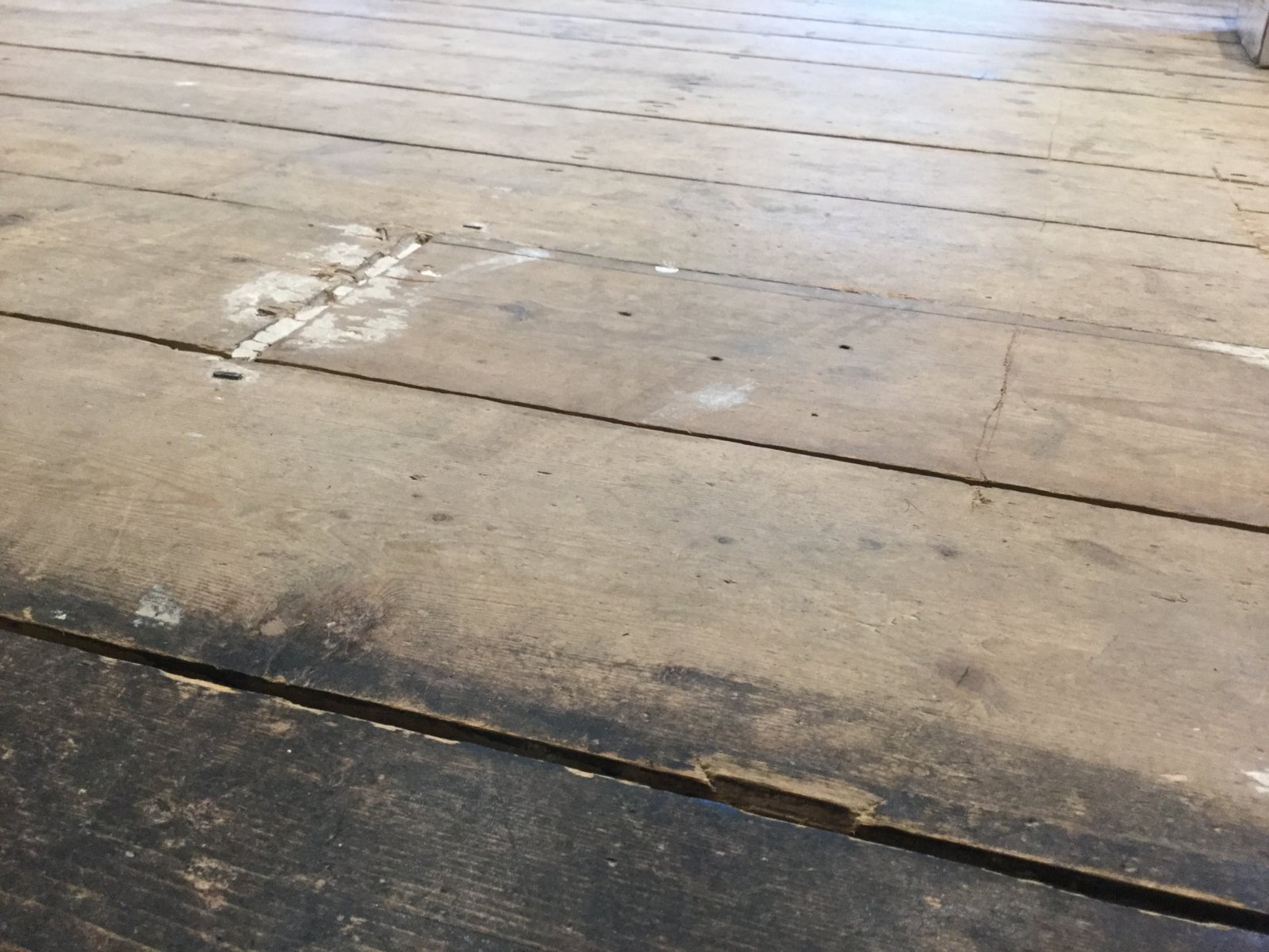

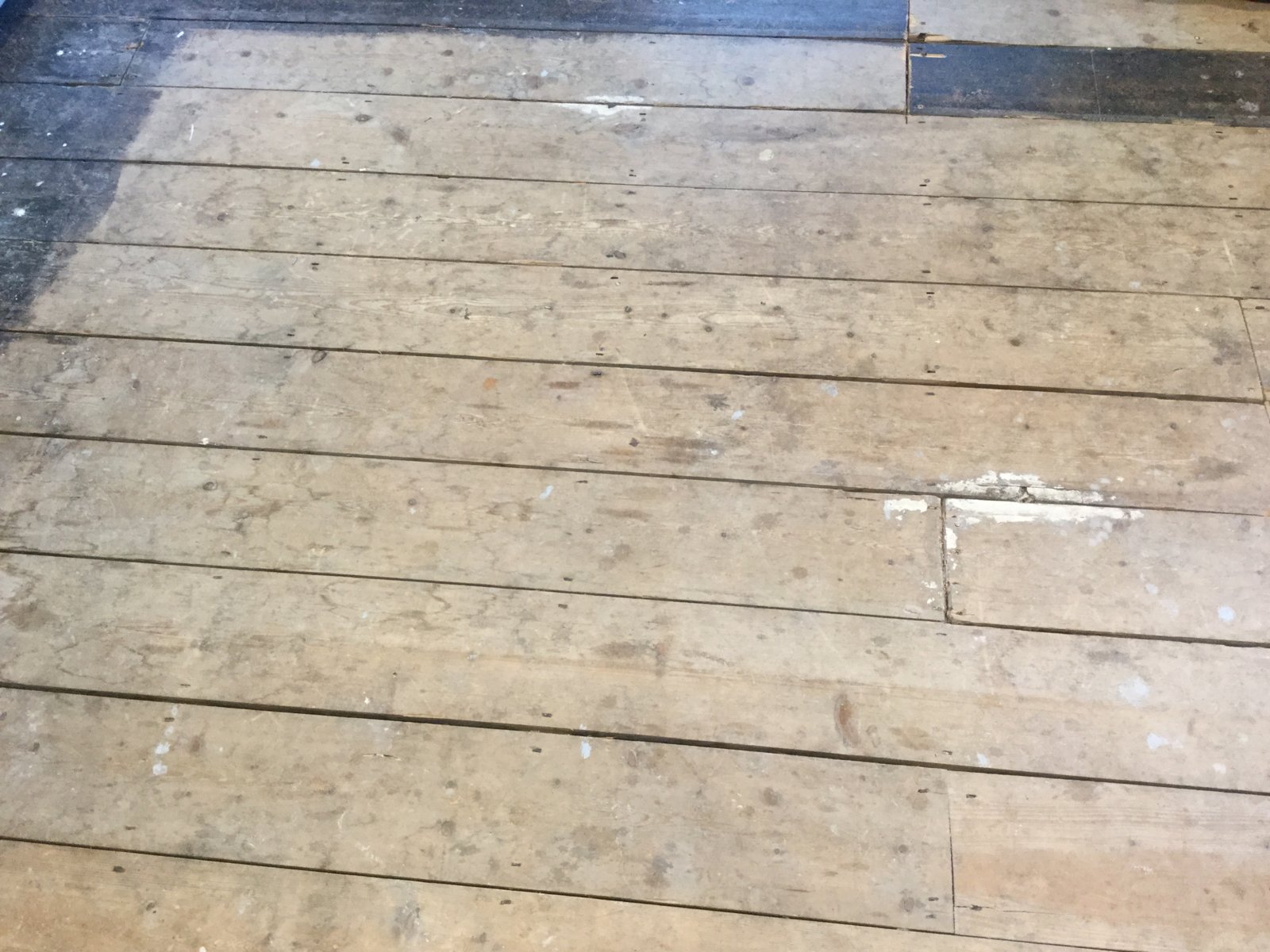

Based on prior diy experience of furniture self-assembly only, I have set myself on an ambitious project of laying amtico click smart lvt throughout the house except bathrooms and kitchen although might bring someone in to do the stairs.
I’ve read up forum posts on the topic and my plan is:
1) lay 9mm plywood on top of current floorboards
Q) whilst bigger is better, considering it will be myself who is doing it, is it ok if I get plywood in size 0.6m x 1.2m (there are some websites offering plywood cut to size)?
2) install underlay meant for lvt flooring to help with evenness (although the tiles also include a thin underlay)
3) lay flooring. I’m not planning to replace any skirting boards,rather I’ll just use the skirting accessories online to give space for expansion
I’ll start with bedrooms and then tackle the concrete in the extension of the house last. All the flooring except the concrete section looks like the attached images (there are some chips to the floorboards and some minor places where wood has risen but I’m just planning to use plywood to smooth it out). Any suggestions / caution before I start would be much appreciated.
Thanks!

I tend to overclad with the biggest sizes I can in order to reduce the number of joints. Gives a more consistent surface to work to. Screw at approx. 150mm centres starting 25 to 35mm in from the sheet edges and make sure that your screw heads are all sunk under properly

No need to ply if floors are flat and fairly level .Good quality Underlay is essential .
Thanks both! @Notadecor8ter i’m now thinking I’ll try with just an underlay and tiles in the smallest room. If that fails I’ll bite the bullet and get a pro in. I was thinking the radiator pipes might be challenging but I’m planning to order a cheap jigsaw so hopefully that’ll help with cutting the tiles too. I’m planning to get a pull in bar.
@foxhole I posted some pictures of the sub floor in my first post so I’ll try with only underlay and tiles for now (the tiles also have a fixed underlay). Any recommendations on what underlay I should go for? Preferably something waterproof I’m thinking.
I was thinking this way any liquid spillages would cause less of an issue for the sub floor (the tiles aren’t recommended for bathrooms / wet areas).
