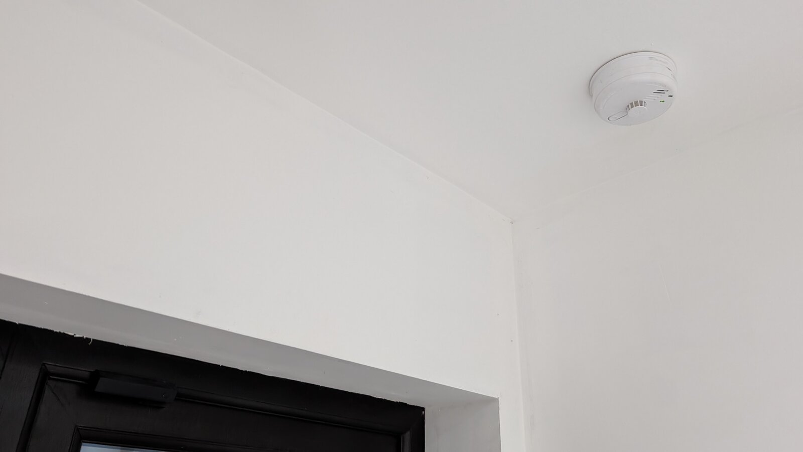

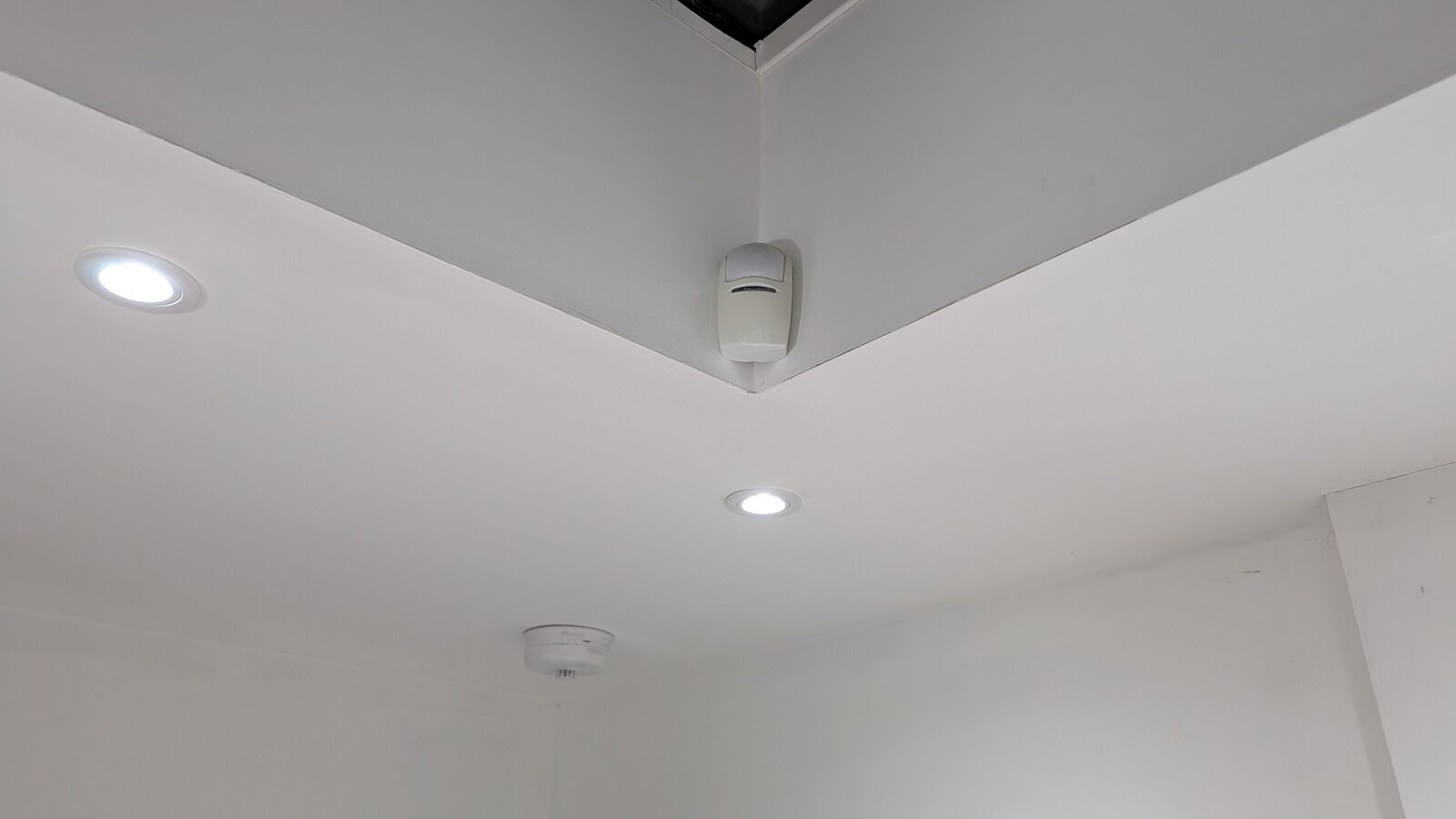

Post picture of device in utility ..
Hi sparkymarka
So these are the three devices in the utility.
The battery in the shock that I changed a few months ago.
The PIR (2x varta CR123) and the door contact sensor one varta CR123 (black one hiding at the top left) are pictured below. Can send close ups if if that helps.

I can only see ….a detector thats upside down
And a nano style device which doesn’t take the cr123a
Why is the sensor upside down …?
I think because the installer decided that would cover the glass if anyone came through it or presumably if they got up there and started looking through that window.

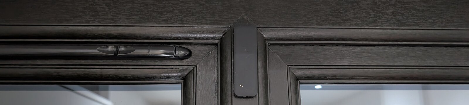

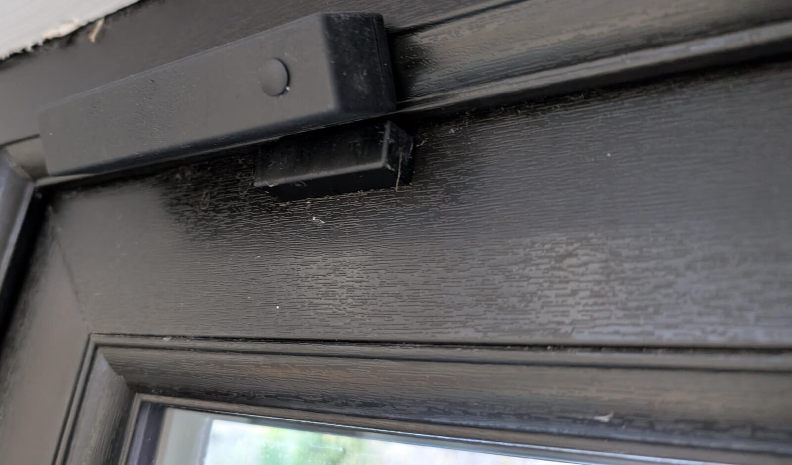

If you look at the top left of the door, you will see the door contact sensor, it's black so not easy to see.
edit: I took a photo this morning.

I’d be concerned that if that contact is still in tamper it’s the rear tamper that’s causing it I would take the board out and test by the panel holding both the front and rear tamper.
May be that the rear tamper plate was over tightened and subsequently broken loose

2) I tested the tamper on the magnetic sensor and it doesn't seem to be the tamper as the light goes off when both tampers are pushed in. So I am thinking it isn't sending back a message to the panel to tell it that the tamper is resolved, and there is a solid red light that stays on.
The red light signifys that the reed switch is open. If u put it next to the magnet it should go green. Can the fault on the keypad be reset when both tamper switches pressed?
It stays red (1st led) regardless of the door being open/close however the third led at the end goes green or off when away/near the magnet .
It doesn't reset with both tamper's pushed in
It looks like it could be a shock/magnetic contact combined sensor, on whoch case the red would indicate the shock sensor. This doesn't help with the tamper fault though. Can u post a picture of the pcb?
