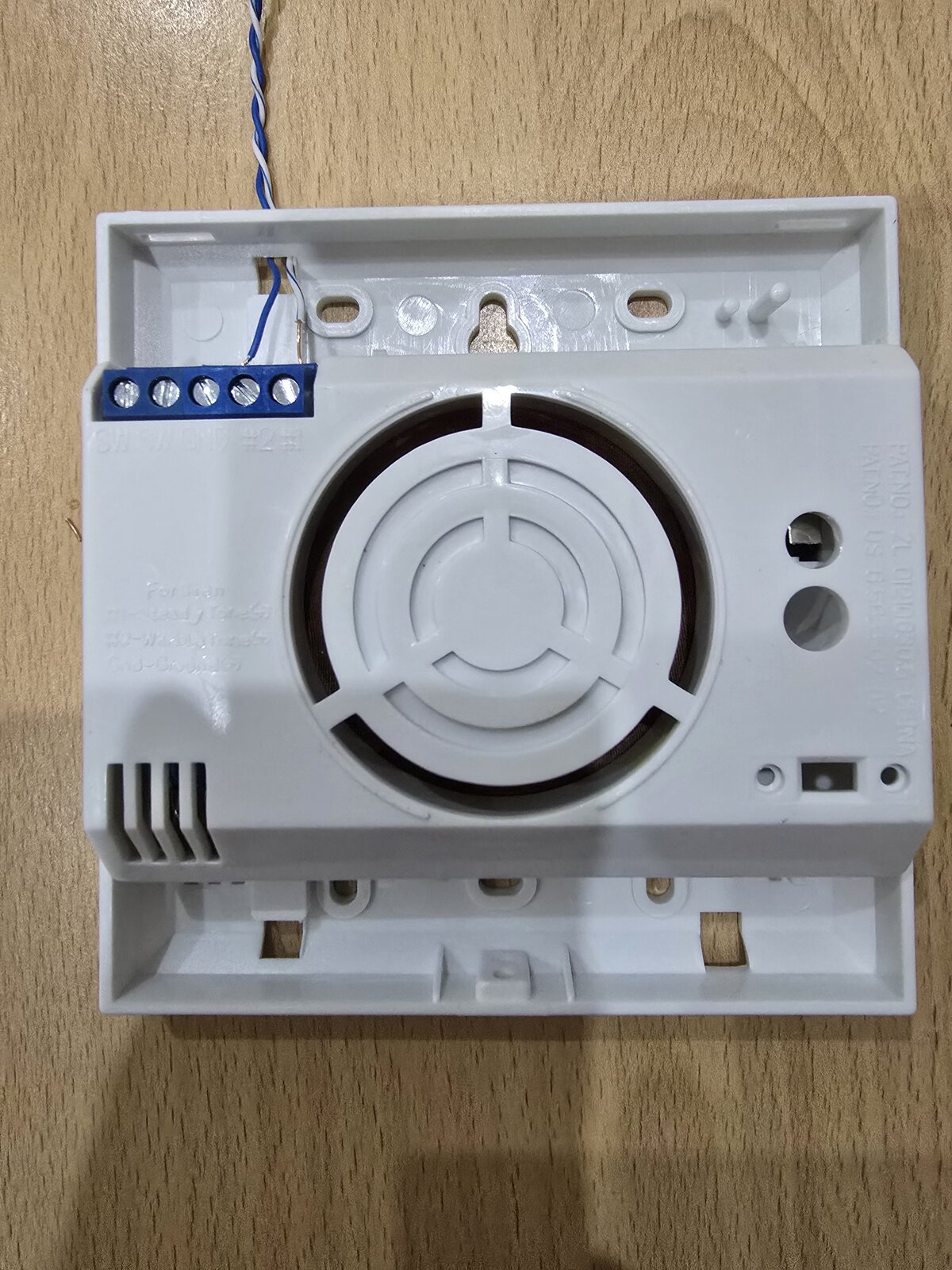

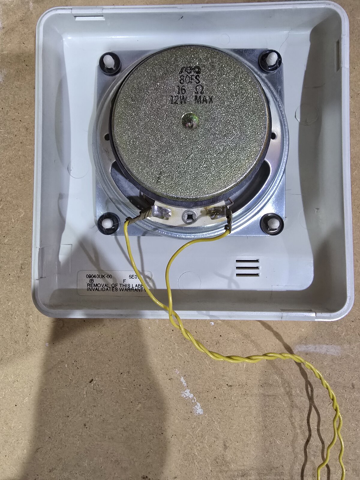

Hi, I’m looking to change the faded alarm speaker, thinking it was just alarm terminology I purchased a CQR sounder, now I find out it needs a 12v supply, is it possible to make this work with my control panel?
Tia
Old
New
Yes I did, so will the new one will work with the board I have?
Nope ….they do 3 versions …int sounder …..int sounder / speaker ….and a grade 3 one …you should have gone for the middle one or an elmdene 16 ohm speaker …
