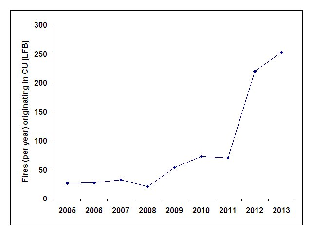

In passing, what appears to have excited the LFB are these figures which they quote, relating to the numbers of fires in the LFB area which allegedly originated in CUs:
If one assumes (and it's a very big assumption) that these figures do accurately reflect the number of fires that originated in CUs, then common sense would suggest that the recent considerable increase was due to something other than the fact that the CUs were plastic. Plastic CUs have been very widely used for very many years and, to the best of my knowledge, nothing about them suddenly changed in ~2011 (and, even if it did, one imagines that most of the 'CU fires' during 2011-2014 probably related to CUs which were installed long before 2011).
What, if anything, resulted in this apparent increase from 2011 is anyone's guess. I must say that my suspicion would be that it might have been an increase in the number of fires ascribed to CU origination, rather than an increase in those which actually did originate in CUs - but who knows?!
Not just common sense, but also science, engineering etc.
The case of a CU cannot possibly be the cause of a fire. Some may well burn too readily when ignited, but even the cheapest and nastiest do not self-combust. If those figures do accurately reflect the number of fires that originated in CUs then what we are seeing is a marked increase in fires which start either because of poor quality internals, or poor workmanship when installing, or a combination of the two.
Addressing that by requiring the boxes not to catch fire when there's a fire inside is a bit like trying to cure obesity by buying larger trousers.
Indeed, but I would hope that all such disciplines maintain consistency with common sense.
The case of a CU cannot possibly be the cause of a fire. Some may well burn too readily when ignited, but even the cheapest and nastiest do not self-combust. If those figures do accurately reflect the number of fires that originated in CUs then what we are seeing is a marked increase in fires which start either because of poor quality internals, or poor workmanship when installing, or a combination of the two. Addressing that by requiring the boxes not to catch fire when there's a fire inside is a bit like trying to cure obesity by buying larger trousers.
Indeed - the primary efforts should obviously attempt to address to underlying causes of the fires, not to 'contain' them after they have been started by something else. Having said that, no such efforts would be totally successful, so it's common to have secondary requirements to limit the spread and/or consequences of fire after it has started (however started).
There is also the question of 'perspective'. Even if there are 250 or so fires per year originating in CUs, it's probably the case that few of these result in deaths or serious injuries - and, in the 'real world', one has to wonder how justifiable is a regulation which will come to affect every electrical installation in the country (at very considerable cost) if the number of deaths/injuries is (in relation to 'the big picture') extremely small.
