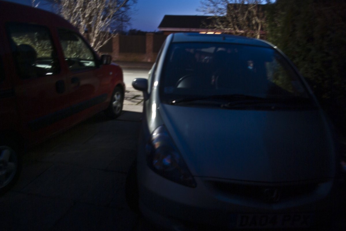

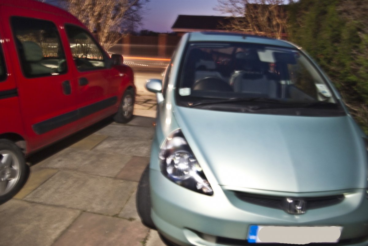

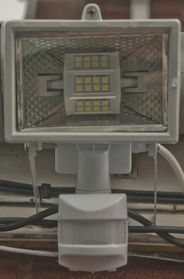

IMGP6859.jpg IMGP6860.jpg IMGP6604_1.JPG Showing lamp fitted and how it lights up my drive so good idea of the spread it is a 5W R7s it will not dim 85 ~ 250 volt 400 lumen. It does what I want. It was also cheap. But ordered in Dec arrived in Feb so took a long time to arrive.
This is the one I bought I felt at £2.65 it was worth the chance I was expecting to have to modify the holder, however it went straight in. In real terms the original reflector now does nothing the angle of the three strips compensates for no reflector. There must be less light than with a 120W bulb but still enough for what I want.
