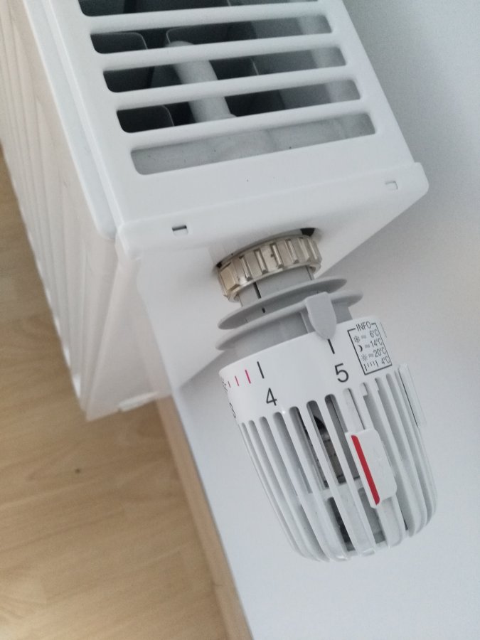

@Joe: I turned all radiators in the house off, except the three in question, which then became as warm as I would expect when turned up to full heat. I am now turning the other back on, and putting everything in the house to 2 out of 5 power.

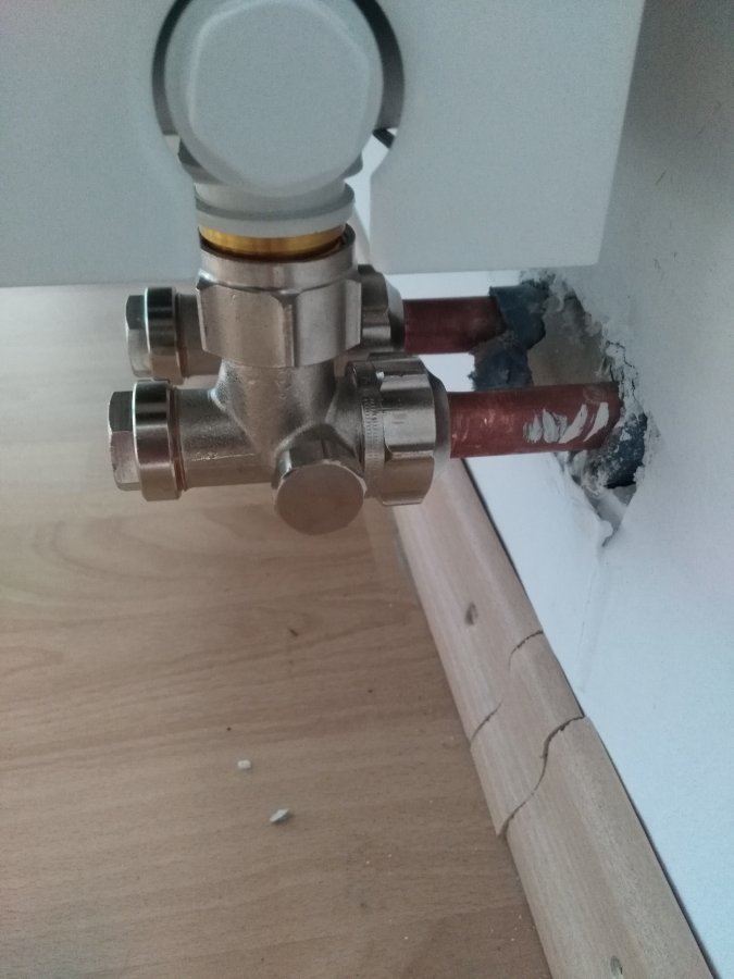

@DP: I tried this earlier this week. Both pipes on the radiators that don't work were stone cold. Our plumber indicated that we have a mixture of a one- and two- pipe system. He tried to consolidate them onto the same type of system last time he was here -- but I don't know which, as I was at work and my wife can't remember. In any case, it didn't change much in terms of performance.
I've attached pictures of the radiator pipes and controls in case that helps.

your system needs balanced read the FAQ on here but your rads are slightly different if they all have the same valve arrangement

I assume you are talking about the Thermostatic Radiator Valve's control, which is marked 1 to 5. The numbers are not power levels but represent room temperatures - 4 is about 21C. Turning the control to 5 is telling the stat that you want a room temperature of about 24C. The valve, internally, will be fully open until the room temperature is about 2C below the set temperature. It then starts gradually closing until the required temperature is reach. The valve will fully close if the temperature rises about 2C above the set temperature (due to TVs, body heat, sun warmth.
So by setting all TRVs to 5 you are saying that you want every room at 24C. The rads may get very hot, but this is because the system has been designed for a lower temperature, say 21C, so the Rad valve is fully open in a vain attempt to reach 24C, which may never happen.
Luke-warm rads is not always a sign that they are not working. It could mean that the room is up to temperature and the TRV has reduced the heat output to match the heat loss.
Your system could need balancing, which will not be an easy task if there is a mixture of one and two pipe systems. The two pipe rads are balanced so there is the same temperature drop over each rad (10C to 20C, depending on age of system). Single pipe systems have the same drop over the complete chain of rads, but it is shared between rads. The rads should have been sized taking into account the reduced output when run at lower temperatures. A single pipe system should also have a pipe bypassing each rad, so only a proportion of the flow goes through each rad. The bypasses should have been adjusted when the system was installed. This means that, unlike the 2-pipe system, the flow and return temperatures for each rad reduce as you move along the chain away from the boiler.
