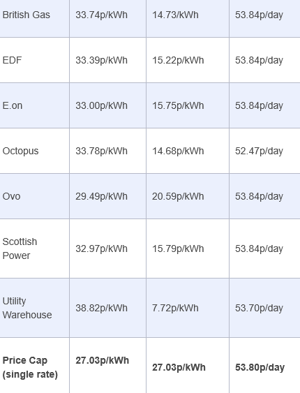

So now onto storage heaters, my first problem is to find Economy 7 rates, Octopus have Snug, which is 6 hours at night and an hour during the day, and so not easy to get straight answer, but it seems 14.68p/kWh nights and 33.78p/kWh in the day is about right, and to start with this is nowhere near as good as the deal I have for 5 hours, I use 12 kWh per day on average, Economy 7 users normally have smaller homes, so I would say 8 kWh/day without heating is fair guess. So around the £1000 a year for the peak supply. I would guess storage heaters used for half the year, so need to save around £600 with off-peak to break even. So gaining 9.18p for every kWh used, so need to use around 6500 kWh off-peak to break even. So my maths shows around 36 kWh/day.

Thank you, @JohnW2 I seem to remember on this forum, someone, maybe you, saying how the peak rate was not that high. I did find a list
I found shows a lot more for the price cap (single rate) to what I was paying, so not sure about the other rates?
Thank you, @JohnW2 I seem to remember on this forum, someone, maybe you, saying how the peak rate was not that high. I did find a list I found shows a lot more for the price cap (single rate) to what I was paying, so not sure about the other rates?
With So Energy (formally ESB), it seems that I am currently paying (per May bill) 27.0952 p/kWh peak, 19.7048 p/kWh off-peak and 46.74 p/day standing charge (all those excluding 5% VAT).
My 'peak' rate is hence only fractionally above the 'cap' for single-rate tariffs and my standing charge a little under the 'cap'. Hence, on the assumption that I would probably be paying the 'capped' rate if IO had a single, rate tariff, having E7 is therefore essentially a 'no-brainer' for me.
Thank you, @JohnW2 as said single rate Octopus is 23.86p/kWh and 68.17p/day standing charge for me, but it seems it varies post code to post code.

Using your figures for Economy 7, Octopus base rate, and it seems @AndyPRK is spot on with the 70%. It will be a little less, as not factored in, you pay less standing charge. And 28.45p/kWh (5% tax added) is about what I paid with British Gas, a few p under or over is not really a problem.
Using your figures for Economy 7, Octopus base rate, and it seems @AndyPRK is spot on with the 70%. It will be a little less, as not factored in, you pay less standing charge. And 28.45p/kWh (5% tax added) is about what I paid with British Gas,...
I'm not sure whether or not your Octopus figures include VAT. If, like my So Energy ones, they do NOT include VAT, then I'm not sure where the "70%" comes from - comparing my E7 (27.0952 day and 19.7048 night) with a 23.86 single rate (and ignoring differences in Standing Charges), my calcs (if I've got them right!) suggest that E7 would be financially beneficial if one used more than about 44% of total energy at night rate. To be financially beneficial over a full year, one would obviously have to use at least 44% of the year's total usage at night rate.
Octopus, and maybe other suppliers similar, divide the UK up into 15 areas for unit rate, and standing charge. The Octoprice web site shows this clearly.
