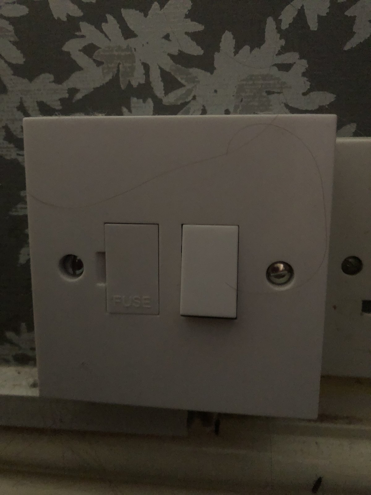

I haven’t had an electrician out yet, simply because I switched the sockets back on last Friday and they haven’t tripped since. I don’t want to call someone out whilst the fault isn’t showing.
There is an outside light which is wired from an upstairs plug socket, but it can be switched off independently and I did that the first time it tripped and haven’t switched it back on since, so it’s tripped with that off.
As soon as it trips again I’ll get someone out to solve the mystery
I’m sorry I have no clue what a double pole switch is :-/
That is a switched fused switch. It will be a double pole switch, meaning that it switches off both the live and the neutral wires from watever is connected to it.
