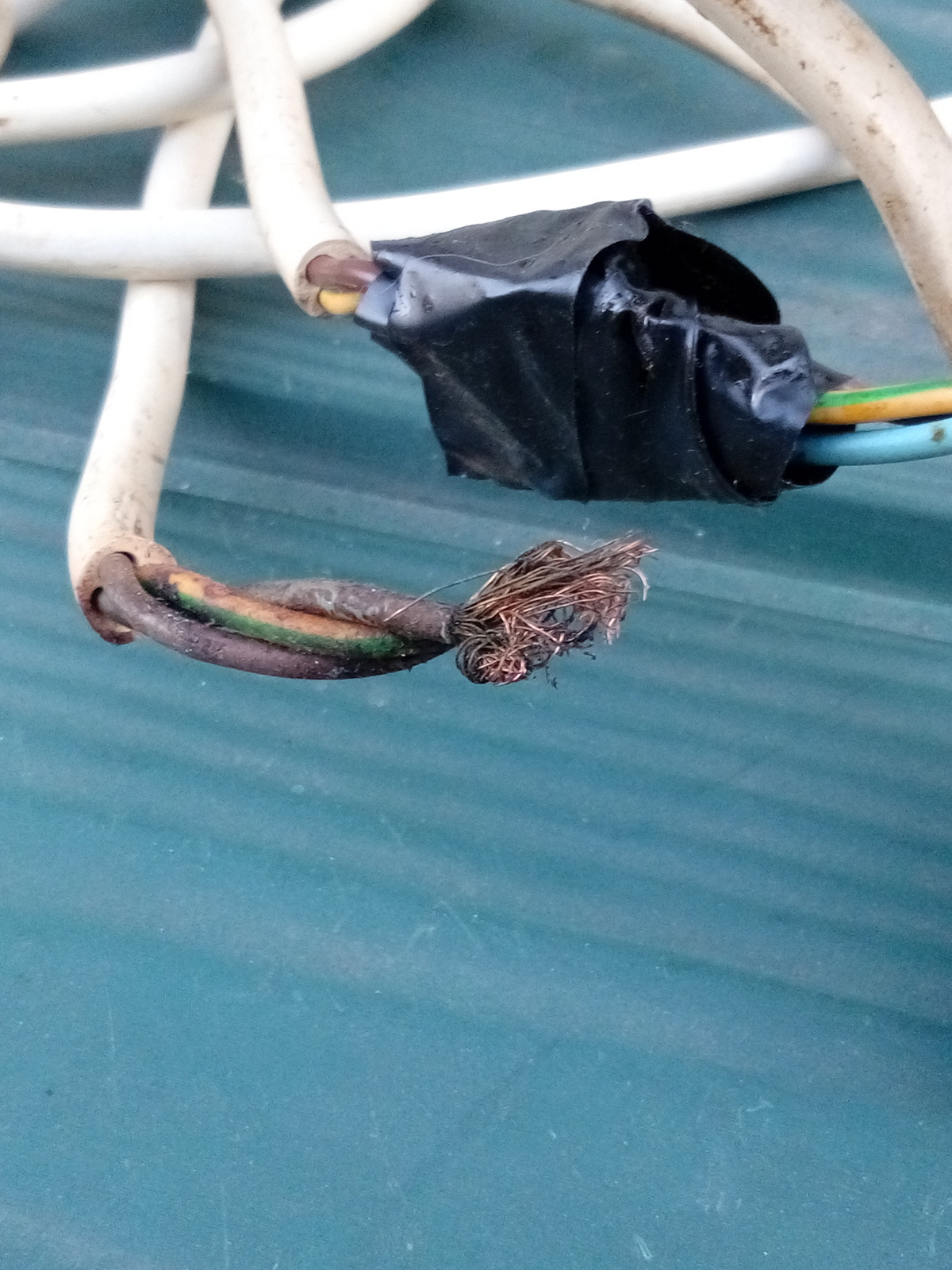

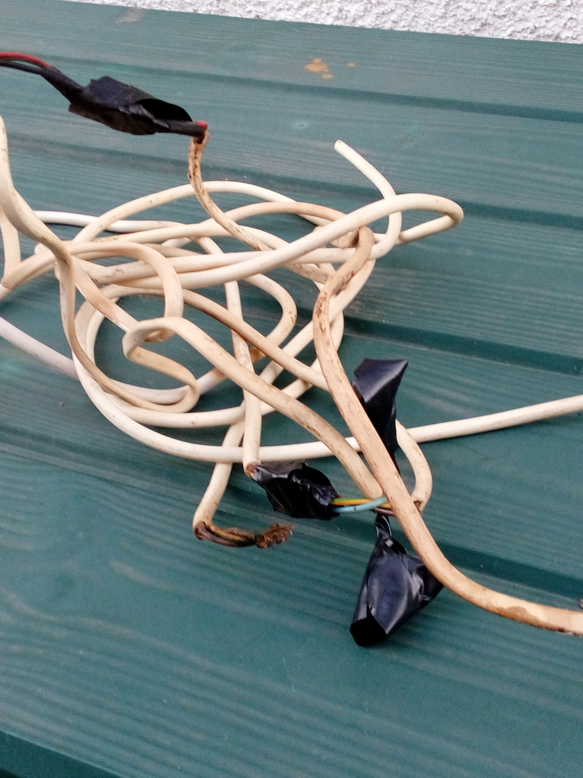

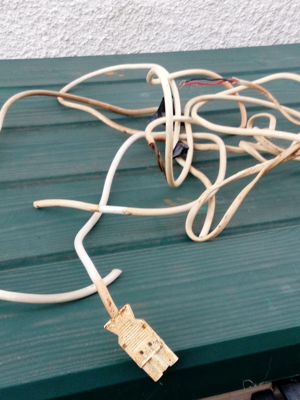

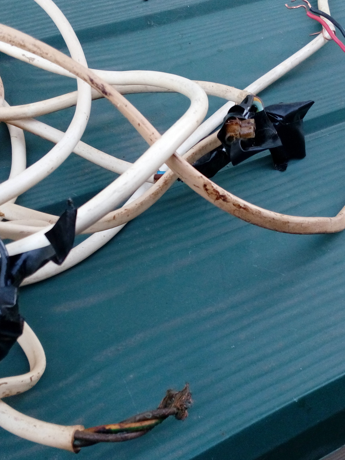

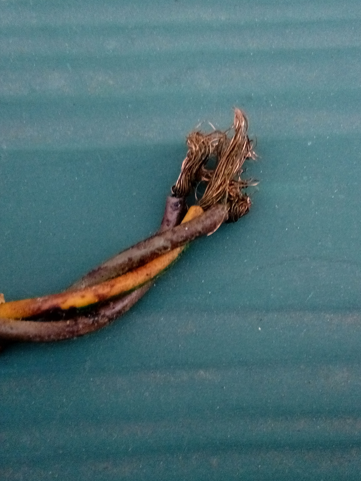

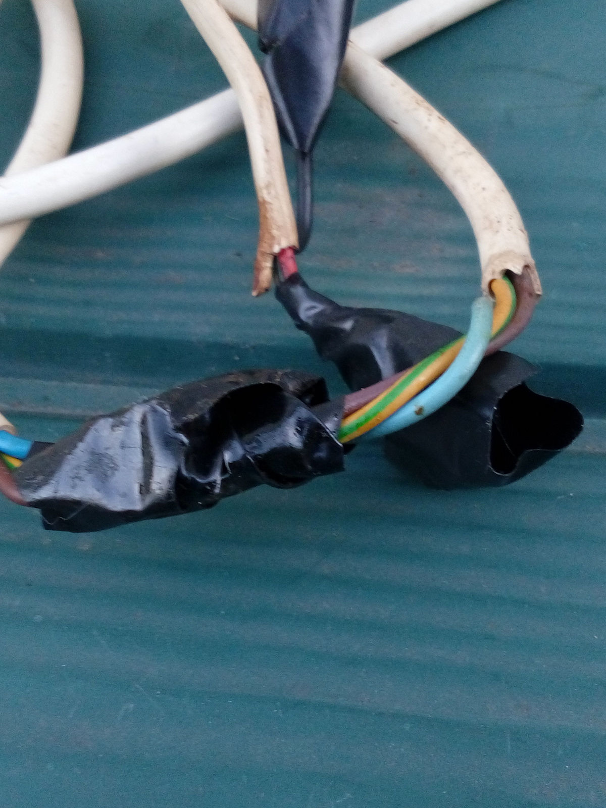

Pic's of the wiring loom - as pulled/removed by the electrician - from the top of the previous extractor hood (canopy):
Beginning to suspect that some of the posters on this thread have recognised what might be their own work - and are covering/diverting with bluster???
Q: Should a competent hood install - bring this much grease/oil/contaminants so close to (and directly upon) electrical contacts that are hooked into the households mains? Why is there any grease on the loom at all, if the install was done right?
The loom you see here, drew its power from a plug - plugged directly into the a socket whose location can be seen in the initial pic's.
Make up your own minds.

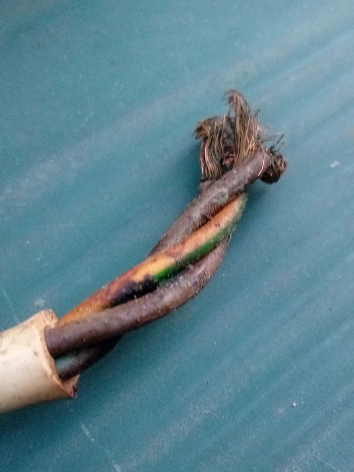

Firstly, you said it was singed.
Secondly, if it was just 'on top of the hood' then I would get onto the cleaner. The tops of kitchen wall units will be covered in grease after a few years, let alone twenty, if you don't clean them. That's just how it is.
Perhaps some of them - how many do you think helped install it? - are recognising customers they don't bother with any longer.

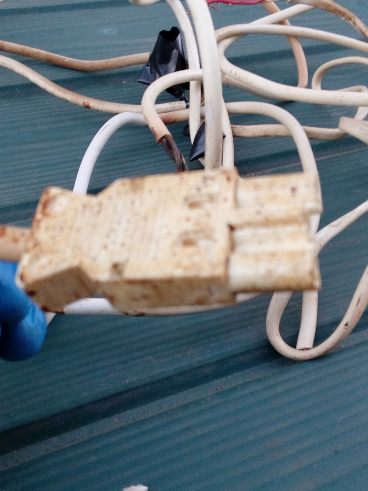

So - where did the grease come from? Did the electrician install it in that condition?
If not, then it must be yours.

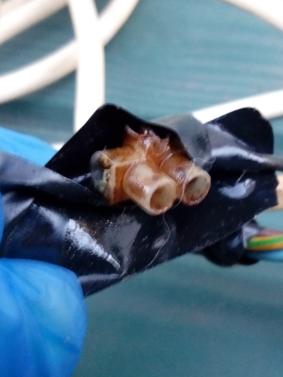

I will admit it seems ridiculously long and that gooey tape should not have been used.

That quantity of cable was obviously for rather more than just an extractor, and the various taped connections are clearly unsatisfactory.
There is some oil/grease - but not really surprising if that lot has been on top of some kitchen cupboards for years/decades.

There was a wall, a hole, and the original wiring loom. There was a socket - that when opened - had grease inside.
He went to the fusebox first to isolate the kitchen. He decided to have a look inside the fusebox - to ensure there were no issues in being able to isolate the kitchen ring. He found the kitchen and convservatory were on a radial only - hooked into a 30amp fuse - and that the existing wiring was not rated for that.
Then - in the kitchen - He inspect the loom. Told me the edges looked signed. Inspected the connections - asked me what might have caused the grease contamination of the contacts.
I explained at the pipe was not sealed to the extractor hood (previous one was the thin plastic flexible type) there must have been some blow back on top of the hood withing the confined area of that box - thats why - within a sealed/closed cover box - grease somehow coated the inside of the sides and the top of the unit.
He removed the loom, changed the socket, front plate and back. He attached the gland and wired it up.
He then measured and fitted the extractor to the wall.
He then taped the collar to the reducer. Fitted the reducer. He then bent the pipe - test fitted it - and then made the seals good.
He then went outside and cut off the excess pipe.
He then went to the fuse-box and took a closer look for any other problems as to other areas of the house.
I repeat - the extraction hose was not sealed to the canopy using any tape or seal. The top of the extractor was obsured by a panel - so we could not see it. We 'trusted the trades-person - would not put us at risk'.
And I also repeat - if it was a decent extractor hood with a decent filter that was properly maintained, nothing but relatively clean air should come of the unit into the 'hose' - so even if it was not sealed, that in itself should not result in much grease 'escaping'. Let's face it, 'recirculating' extra hoods don't even have an 'extractor hose'.
The tops of kitchen cabinets get 'orrible and greasy/filthy after a few years of neglect, so I don't think that 'behind the panel' is any exception to that. It's an environment where regular thorough cleaning (and not just of the bits that are obviously visible) is essential.
