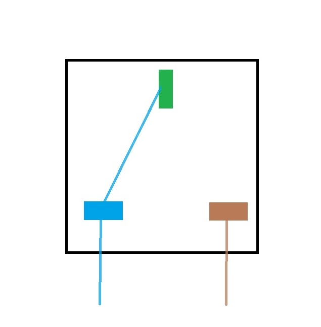

I.e. You have a very odd socket that is not earthed, but has the neutral and earth terminals joined together. On first glance, that socket may appear to be ok and pass it's Zs test.
Assuming you're unaware of the fault and thus have not done any of the following;
  • A R1 + R2 test at the DB with the joint/link at the defective socket, what would hopefully show ∞Ω
  • A N-E IR test initiated at the defective socket what would show at or very close to 0Ω
How do you catch the above fault without manual inspection or an RCD test if the Zs reading you get is within the range your expecting and similar to other sockets?

This is what I mean by the way:
Of course you could check the continuity of the earth in question against a known earth, and risk tripping the RCD if you cause a large enough current shunt through the true earth.
If it is a TT system, you would also discover an unusually low Zs for being it is a TT arrangement such as by a advanced socket tester with a built in loop check.
What exactly (if anything) are you suggesting that the CPC(s) would be connected to?
Nothing, as in some one has installed a socket with 2 core cable and used the neutral to provide a link to the earth terminal of the socket.
Hmmmm. Have you ever seen, or heard of, a case in which that had been done?

Not only unlikely - it's impossible if the required tests are done.
Ultimately the only circumstances in which someone could do an EICR without identifying such a blatant defect would be if they were totally incompetent, completely missed most/all of the testing and then completed the report with purely fictional information before riding off into the sunset on their horse.
