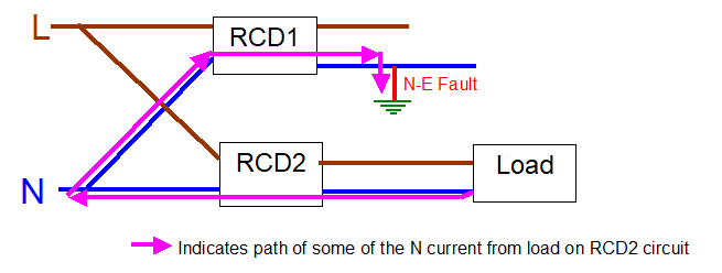

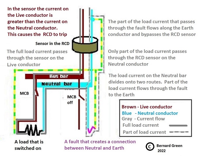

I am not sure I do remember that. Please remind me how that works.
Some of the N current from a load protected by 'the other RCD' goes 'backwards' through the RCD protecting the circuit with the N-E fault,hence creating a current imbalance in that RCD.
Following logic, would that not mean that all RCBOs would trip with every fault?
No. As above, no matter how many RCDs or RCBOs there are, the only one which will trip is the one protecting the circuit with the N-E fault (the L and N currents in all the otheer RCDs/RCBOs are 'balanced).

You probably touched earth with the neutral wire - which will trip the RCD if something else on the RCD circuits is using enough current.
So, if there are no non-RCD circuits...
You 'corrected' me by saying the same as I did.
I didn't 'correct' you. Starting my reply with "You probably realise this, but ...", I merely pointed out that the load causing an RCD to trip (when it is protecting a circuit with an N-E fault) does not necessarily have to be on a circuit protected by the same ('tripping') RCD, since I was not totally clear as to what you meant by ".... something else on the RCD circuits" (I wondered whether the final 's' of that may have been unintentional).
The 'something else using current' could be anywhere; not just on the RCD circuits.
Sure. The current in any circuit can cause the RCD (or RCBO) protecting a circuit with an N-E fault to trip (by the mechanism I described).
In fact, as we've also discussed in the past, I don't think the current even needs to be in the same installation - I need to re-think to be sure, but I think that a load in a neighbouring property can also do it, since part of the neutral current from that load will also 'go backwards' to earth though thee RCD protecting the faulty circuit.
Exactly - as above. Also as above, probably also if ther are no current-drawing loads at all in the installation (but some 'next door')!
