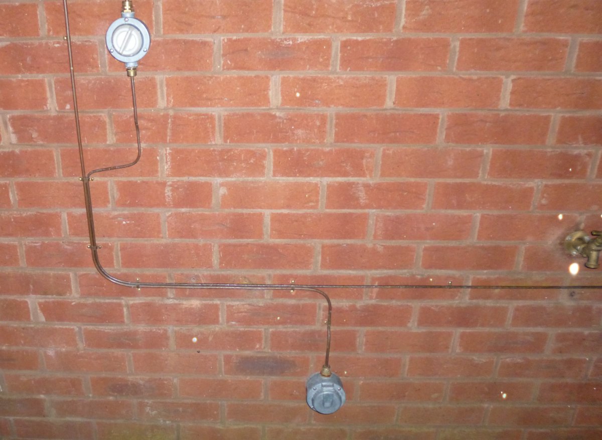

Not my photo, this is from the pyro master @RF Lighting. I'm sure he probably has better examples he could show you.
full

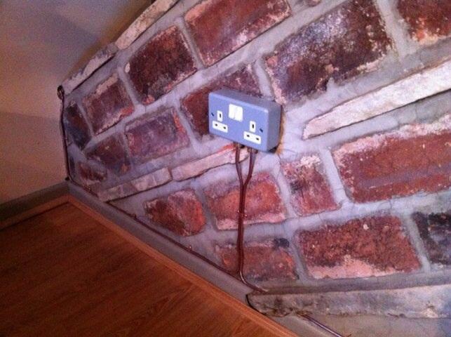

It's a great wiring system, the cables are very compact and discrete compared to other wiring types. Installed properly it should never need replacing. I stuck some round the side of my house for a socket and lights. (photo not good in the dark and rain:( ) Roller straighteners at the ready!
