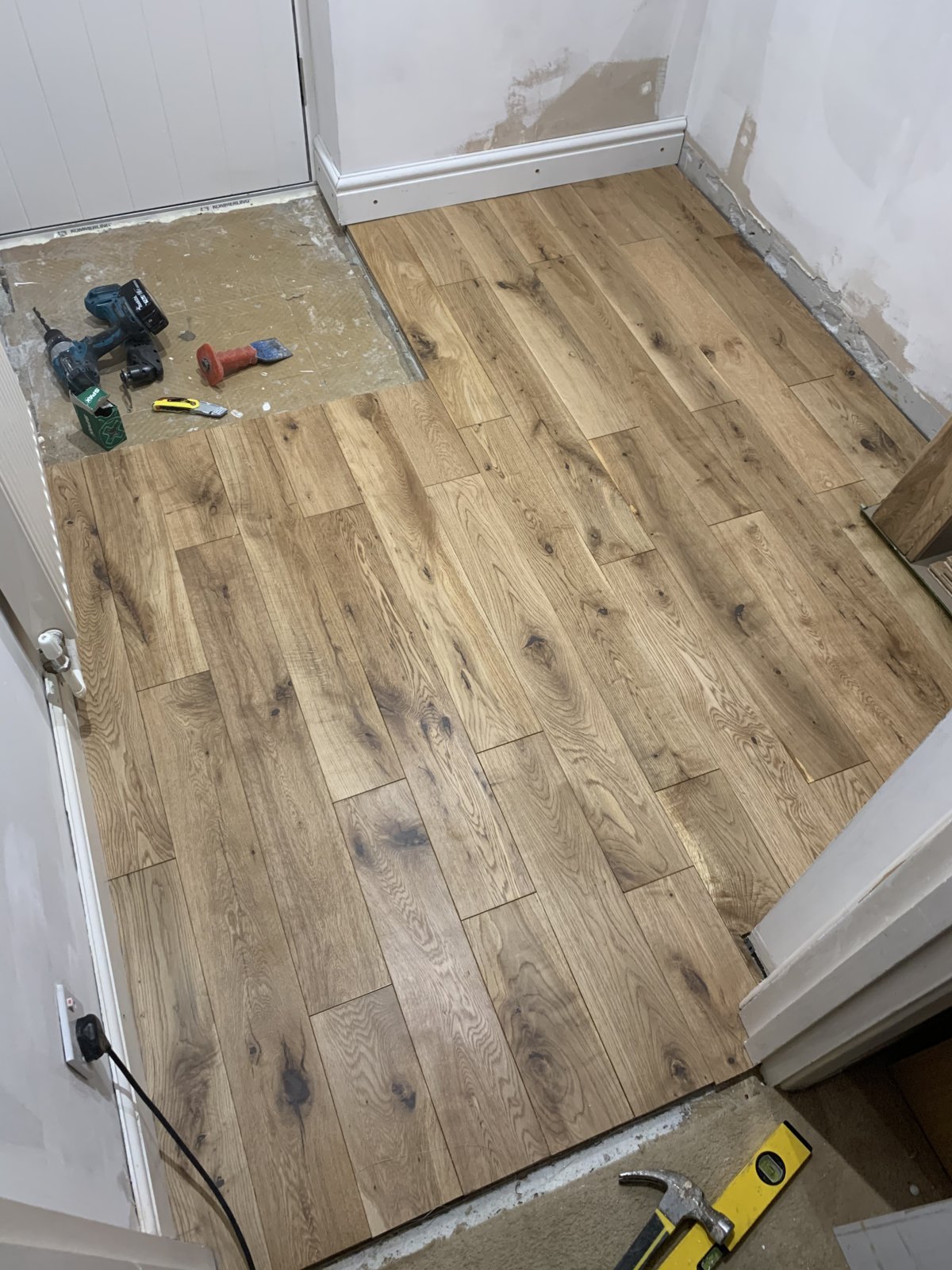

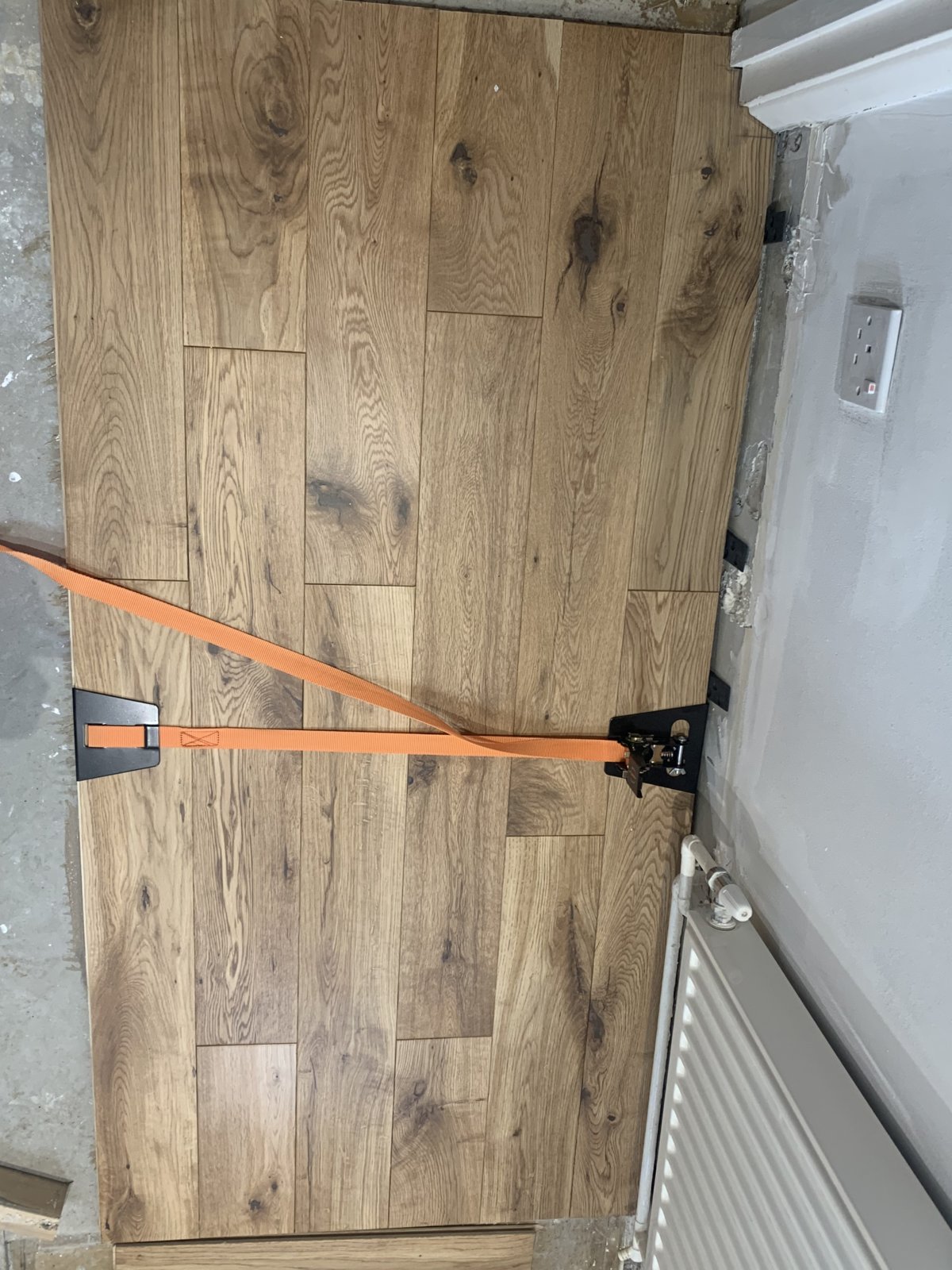

Think I might have buggered it up, left the flooring in the room for 5 days before laying it, left expansion gap all round (10mm) and used a flooring strap to pull it all tight.

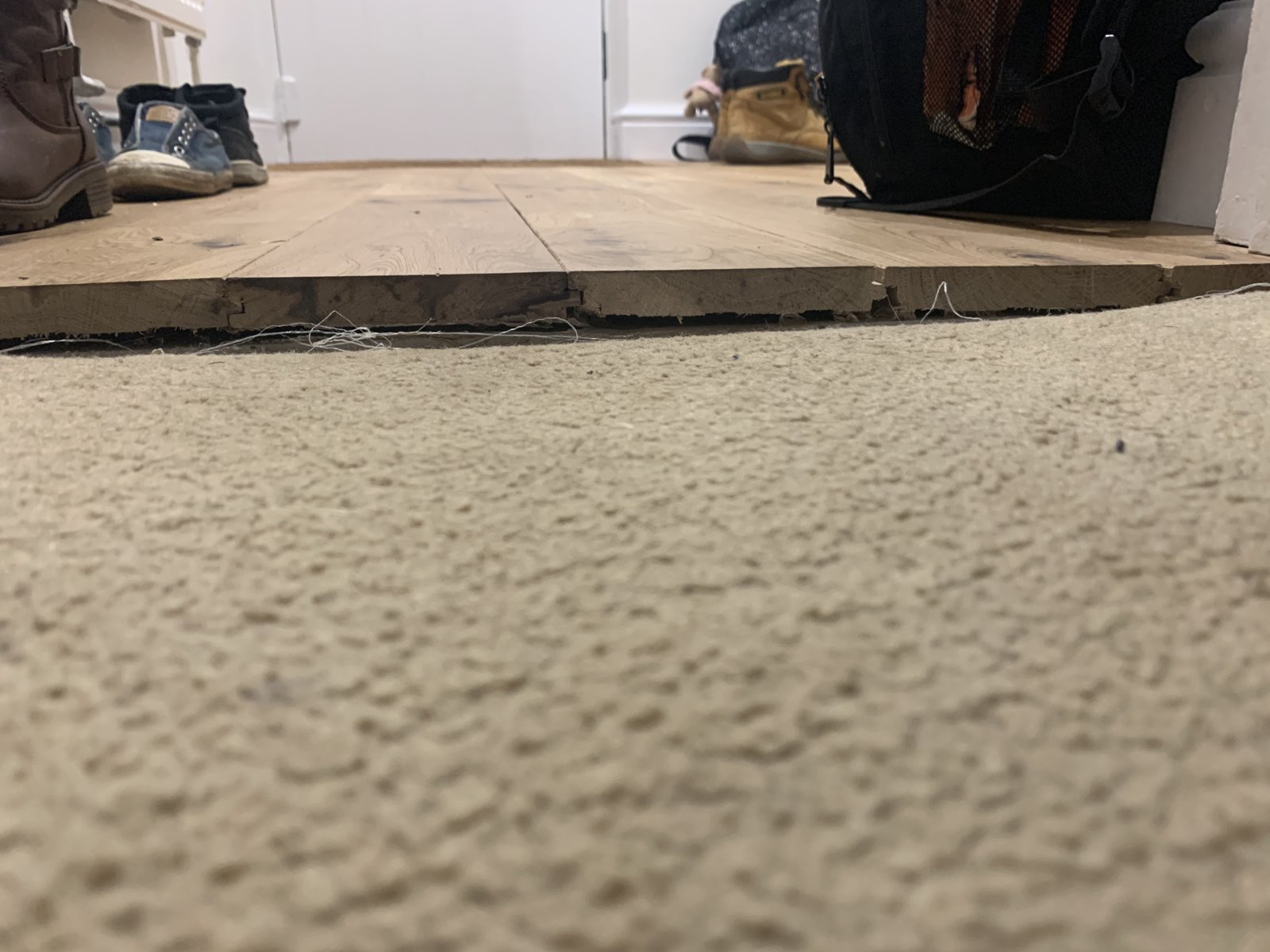

Everything looked fine and then today when I got home the middle has lifted slightly, the room has just been painted and I’m not sure if this could have created any extra moisture?
I laid it Sunday, Monday & Tuesday I had a decorator in there and I didn’t notice the issue until this evening - does it take a couple of days to settle?

Did you under cut the doorstops and door liner, if not maybe not enough expansion there
Yes I used a multi tool to cut the door stop and door liner.
It seems to have settled down a bit now but at it settled it’s moved / expanded which I guess it would do as it’s wood!

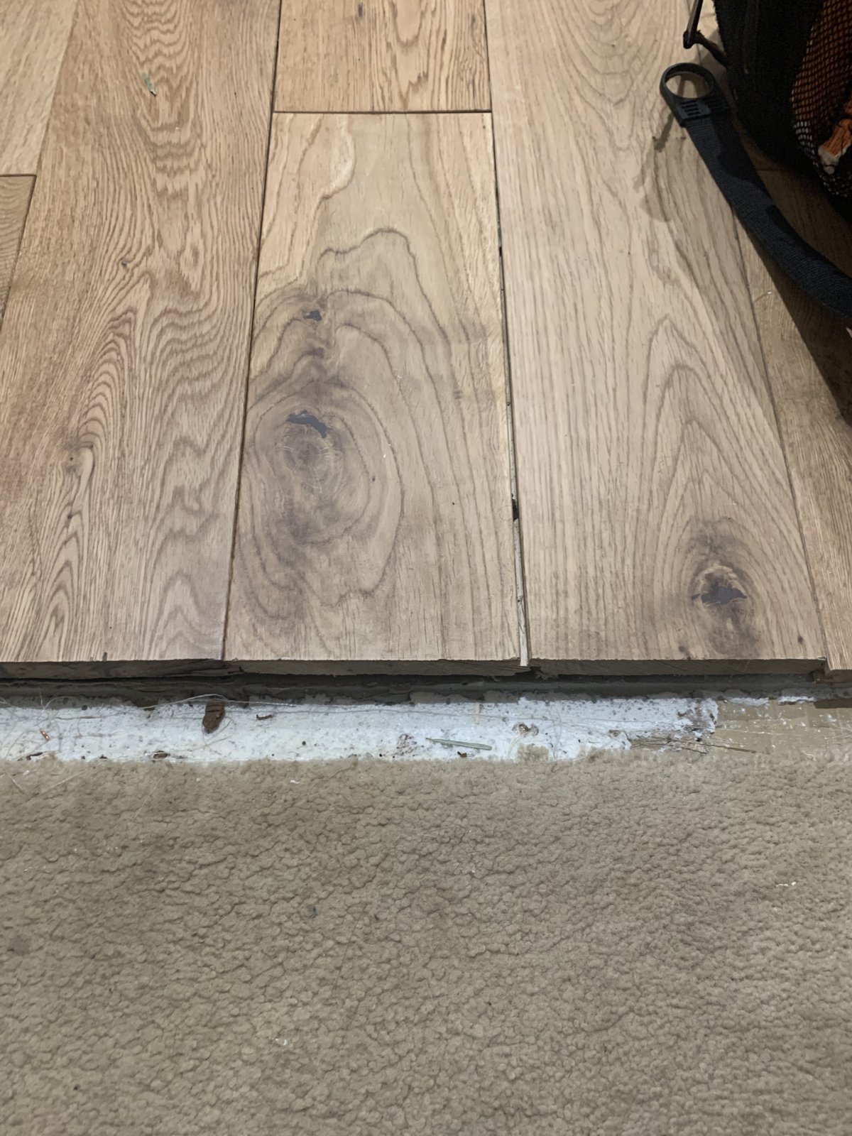

is there anything I could try to do to resolve this piece of flooring - see picture 1

looks like the gap has opened and a bit off black crud has fallen in ??
Basically yes, there’s nothing I can do about the gap opening up I guess it’s just bloody annoying as your eye is drawn to it
