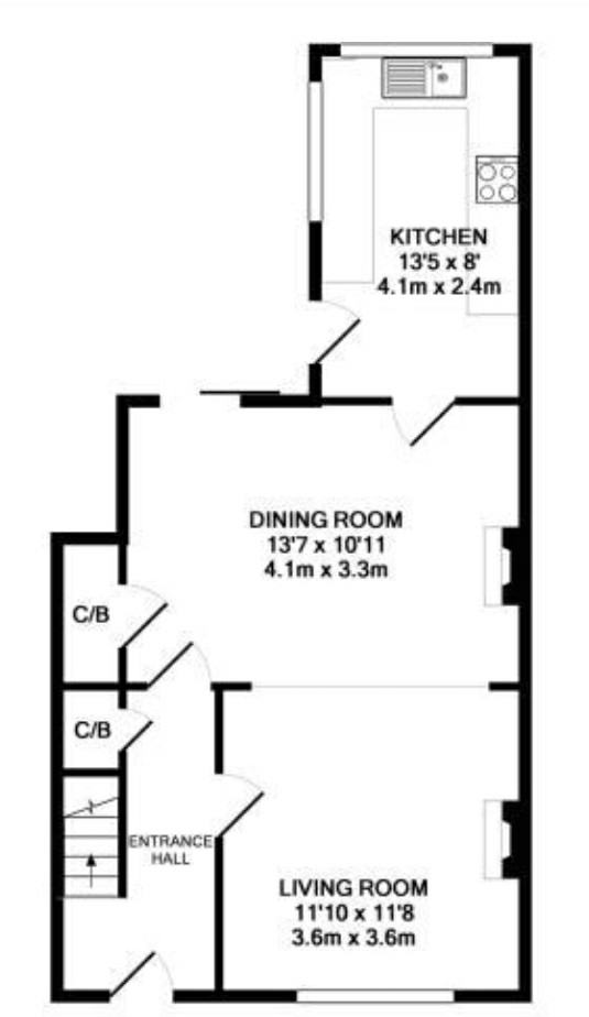

Considering purchasing a detached property with a view to carry out a rear 8m extension
I am not sure whether the kitchen is part of the original property as the kitchen roof is tiled whereas the actual house has a slated roof
Is there any way I can verify if this was part of the original house or carried out later and if so will this affect me from doing an extension?
I want to square off the rear but also extend it further beyond the kitchen to the maximum 8m allowance
Would I still be allowed to do an extension under the PD rules if the kitchen extension was added after?
Also I have noticed the manhole and 3 other drains fall within the area where I intend to extend and a garage which also has a drain which will also need to be knocked down to make way for the extension
Moving the manhole and drains is this likely to be a straight forward job without being to costly?
Pic of current floor plan attached
Cheers

You could search the planning portal, it may well have previous applications -older apps only have the consent letter or nothing!
Regarding knocking down to the original house to gain PD rear extension rules: I dont know, hopefully a pro will be along soon.....
8m is a neighbour consultation anyway so you cant assume it would get approval.
Drains: if private, do what you like (but still to b/regs), moving is usually poss with being a dealbreaker. Public drains not so easy. Impossible to know without having more info

Wasn't thinking of knocking down the kitchen but rather extending it further back to 8m and squaring it off at the rear, would this be possible or would I need to demolish the kitchen?
How can i determine the layout of the manhole and drains and whether they are public or private?

Technically, you could not do the 8m extension under permitted development by enlarging the existing kitchen rearwards and sideways - daft as it sounds.
The reason is that the neighbour consultation scheme is not retrospective; in your case a considerable part of the proposed 8m extension would already exist,
so an enlargement under this scheme would not be allowed. You would need to demolish the extension first, but subject to......
An 8m extension could never be permitted development if the extension, or any part of it, was original to the house. This is because you would break the rule that states 'an extension is not p.d. if it extends beyond an original wall forming a side elevation of the house and is more than one-half the width of the house'.
So assuming the extension was not original, the wording of your application could be something like; 'demolition of existing non-original extension and construction of rear extension maximum projection 8m, max eaves height 3m, maximum overall height 4m'.

If I've understood correctly if turns out the kitchen is part of the original house could I then extend it out and square off to 8m via PD?

Ah ok, if I were to go via the full planning permission route that would work? with out having to demolish the kitchen and start again from scratch
Yes, you would need planning permission for that. Whether or not it would be approved would depend on the councils' planning policy for domestic extensions.
