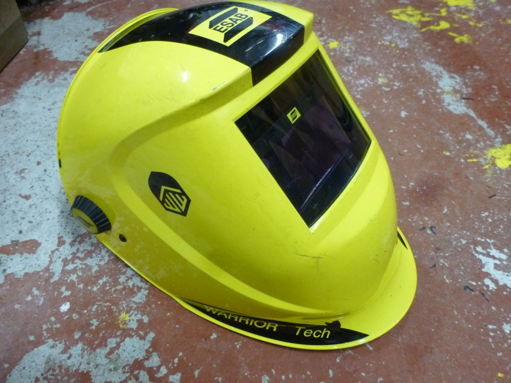

Hi,
I'm looking for an auto welding mask, to replace my existing Esab "Warrior" that has now died. That cost £60 +VAT in 2014 so my thinking is that for the same sort of money i should be able to get something better ("true colour" for example).
Any recommendations? It would need to have replaceable battery, and preferably able to take a "cheater" magnifying lens.

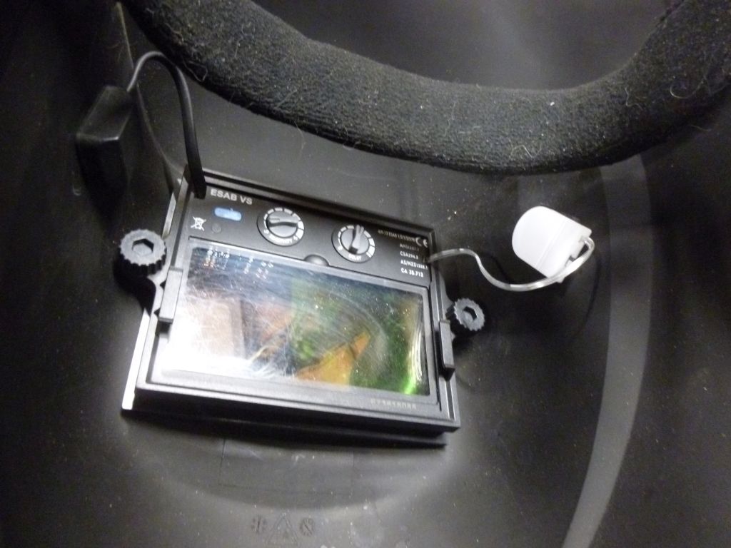

Is the old helmet actually broken or does it just need a new battery?
This is a "dead" one I mended/modified for a friend:

I think it's goosed. Wiring in a new battery looked hopeful at first, but it still flickered and now doesn't work at all.
Turns out it's not dead. I had already ordered a battery holder before I decided it was a lost cause. So once the holder turned up I fitted it, for the sake of five minutes soldering. And it works. To start with the same sort of misbehaviour, for example darkening when looking near the flourescent tube but clearing when looking straight at it. Fiddling with the sensitivity got it working consistently again. Now turning sensitivity through its whole range it doesn't misbehave.
I have no idea why it didn't work with the improvised battery connections. I measured a good steady 3.3V at the pads on the PCB so it was certainly making contact.
