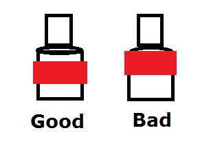

reducer straight in compression fitting?
Nothing wrong with 3-piece red sets. It's the 2-piece ones that are cr@p.
Will they not seal if the reducer is pushed all the way in?
Depends on the length of the spigot and the depth of the stop in the comp joint.
The olive needs to be on a flat surface, away from the shoulder of the reducer.
And does it not matter that the reducer isn't pushed all the way in to the fitting as its the olive that seals it?
Correct. so long as the oilve has enough flat surface to seal/compress on to.
