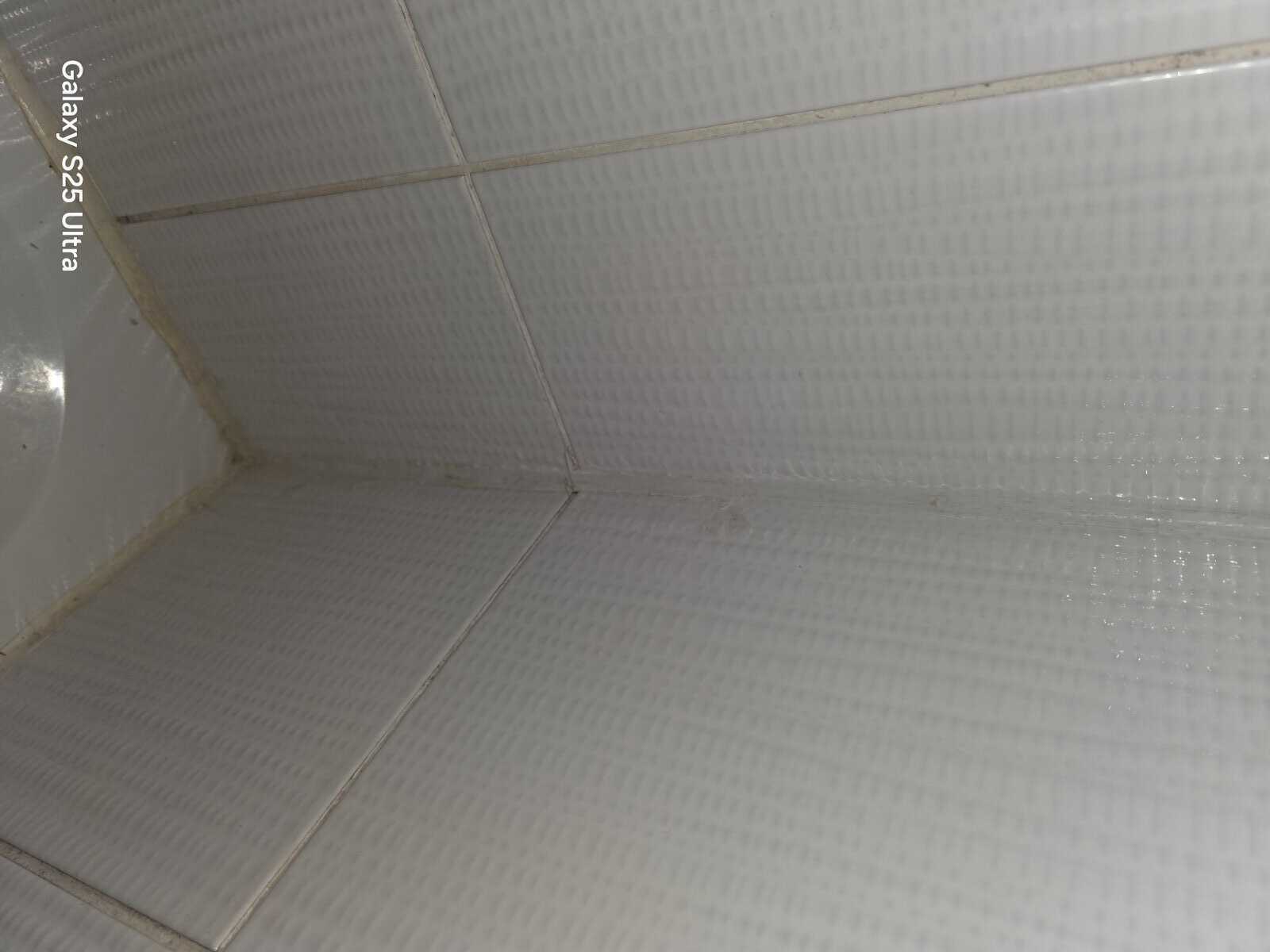

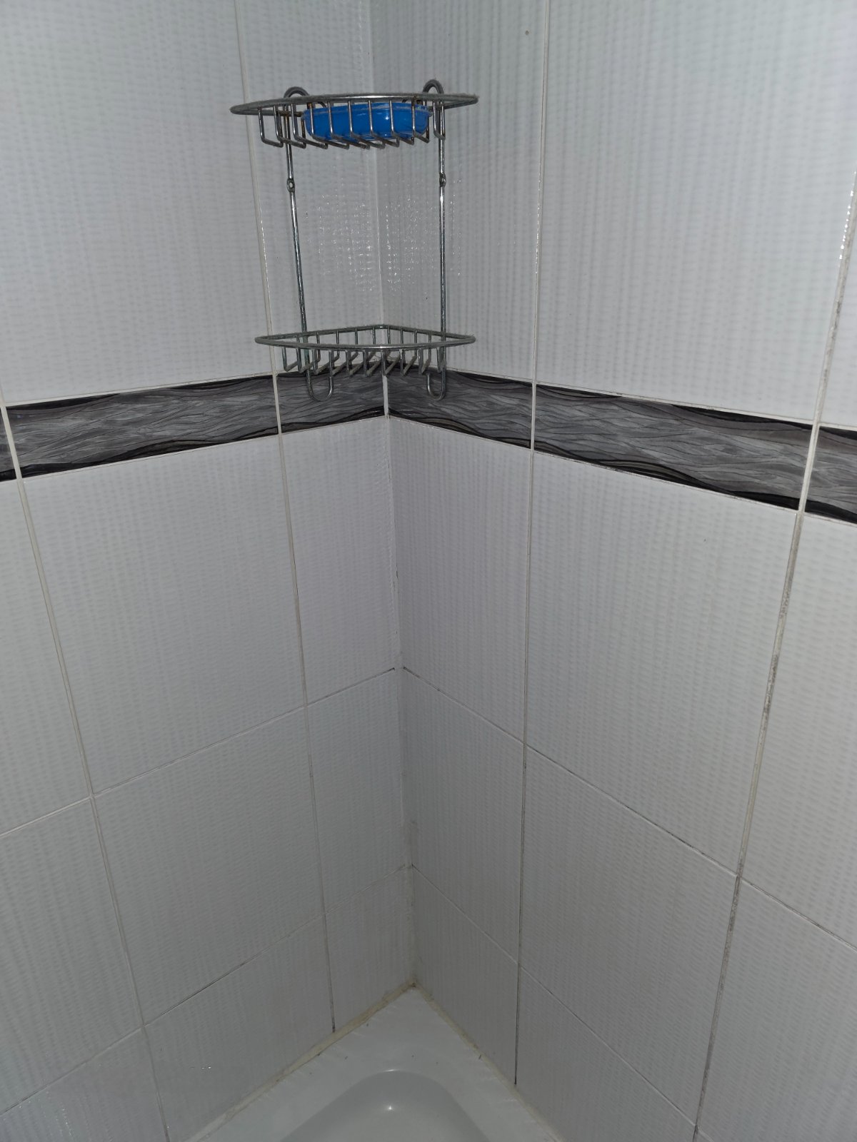

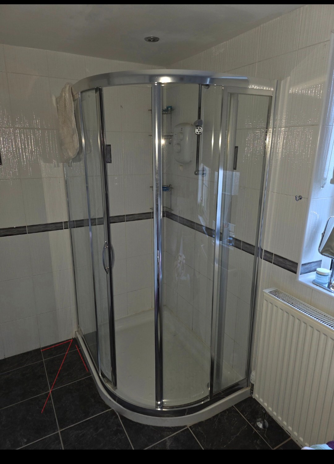

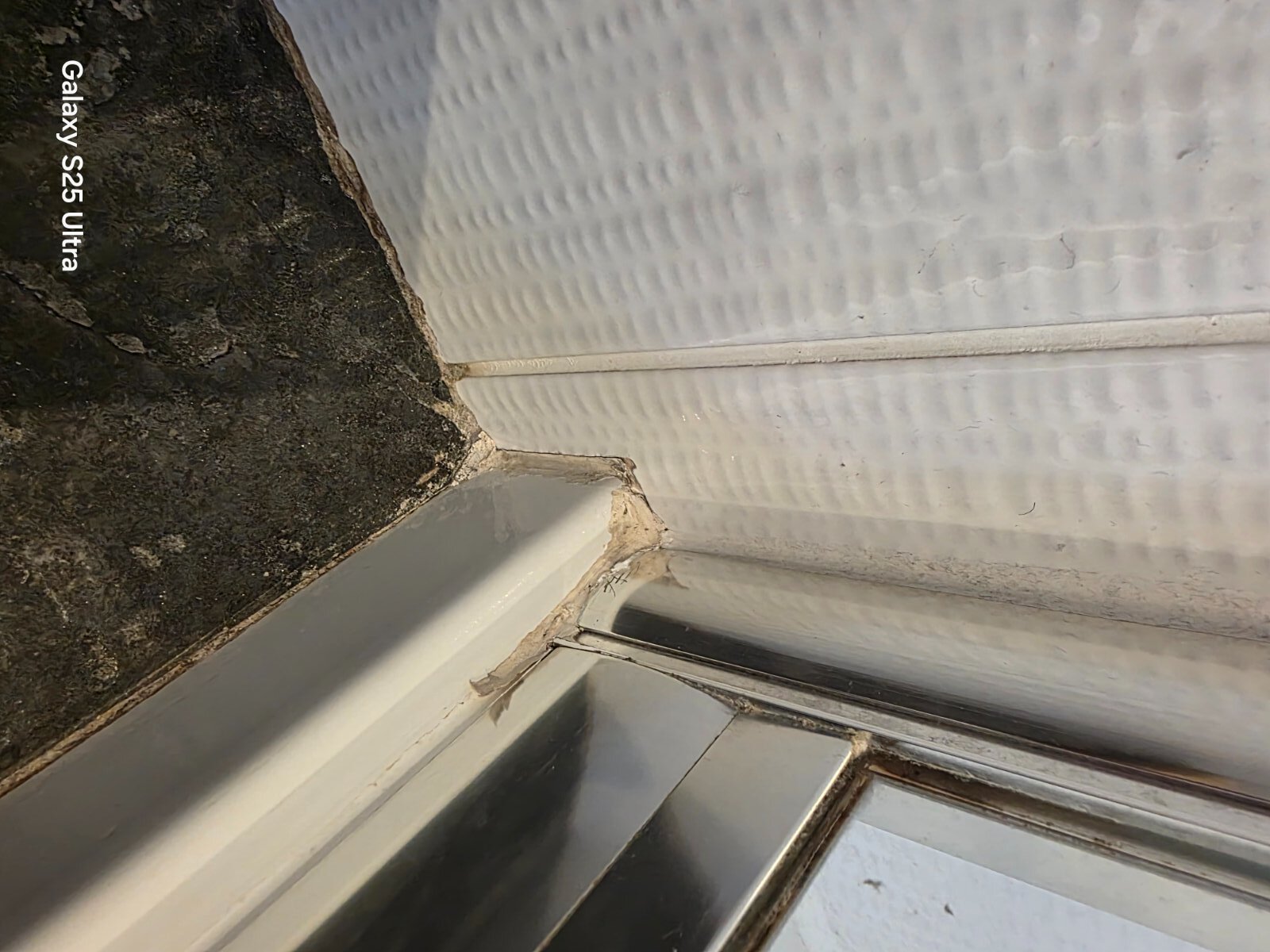

How long would it take a Tiler to properly regrout (remove old grout and reapply new grout), as well as remove old silicone and re-silicone within a moderately sized shower enclosure, approx 118cm L x 90cm W x 220 cm H?
Pictures also attached.

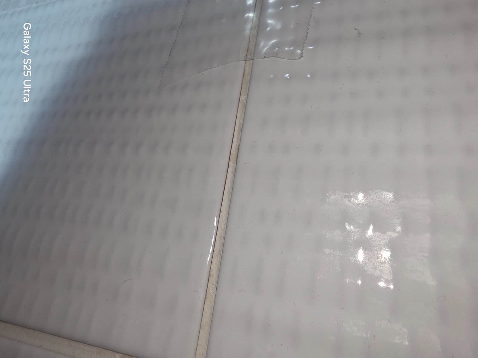

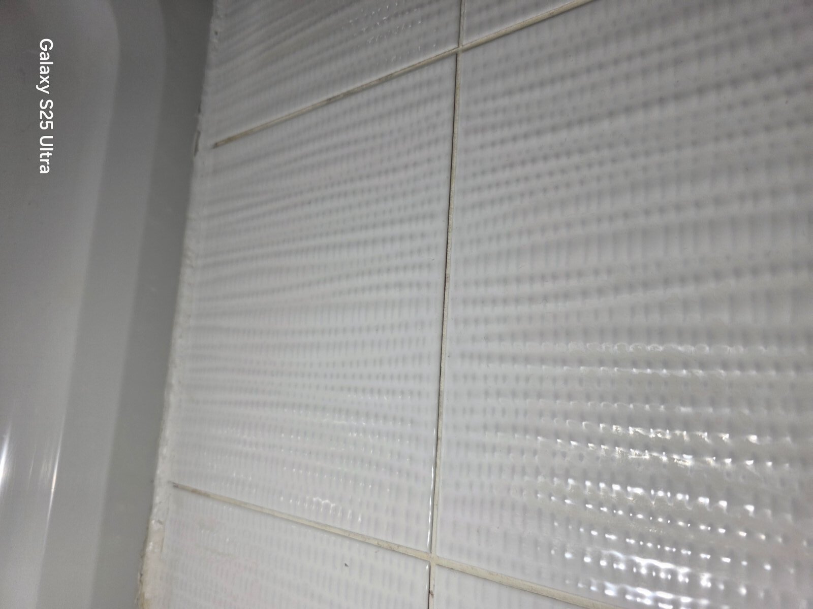

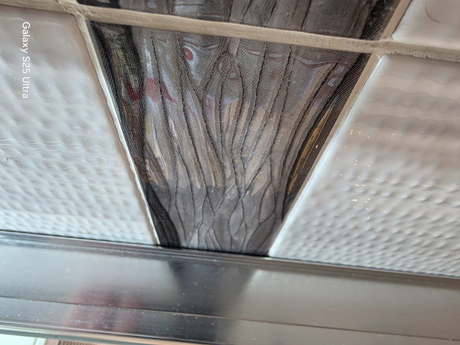

If only a few of the tiles show hairline cracks (see pictures) would you need to get everything regrouted, or just around those tiles?

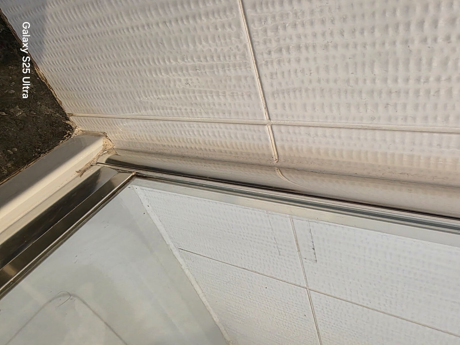

Main issue and reason for the work are 2 small corner leaks (wet to touch but not drippping wet) on both sides just outside the enclosure where there is some silicone around the bottom outside corner cut tiles.
I've been quoted £250 to get this work done by a tiler (via MyBuilder), but he's only planning to set aside an afternoon to do the work, with another job in the morning. I had assumed he quoted me a day rate or close enough
Im worried he's not going to have enough time and will inevitably rush the work and I might end up still with the same problem if this is the case.
Would you expect this work to take more than an afternoon and ideally should I insist on the silicone work being done 24+ hours after any grouting work so that it properly sets and seals?

Removing the grout and silicone is the best part of a day.
You can't grout and silicone in one day.
That's what I was worried about!
And how can you silicone around fresh grout?
At some point they need to meet and surely the silicone won't stick to the grout.
Although in saying that, a few of the other tilers I spoke to also seemed to suggest grouting and silicone the same day.
Not sure if they were thinking more along the lines of cleaning up the grout and applying an expoxy-sealant without needing ro do a full on regrout.
A lot of tilers / tradespeople must be doing this though, so I wonder how bad it could be in practice?
Is there not fast setting grout which a lot of tradesmen would use to avoid having to extend the job over 2 days?
One of the tilers I spoke to said he uses Bal grout which is used in swimming pools apparently. Although quick search seems to suggest a 24 cure time for this. Would this mean you'd only want to apply silicone after it had fully cured (or is that more for wait time to actually use the shower)?
He also uses this silicone from screwfix, if thos make a difference for using mext to fresh grout?
No Nonsense 820 Sanitary Silicone White 310ml
Any advice on this would be much appreciated as really dont want to end having to get the work done multiple times if not done right first time!
I would never tried to grout and silicone on the same day.
It might be the case that the guy only intends to remove a couple of mm of grout though, in which case, it might be ok to do both in one day. Ideally, as much grout as possible should be removed (at least two thirds of the depth). If your tiles are 6mm thick, that means 4mm.
I am also a ‘Bal’ grout man, and regularly use the same Screwfix N.N. Silicone.
No, you cannot re-grout and silicone on the same day; the grout has to be dry and the tiles polished+haze free before you can Silicone.
Around my way, some tilers, including myself, will not regrout Ceramic tiles. I’ll do porcelain regrouts, but the chances of regrouting those Ceramic tiles in the photos without chipping any are pretty low.
Agreed, I recently had to regrout ceramic tiles for a regular customer. I had to use a hand rake (non-diamond) teeth to remove the first 1mm, then a diamond blade in my oscillating saw. I then used blunt chisels to reduce the risk of damaging the glazed edge. PITA.
I love the customer, but hated every minute of the job.
