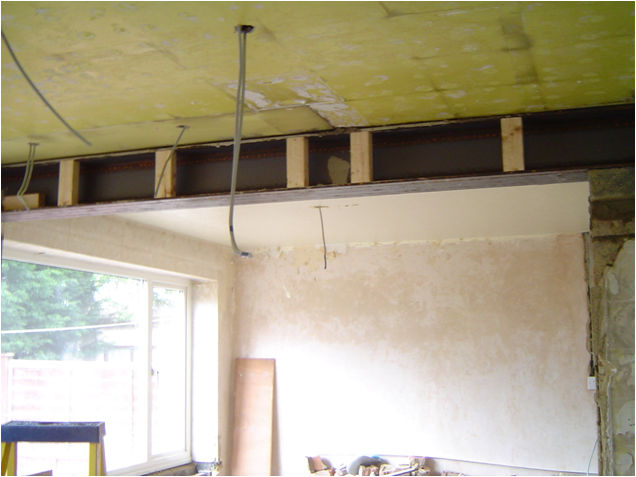

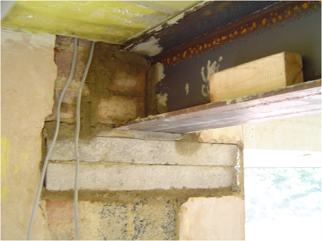

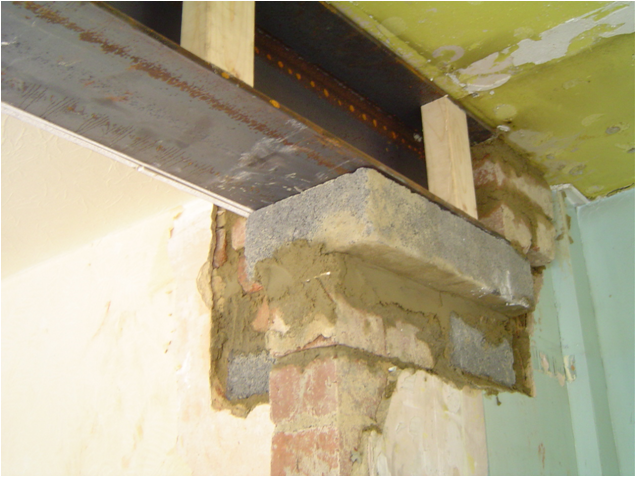

We knocked down an internal load bearing wall between the kitchen and dining room. We have a few pics of the beam installed - a builder friend came and looked yday and said that the Building Inspector(BI) may have issue with the fact that he hasn't use a padstone and also that he has used a really wide steel beam - the BI might say that as it is wider than the thickness of the original wall it sits on it could tip either way. He did say that the other connection at he external wall end though looks fine and is well sealed in so really the beam wouldn't have any room to tip as is tight in at the other end....
Im not aware of any calculations done at the time so literally would be showing the BI the finished pretty work and the pics that we have. The work was done 5 years ago and there are no signs of any movement.

Pic of internal edge from one side
Internal connecting edge from other side
pic of external edge
pic of overall beam

That is a 203 x 203 x 47 column section - a massive beam for a span a little over 3m.
It will easily support whatever is upstairs plus half the neighbourhood as well, but chances are your BCO will ask for calculations. It's not just the
beam, though; their checking engineer will want figures for the supporting brickwork, and also the relatively small length of wall between the
window and patio doors.
If you decide to apply for a regularization, be prepared for not much change from £7-800.
