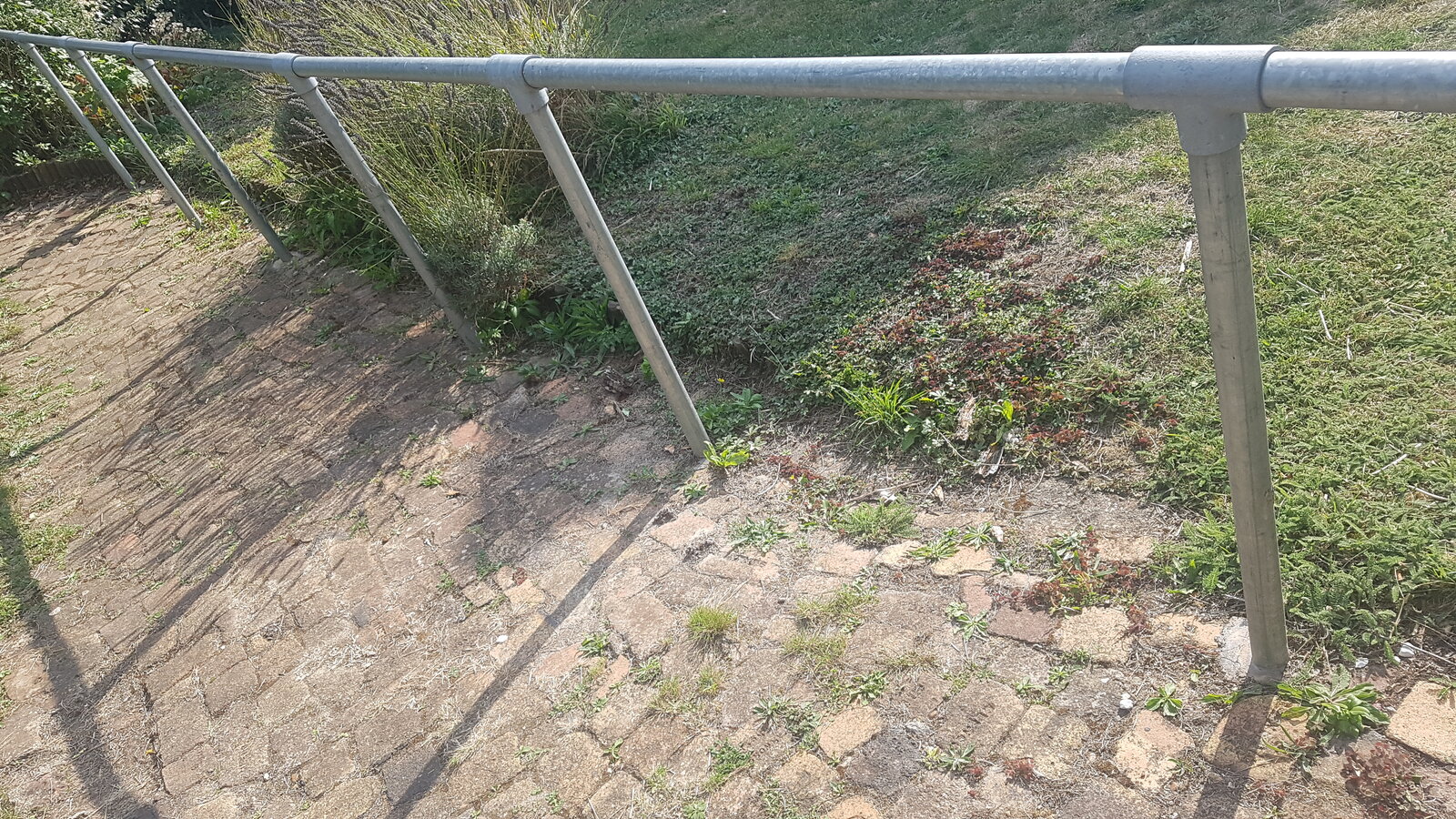

    I have inherited a railing that I want to remove.
    The posts are set solid in the ground.
    I can use an allen key to remove the hand rails and leave the vertical posts.
    Thoughts on removing them? Dig out, or angle grinder, or, try and loosen them with a sledge hammer and try to lever them loose?

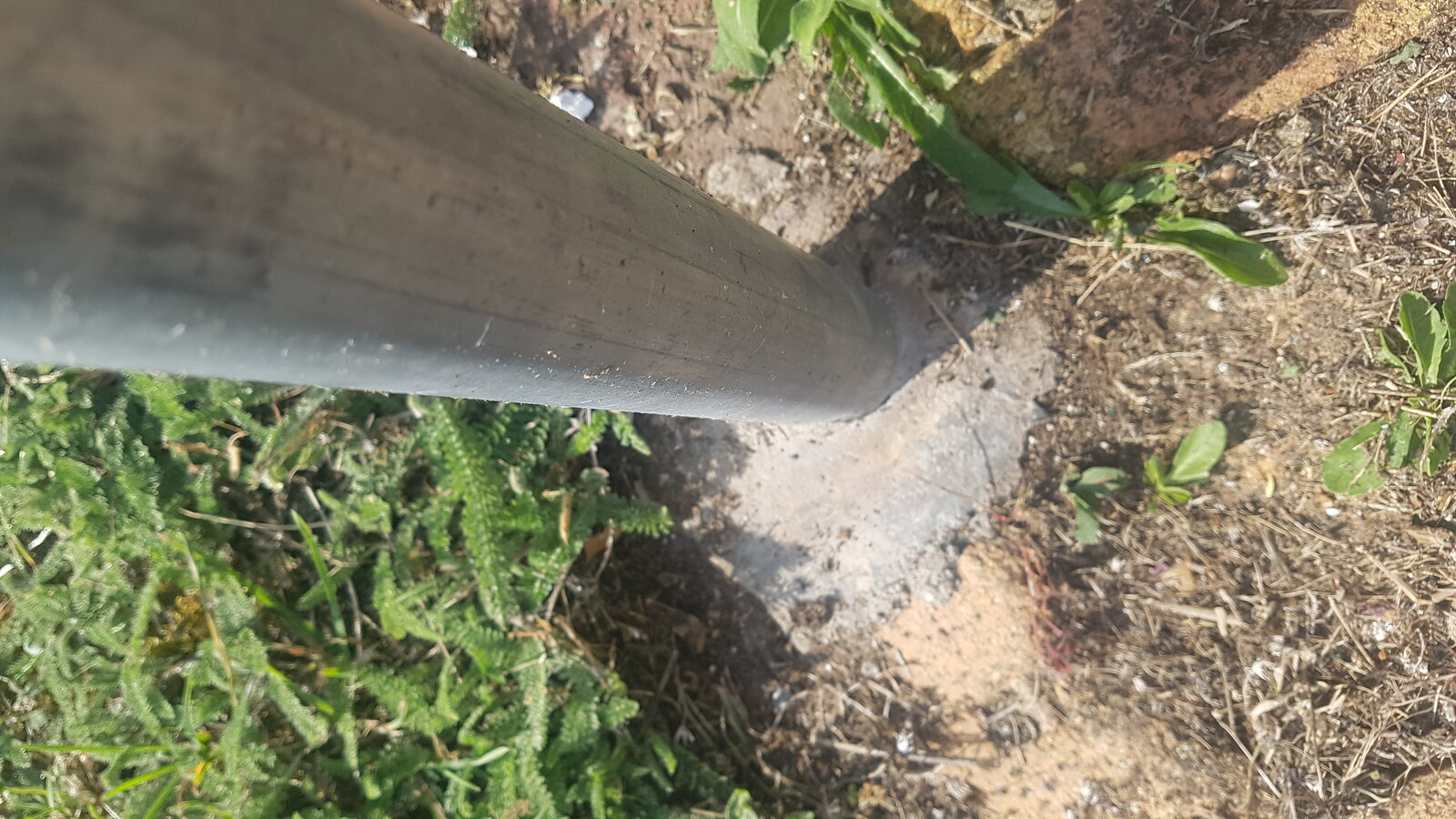

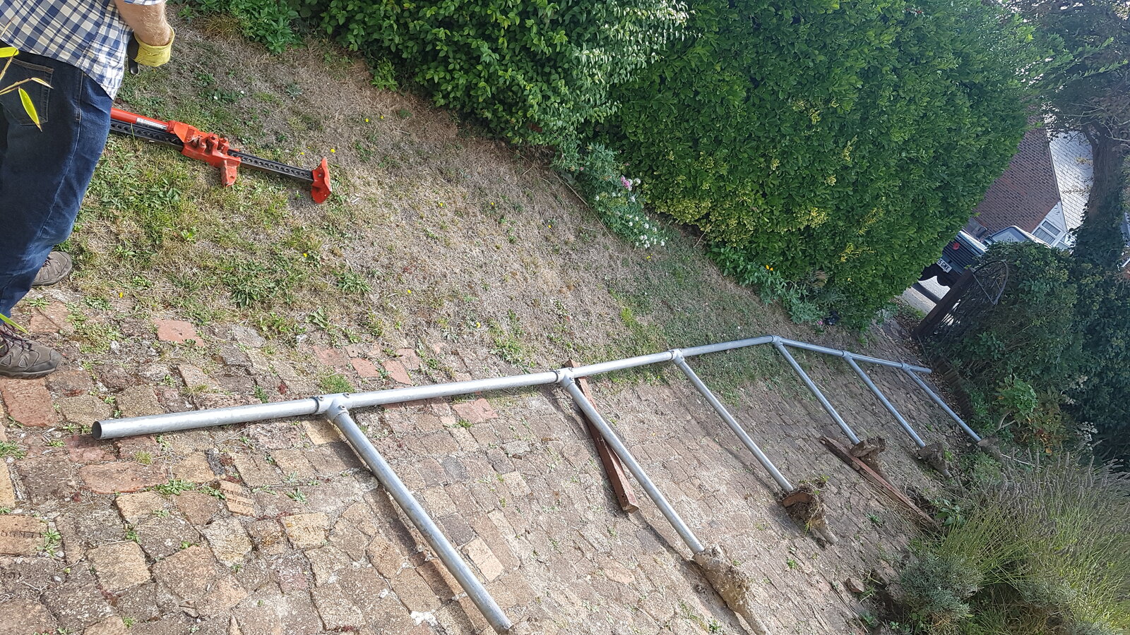

    you can use a jack to pull them out of the ground. An engine hoist should do it, with thick boards under the wheels. Americans use an agricultural jack of a type I have not seen here.
    In your case I expect each will come out with a plug of concrete, so the paved surface will be damaged but can be relaid.

    But a board under the base to stop it from sinking into the ground

    Worked a treat
