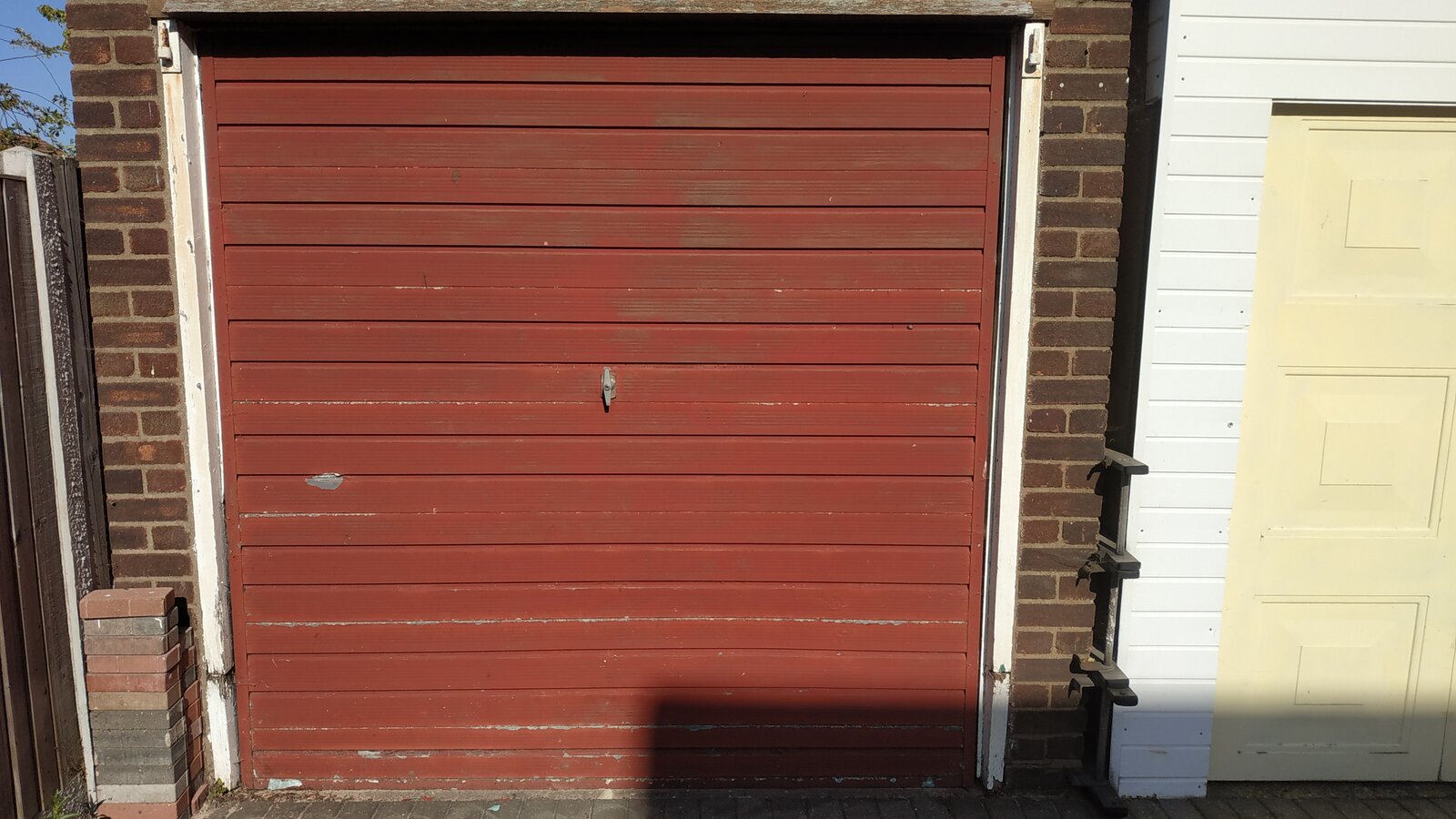

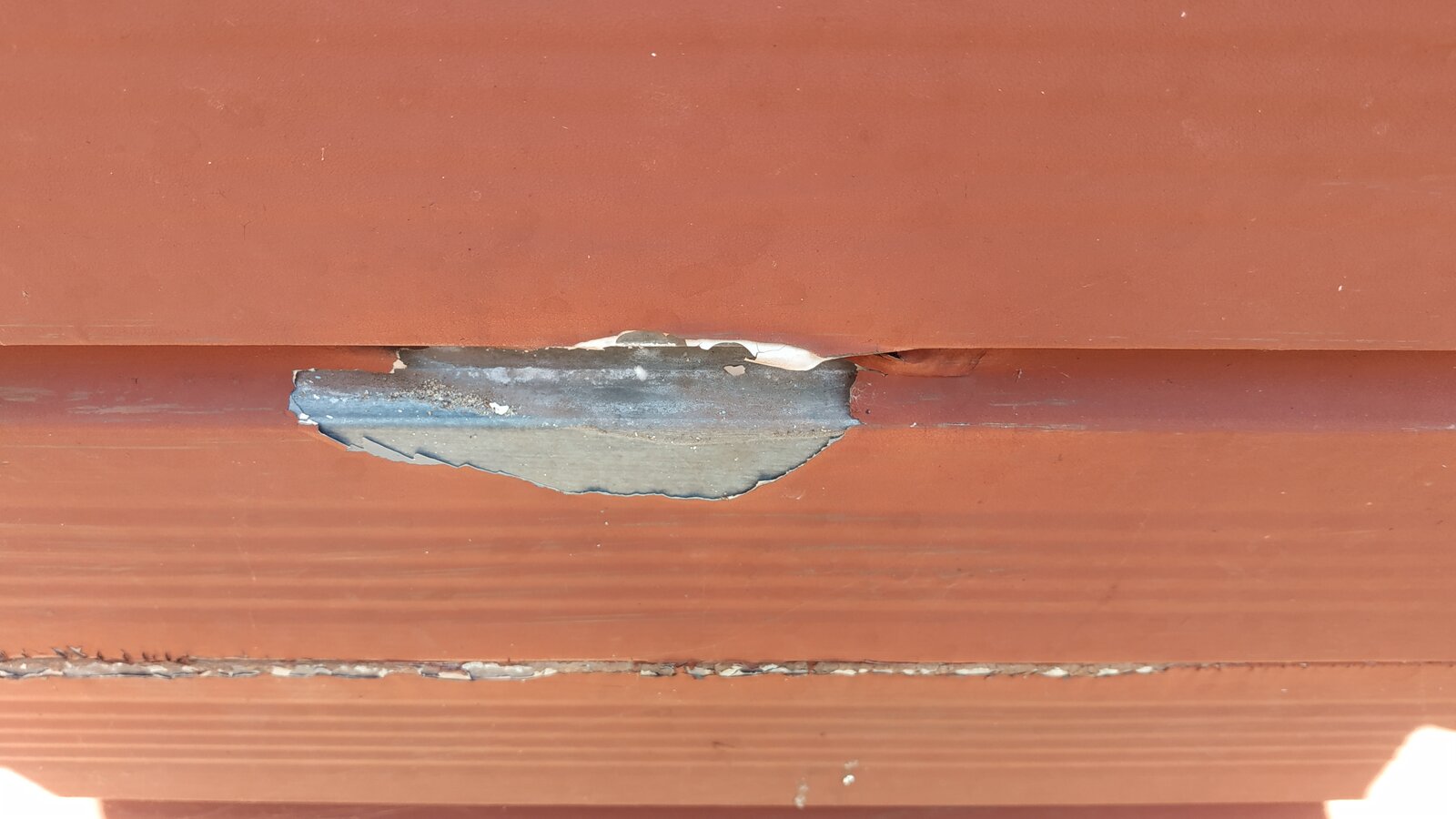

Is there a strong enough chemical to get this paint off?
I get the feeling that your usual high-street stuff won't work for this.
What would be the easiest method? Should I buy a heat gun?
I wish I could just sand it down but I don't think it will look good after I've painted it because the existing paint feels quite thick and as you can see, there's a fair bit of peeling. I have a palm sander but would that be useful?
Thanks very much and hope you can help.
Just to throw another question in, I'm sure using a chemical paint stripper will still require scraping and sanding parts down, therefore, can anyone say how this would compare using a heat gun?
Would a heat gun do the job just as well? Has anyone had any experience removing paint from metal? I don't have one but if it's going to be not much harder than using chemicals then maybe I'd do well to invest in one instead?
Thanks very much.
That's a lot of paint to remove. Most of it looks pretty sound.
Can't you use two pack filler to feather it out?
The paint stripper recommended is the old school stuff, be aware that it is methyl chloride (carcinogenic)- that said, I still use but wear an AEBK charcoal filter mask when working with it (and yes... I am aware that some of the fumes are absorbed via my eyes/skin).
You need to be careful that you do not damage the galvanised finish. It will rust if you do.
