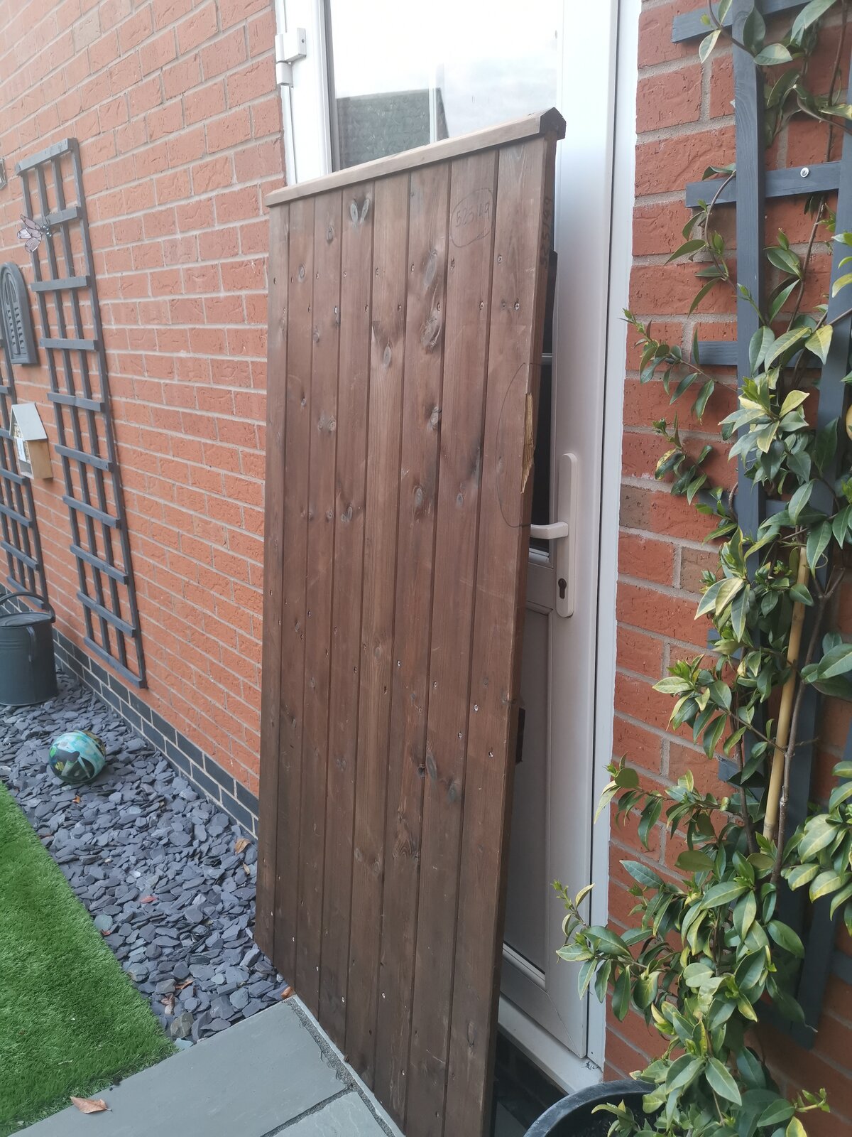

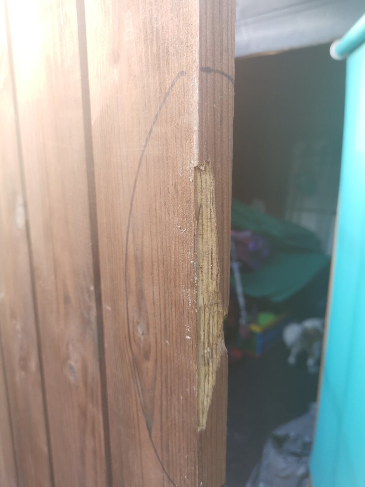

My partners parents were going to chop up and burn a damaged garden gate they were going to install before being given a replacement.
Am I right in thinking a bit of exterior wood filler, sand down and paint would fix it? Would the wood filler be ok in all weather's etc?
I've got some Toupret wood filler.
Then a coat of cuprinol.

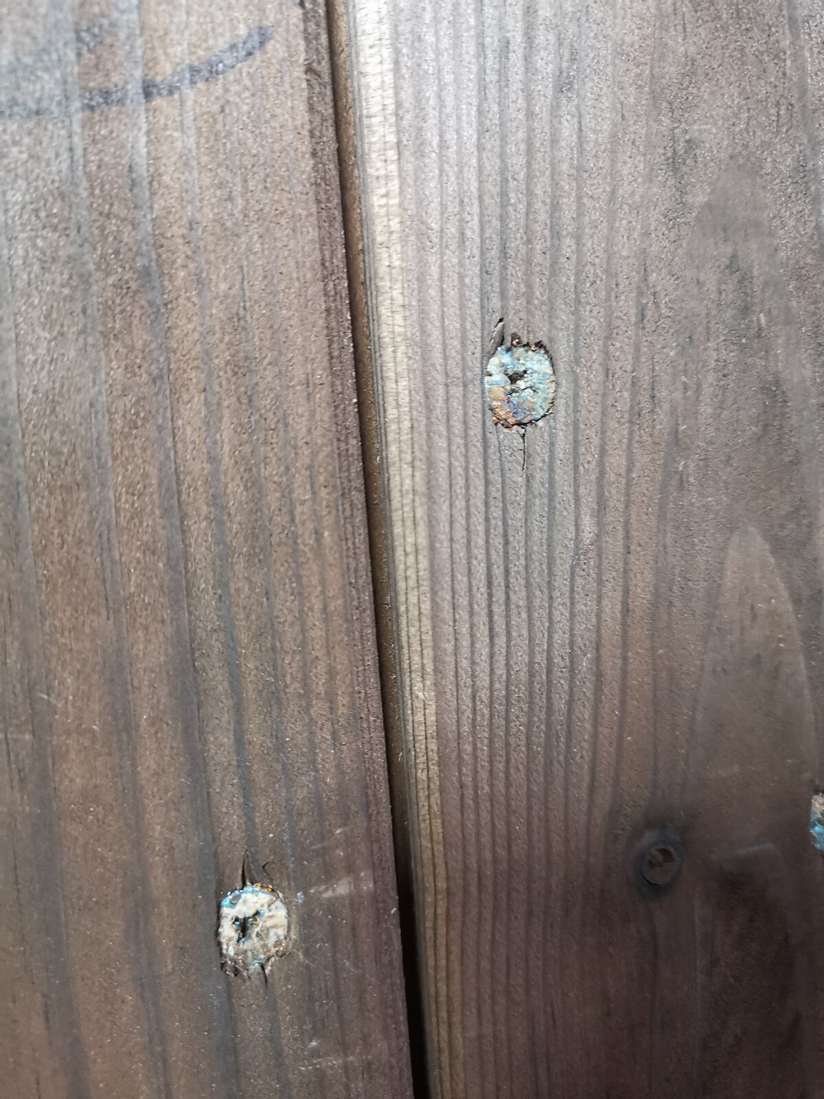

I don't think it's t&g might be wrong

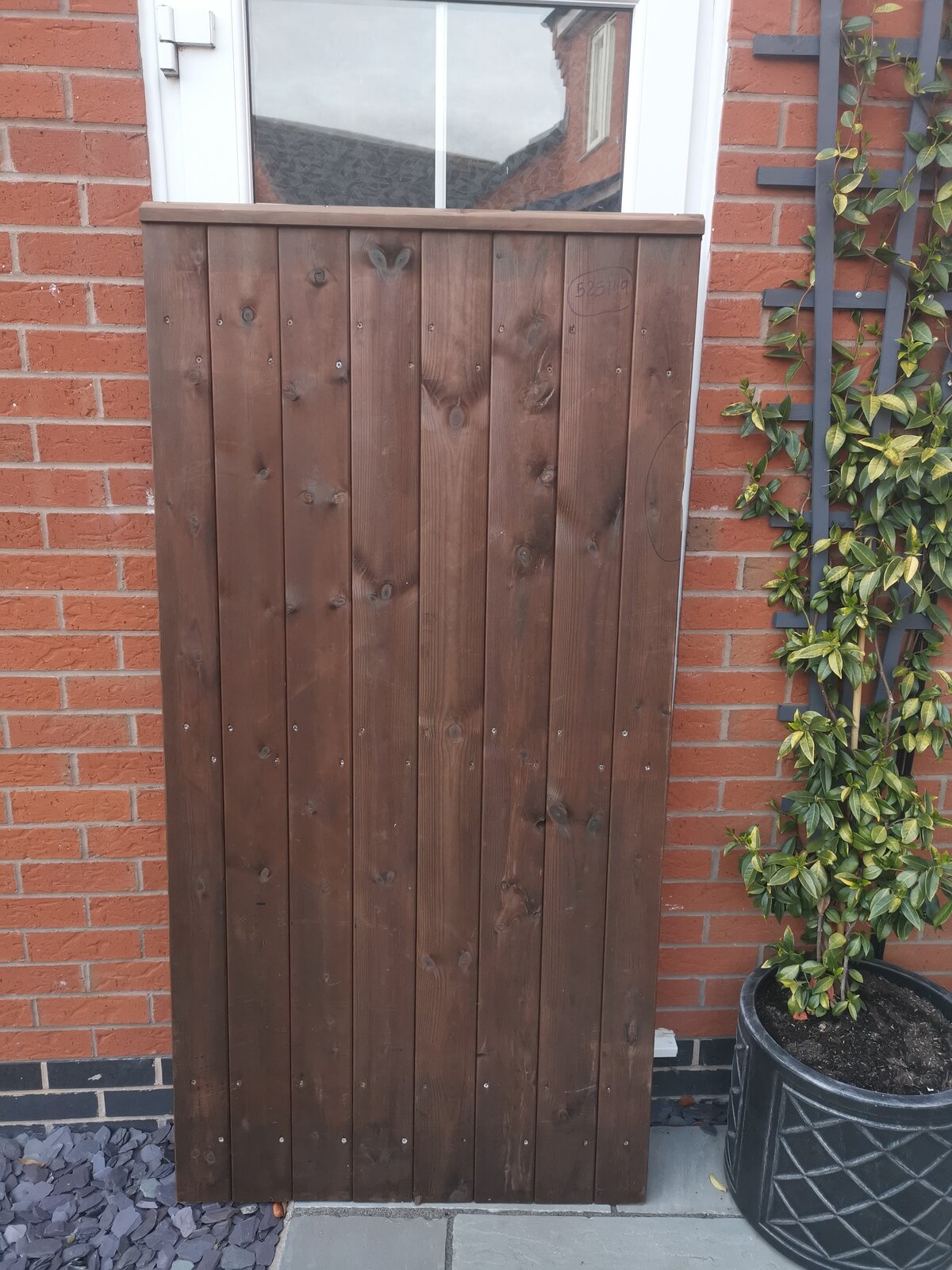

I did think about unscrewing the top and flipping it around as it'll be at the bottom left.
I think the gates been pre treated not sure what with
Maybe it is t&g?

Worth a try I suppose, but over time the wood will contract/expand and probably cracks will appear around the edges of the filler.
Would be better to glue in a wood sliver and either plane/sand down. When you Cuprinol the colour match will also be better than filler.
Far to good to bin.
Just plane off the damaged section , gates should not be a tight fit and will help avoid it sticking .
Filler will look sh1t and fall out
plane it down
if too narrow, screw a strip on
Mr Chibs' idea is sound but i'd go further and cut out the chipped piece and replace with new - glued and then varnished it should even out the edge.
