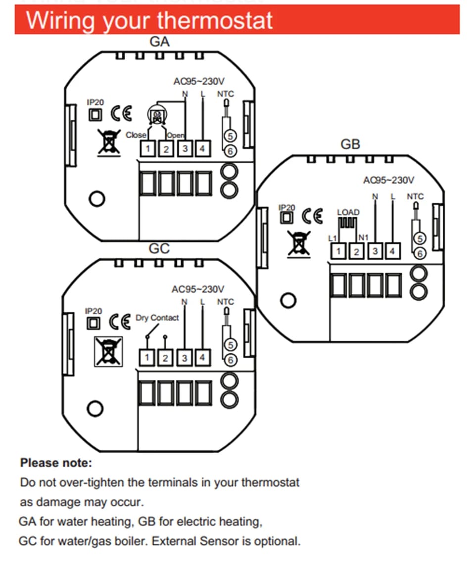

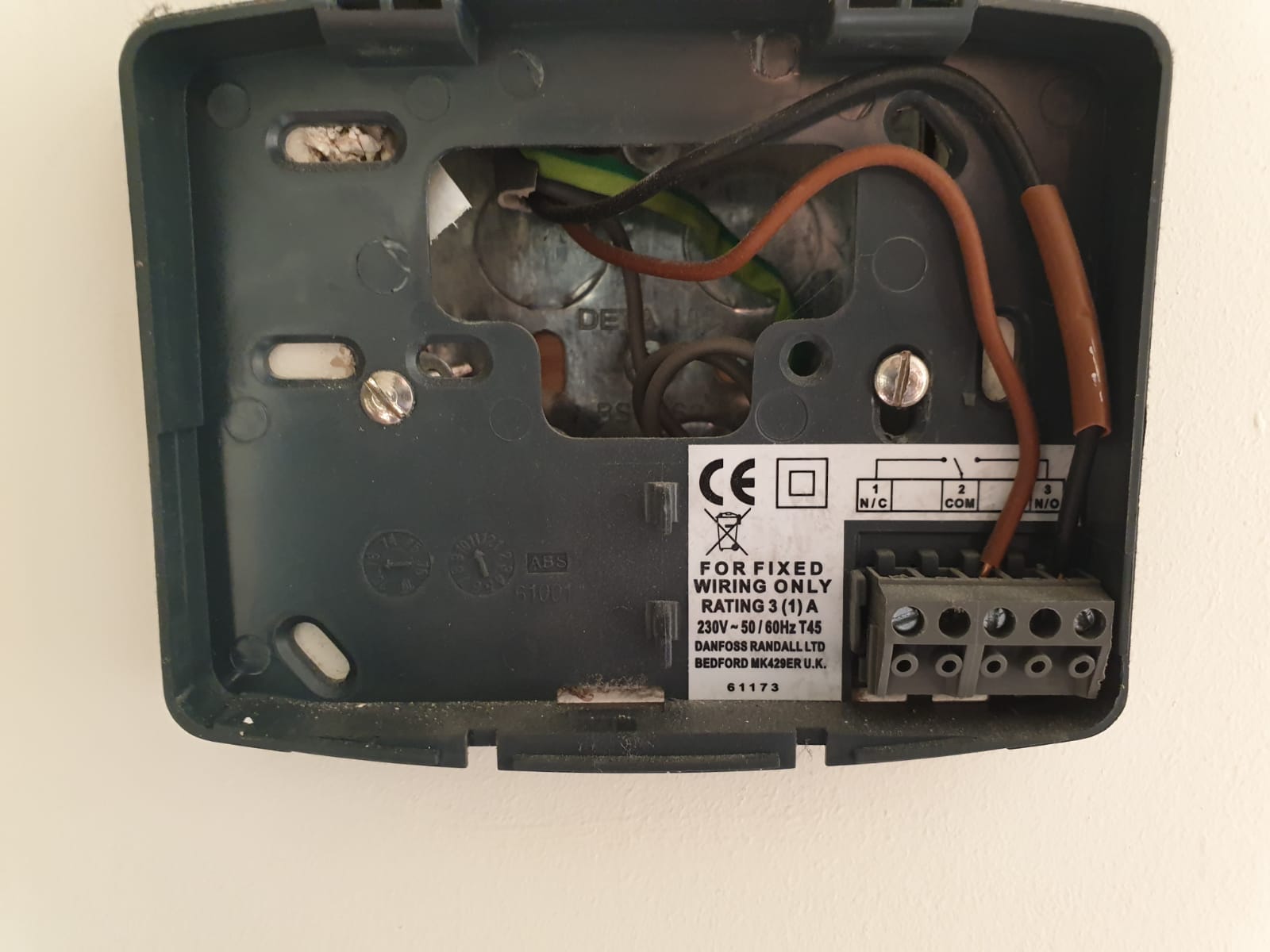

I'm planning on replacing my existing danfoss tp4/5000 with one of the numerous WiFi thermostats available from China. There are a few different designs but the contacts are more or less the same.
Just want to clarify the following will work. Attached is a picture of my current thermostat with is battery operated so no live terminals coming through. As well as the wiring diagram of the new one "GC" drawing.
Can I replace this existing > new with:
2- 1
3 - 2
And then power it up using live / neutral?

Yes, but where are you getting a permanent live and permanent neutral from? You mentioned no live terminals coming through but that brown wire could be 240vac live.
As above- just because there's a black wire there don't go thinking it's a neutral- it won't be, you'll need to run a new permanent supply from the wiring centre to the stat position.
Or more sensibly, put your wireless receiver at the wiring centre and disconnect the cable running to the existing star position (once you've worked out which pair it is in the wiring centre so you can connect to the dry contact).
I will be drawing a new wire into the housing to power it up. The existing one is battery controlled. I put a tester on both wires and none of them are live, or so it appears. I will try again later today and feedback. To me it looks like the thermostat is a simple switch that completes the circuit when it drops below a temperature. Or am I being too simple?

Testing between the 2 wires will probably give you the same potential. It states on the sticker 230vac switching, test between the live (brown) and an earth, or neutral point, you may find it’s 230vac. Yes it’s a switch the battery element will just power the unit and assist in the switching. Which boiler do you have?

Nope that is wrong, the two thermostat weres connect to 1&2 eitherway round, then :
N to 3
L to 4
N to 3
L to 4
I have an Ideal Combi ES35 boiler. Hmm some good points. I think you're right. That it is live switched. Which means there is already live there. First thing is first I need to establish if its live or not.
No that is the wrong wiring sequence you need GC in this pic and it is volt free (dry contacts because it is chinese )

So you were right I checked again and there are 236V when I connect up the two points using multi meter. Curiously though, I thought that would trigger the central heating on, but it didn't hmm
Could you please instruct the correct wiring sequence based on the above new info. I seem to have a live coming into common and the neutral going back NO.

Wiring diagram GC, do not wire it any other way , or will be very expensive
I was using GC version. The question is from my old thermostat which terminals correspond to the new "GC" terminals...
