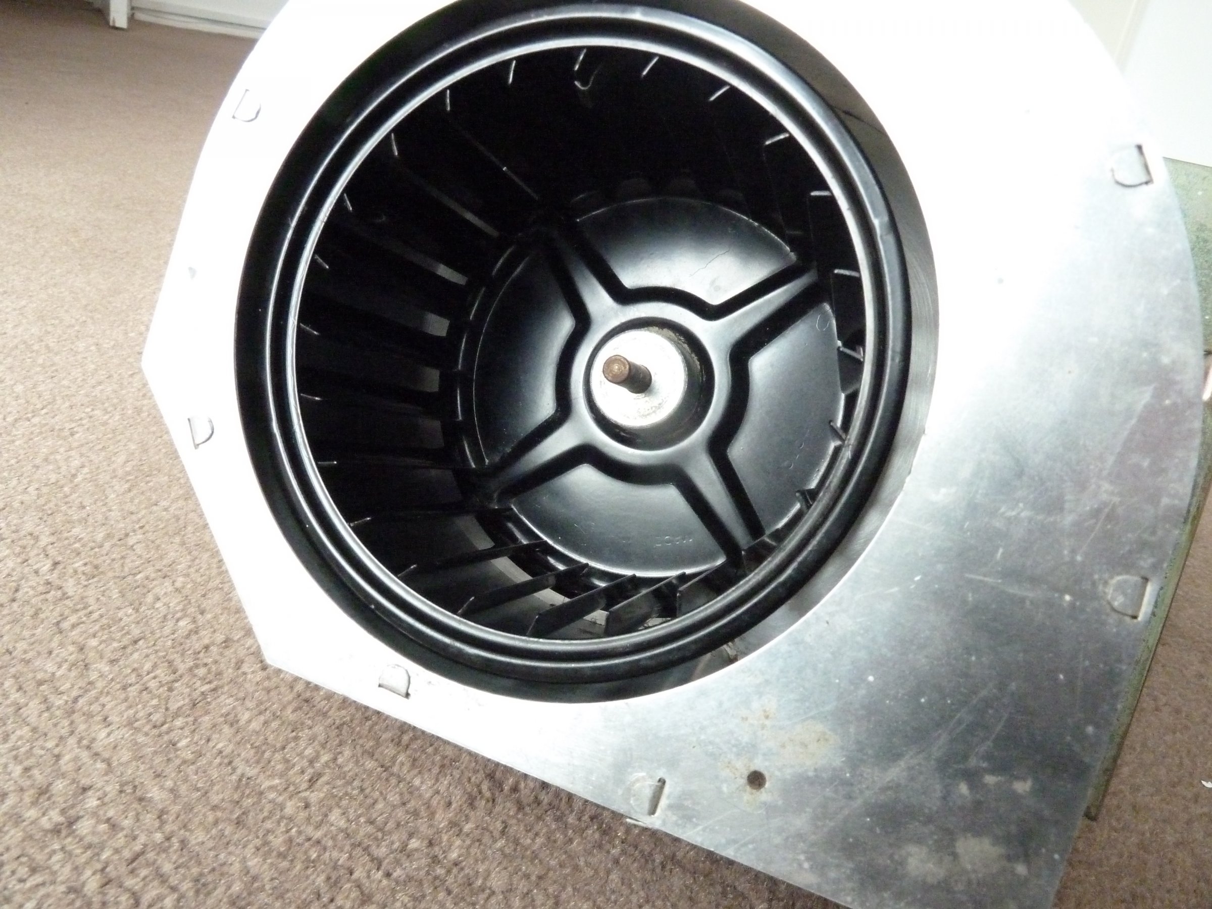

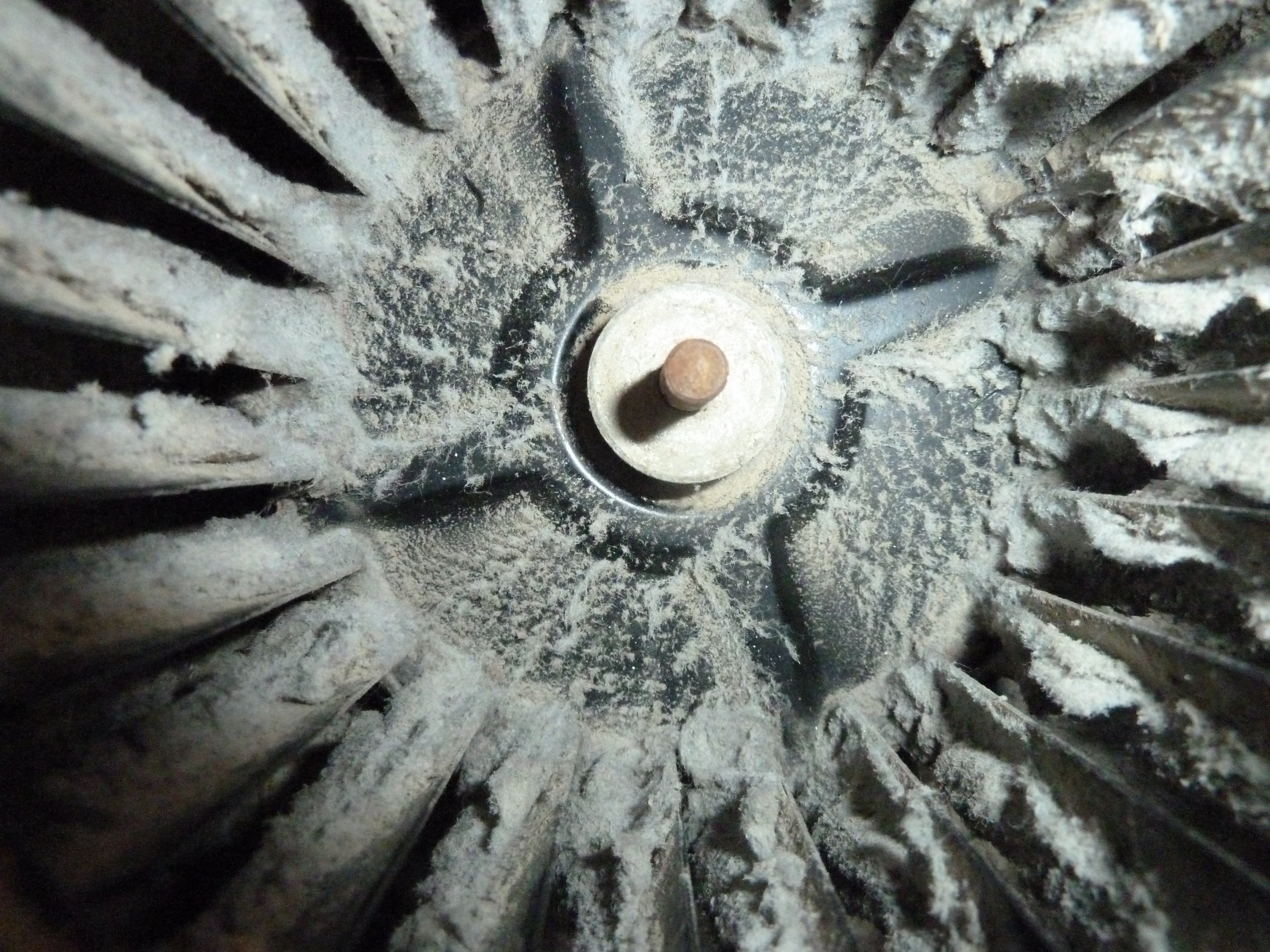

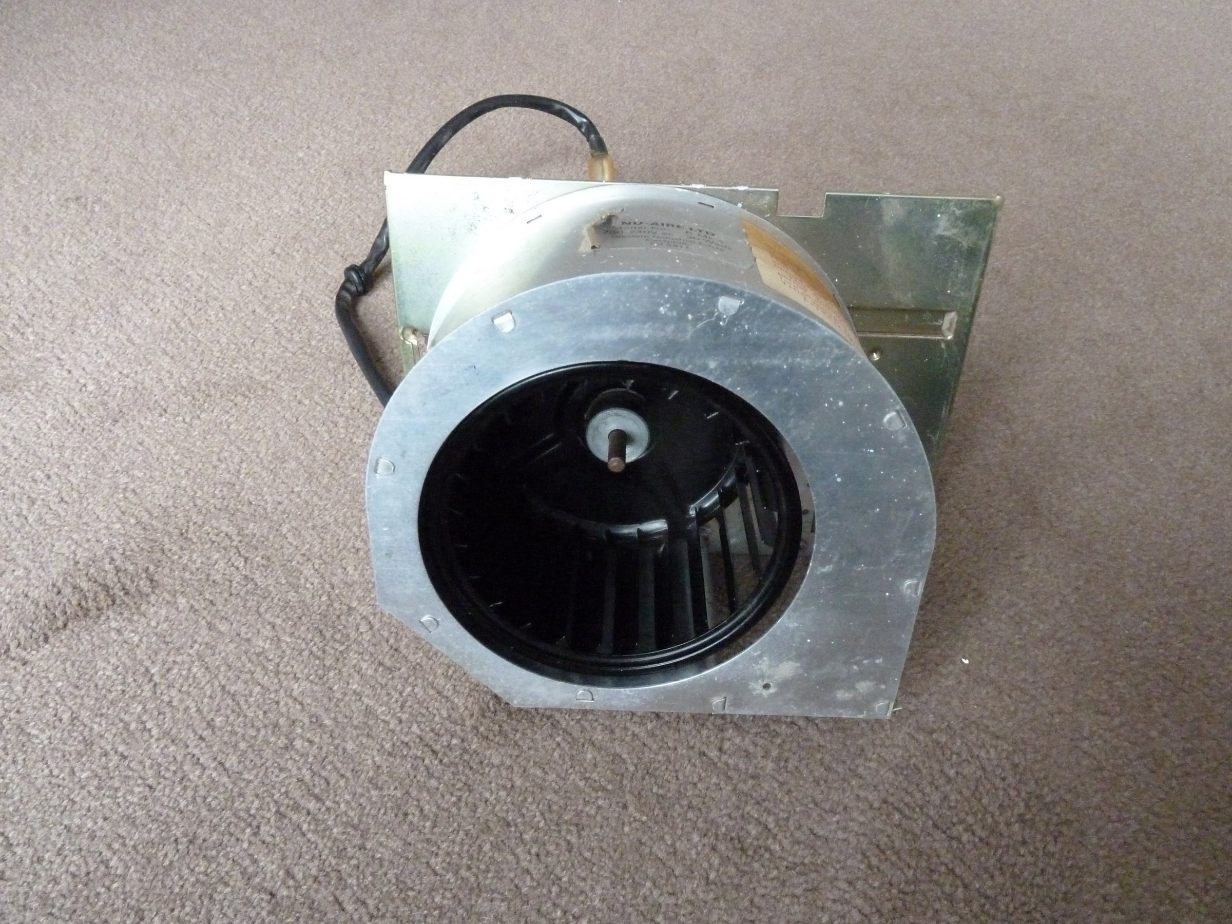

Opened the cover of an old extractor fan as I had a feeling it was full of dust and needed a clean out. I had a suspicion it may not be performing as it should as it has never been cleaned out in its life. Upon opening the unit, it was indeed full of dust.

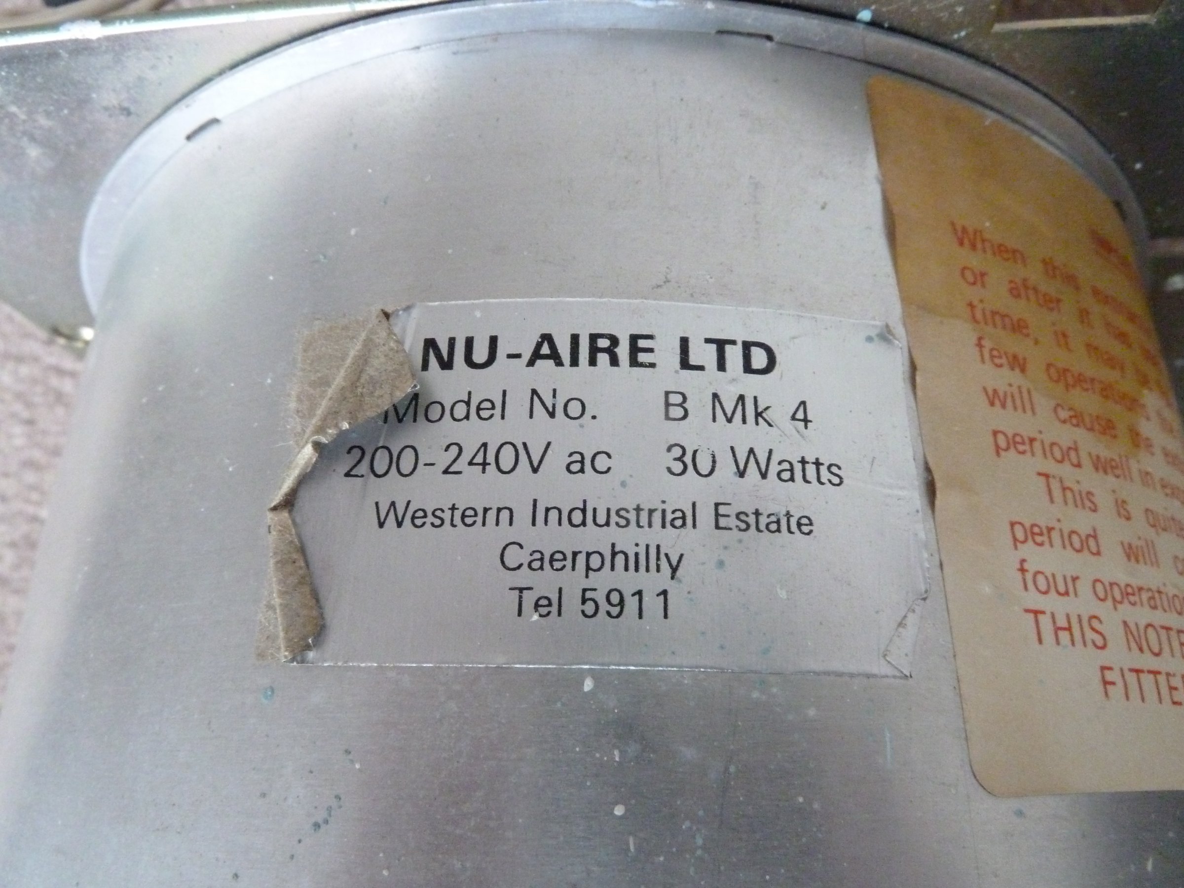

It is an old (circa 1970s) nuair centrifugal fan. It is very quiet and seems to perform OK, although I have no airflow figures for it.
According to my calculations the bathroom should use a fan that moves 77m3/hr. I have no idea if this fan achieves this.

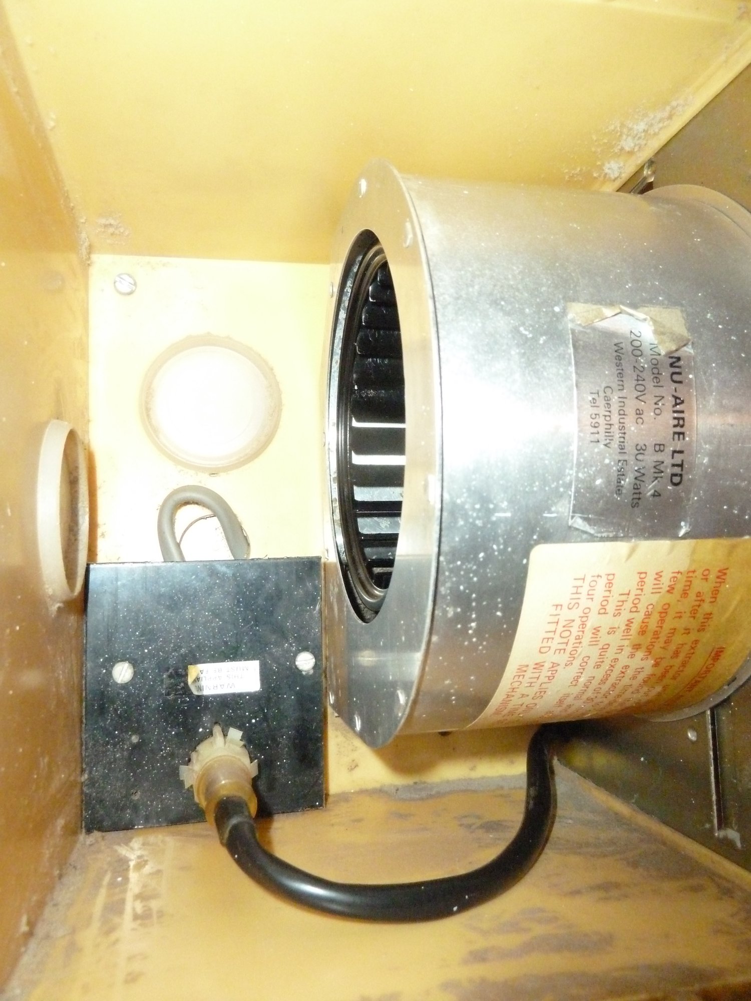

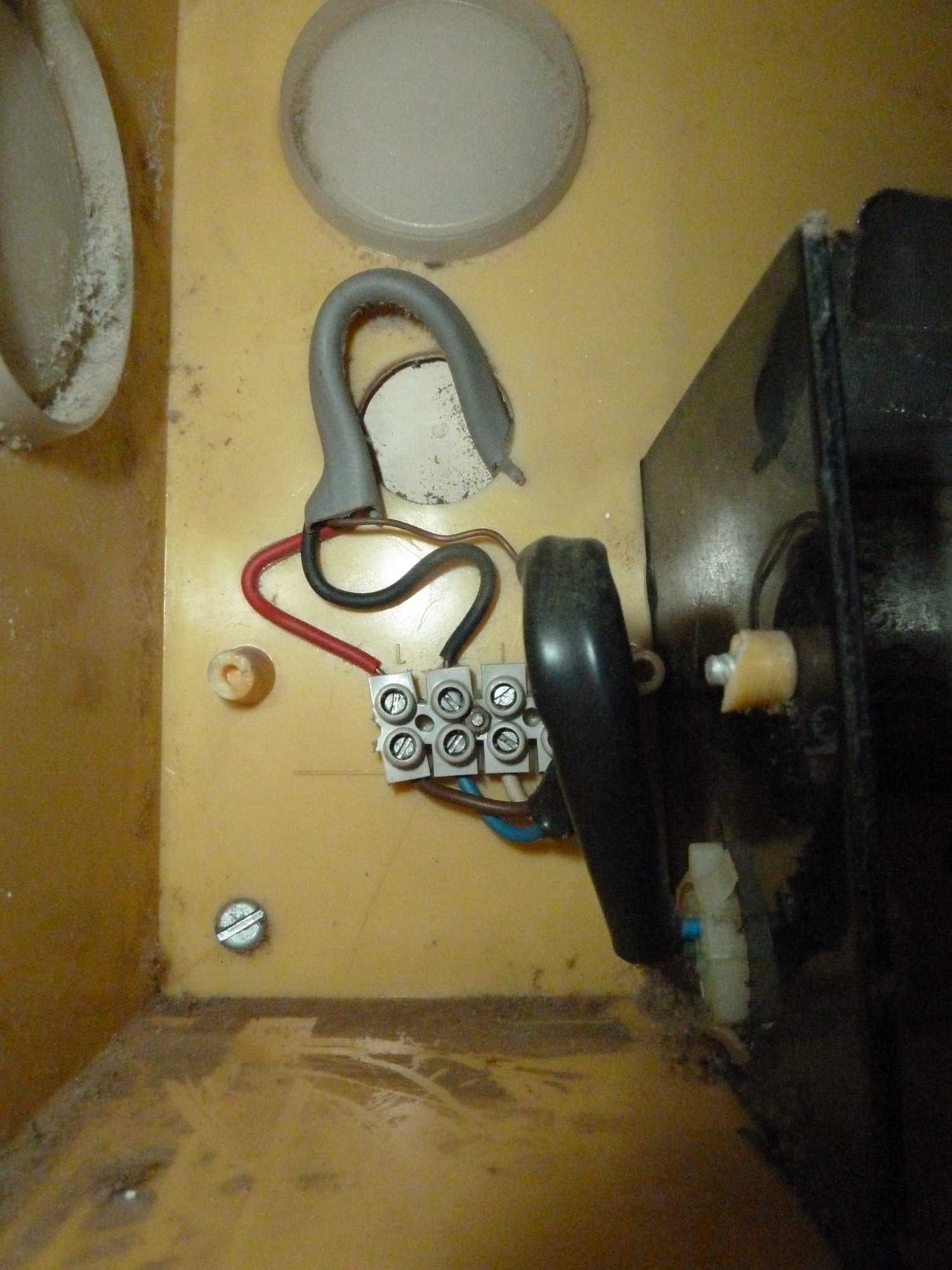

It is however powered by the light switch only, and whilst hoovering inside I could see it only had three connections, switched live (I assume), neutral, earth.
Does this mean, without a rewire, I cannot replace it with either a timed and/or humidistat model as I can see no permanent live?
The bathroom has no window so the fan is quite important. While the bathroom does not suffer from any mould, a timed and/or humidistat model may be an improvement in this situation.
In the mean time the clean out should have, at least, helped performance.

"rewire" is a bit of an exaggeration. Most likely it is fed from the lighting circuit, at the ceiling rose of the bathroom. If you can get access, for example in the loft or by lifting floorboards in the room above, it is a trifling job to change the cable.
True.....I meant, localised rewire...
It is a flat. So zero access to roof void.
Sounds like it should not be too bigger job then if access can be found.
If you are lucky there will be a suspended ceiling with a void above.
Depending on where the switch line comes from, it may be possible to move that, so the fan just has a permanent supply, then get a fan with built in controls, theres all sorts nowadays, pir motion sensors, etc, even ones you set using an App on your phone

If so, circular conduit MAY have been used which will make drawing an extra core in a doddle.
Photos please if you can.

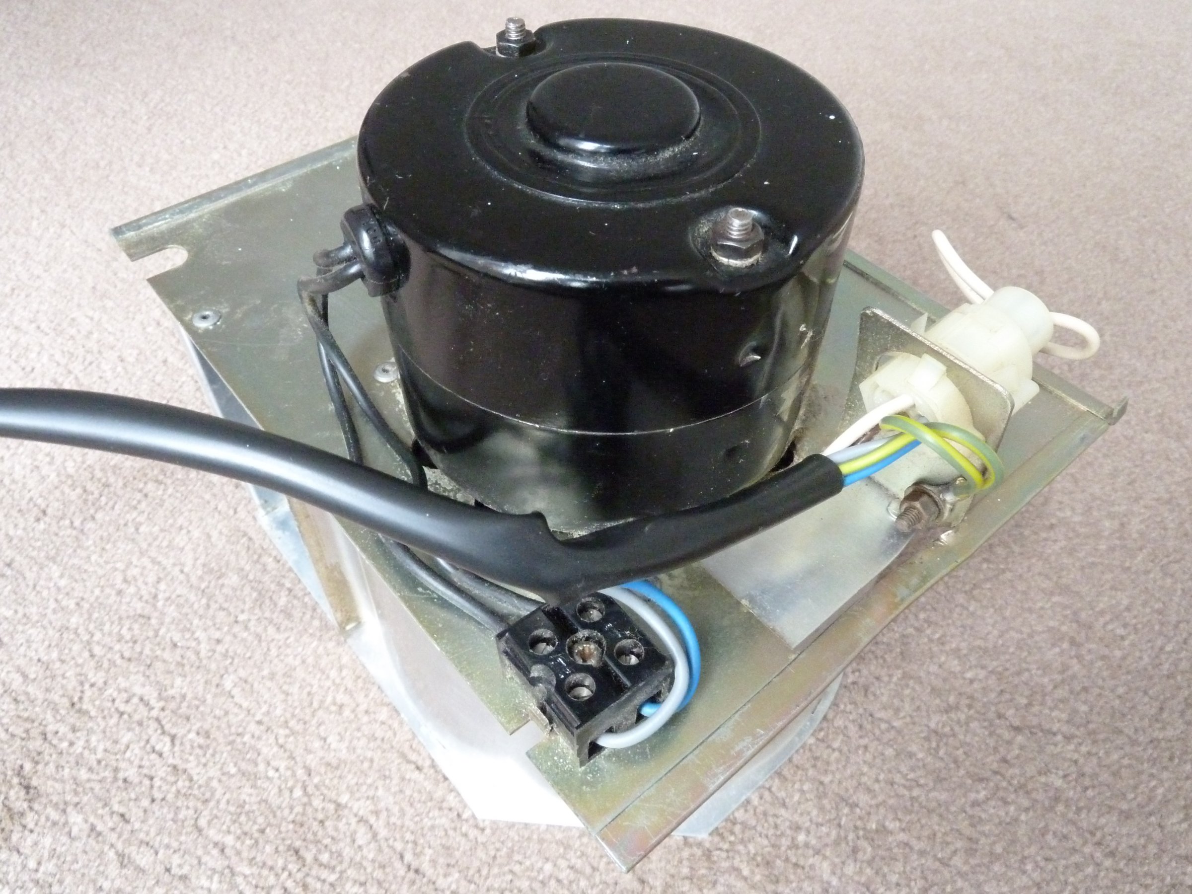

Yes it was a purpose build 1970s low rise block. As far as I can see it is standard three core of the period. But here are a few photos for you to double check.
The fan and housing were full of dust. The fan was worse that that initial picture. That was already after it had been hoovered. It was so full of dust I thought the fan was white initially.
Cleaned the fan and popped it back in. It runs as good as new and probably shifts a lot more air now. I wonder if I can work out a rough m3/hr based roughly on the fan size.
Most of which was dead skin.
